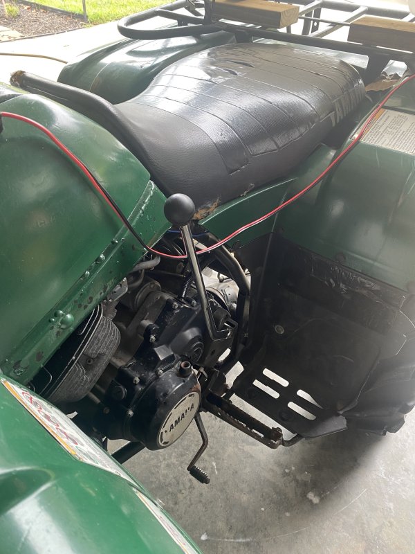

so, i bought this cheap hand shifter from amazon and it actually works much better than the foot shifter. I'll upgrade it to a much better one in the near future.
(the wires you see are for my 15 gallon sprayer mounted on the back)
don't pay attention to my seat...lol..atv is used as a work horse only....not going in the auto show

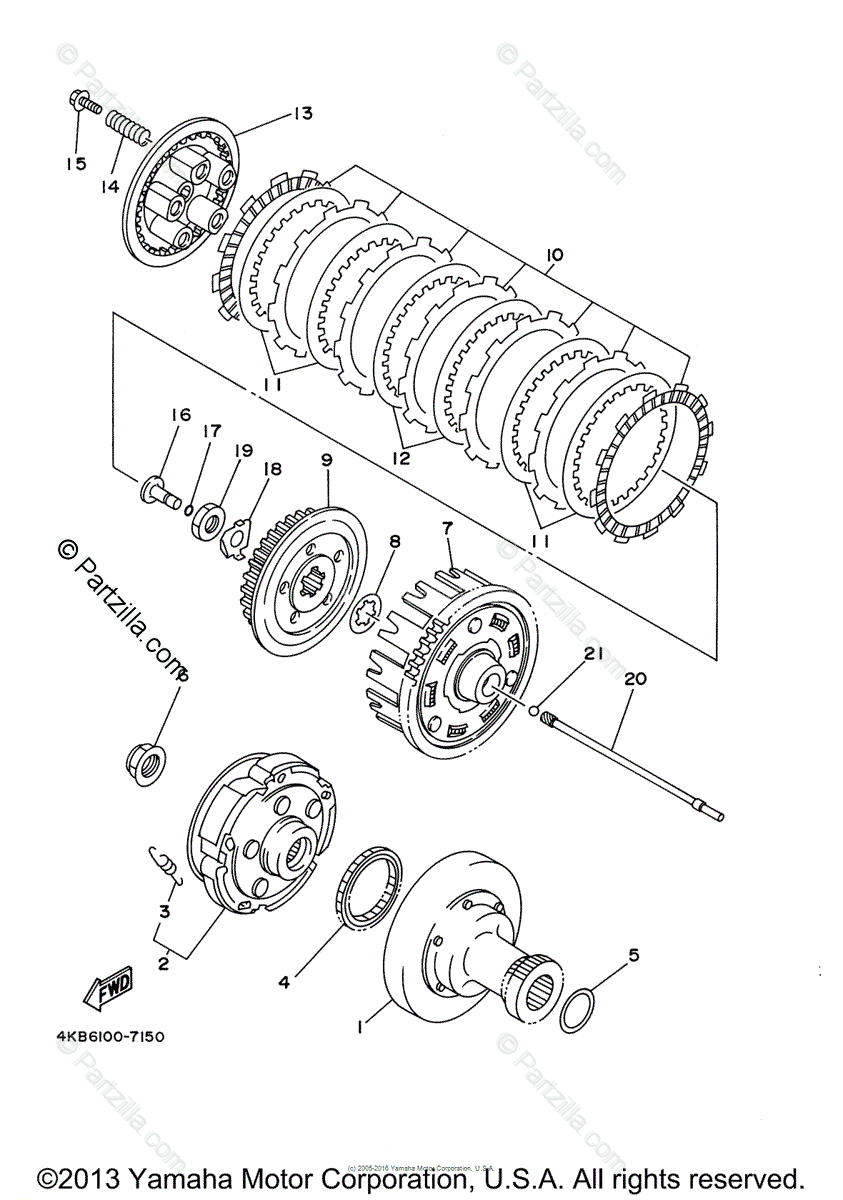

You just need to loosen the clutch adjusting nut enough that it's not locking the bolt(about a half a turn), then hold it while you turn the screw/bolt, then lock the bolt/screw up again without letting the bolt/screw turn.
When the clutch wears the free play reduces and so you are backing the adjuster a small distance away from the pushrod(20) in the diagram.
Parts 19 and 21 in the second photo push the pushrod.

I like the hand shifter idea, but how does it attach, the foot shifter is still there.
it simply attaches to the shift shaft same as the foot linkage. I left the foot linkage just in case i didn't like it. but, i'll remove it.
with the hand shifter it takes little effort, however, i could see a problem if you're into fast rough terrain riding and you need to shift gears and hold on.
Or the weight of the lever tried to shift gears for you on rough ground.

i gotta say, that side hand shifter is great...man, i love that thing, it shifts so much better now. I think the problem was the foot shifter linkage was just worn too much and had too much play in it.
