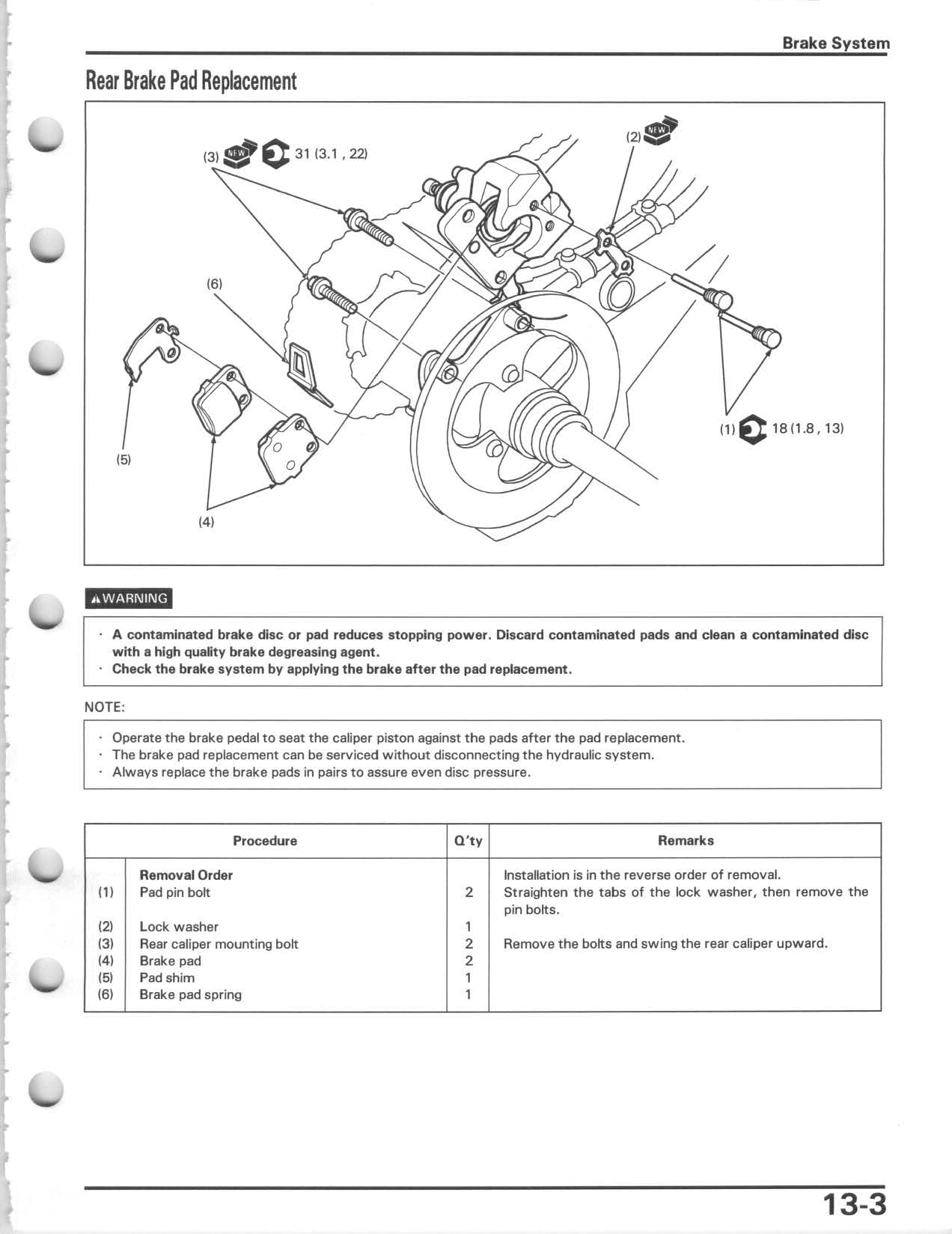

I seem to have no resistance at all on the rear brake pedal and no rear brakes. They were pretty good before I removed the right side crank cover. In order to get to the lower bolts of the cover, I took a piece of baling wire and wired the pedal in the down position. I assume, that caused at least, part of the brake problem. I can't see where fluid came out but, I did have to add more fluid. Added the fluid but still no resistance to pedal. Should I try to bleed the rear brakes? Thanks

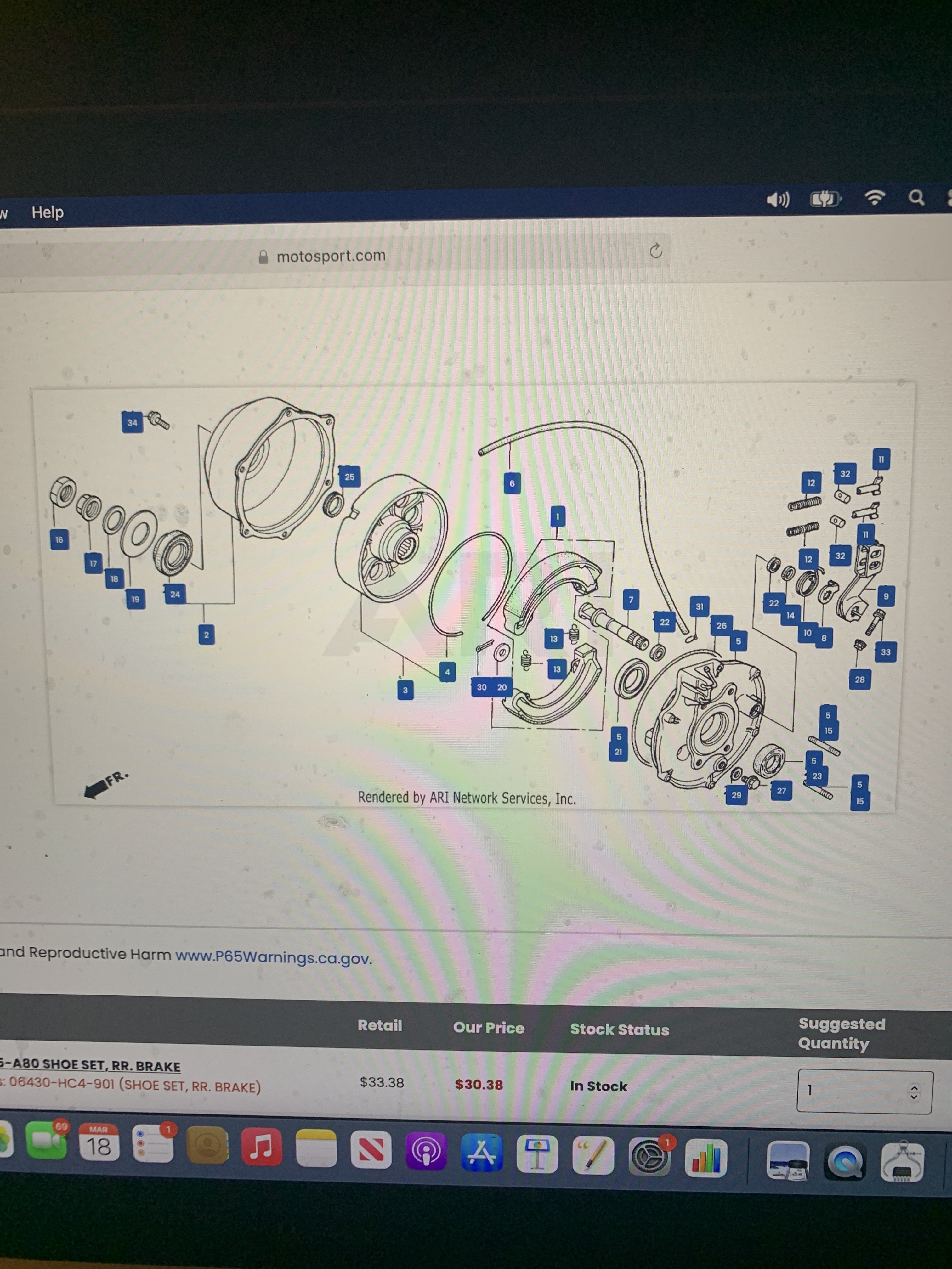

I thought the rear brakes were spring actuated with a rod going to the hub arm from petal , no master cylinder for rear, unless im understanding wrong, only mater cylinder for the front, this is for your 2000 300 right. There are wing nuts on the end of the rod from the petal to adjust brake tension  and cable going from the hand lever to rear brake.
This is the trx300ex and it does, have disc brakes on rear also. I was kind of surprised myself when I found out it had disc on front and back for it's price range. I'm going to wait for a warmer day and try, bleeding the brakes. I guess it would be easier to get someone else to help. Thanks guys! 👍

I tried that and nothing came out the bleeder nipple and the reservoir so, I assume the mastercylinder is not pumping the fluid.
reservoir stayed full
Look like you may have found the culprit
The master cylinder might bleed if you either take the hose off it and use your finger over the hole as a one way valve, or loosen the bleed nipple on the caliper and use your finger as a one way valve back there. Then put the hose back on and try bleeding it at the back wheel. It's also possible the piston s stuck down in the cylinder, in which case a bit of sharp tapping on the lever might free it, or you could blow air back up into it.
To bleed the caliper I would also put my finger over the nipple as a one way valve until the fluid got to the nipple.
