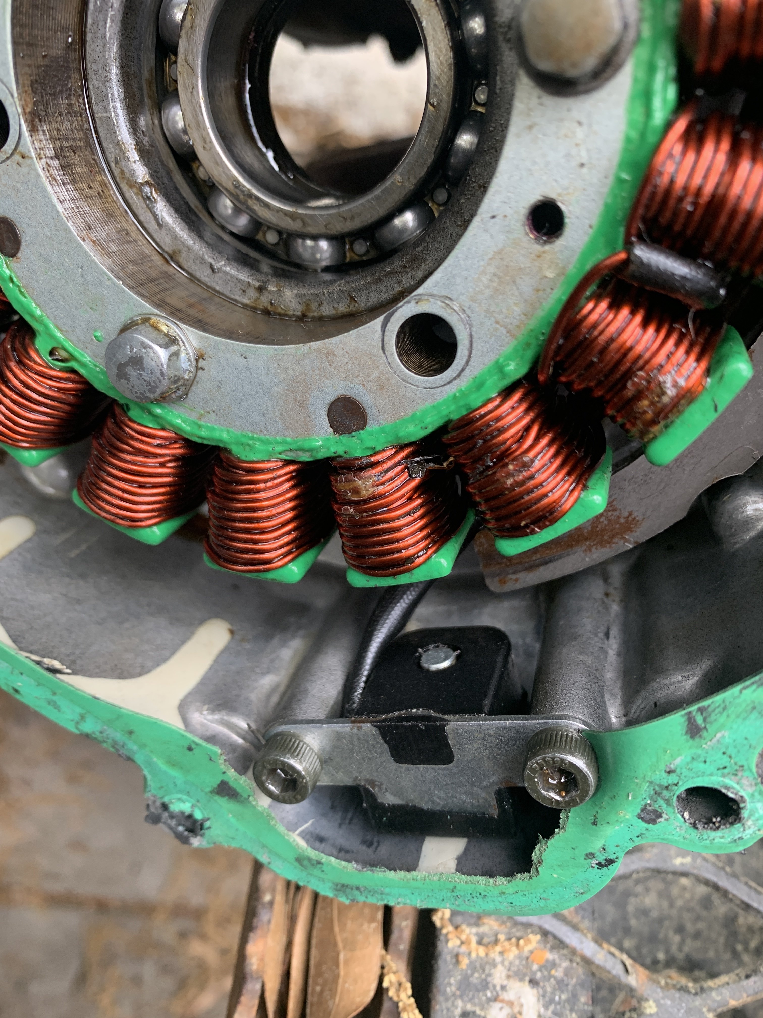

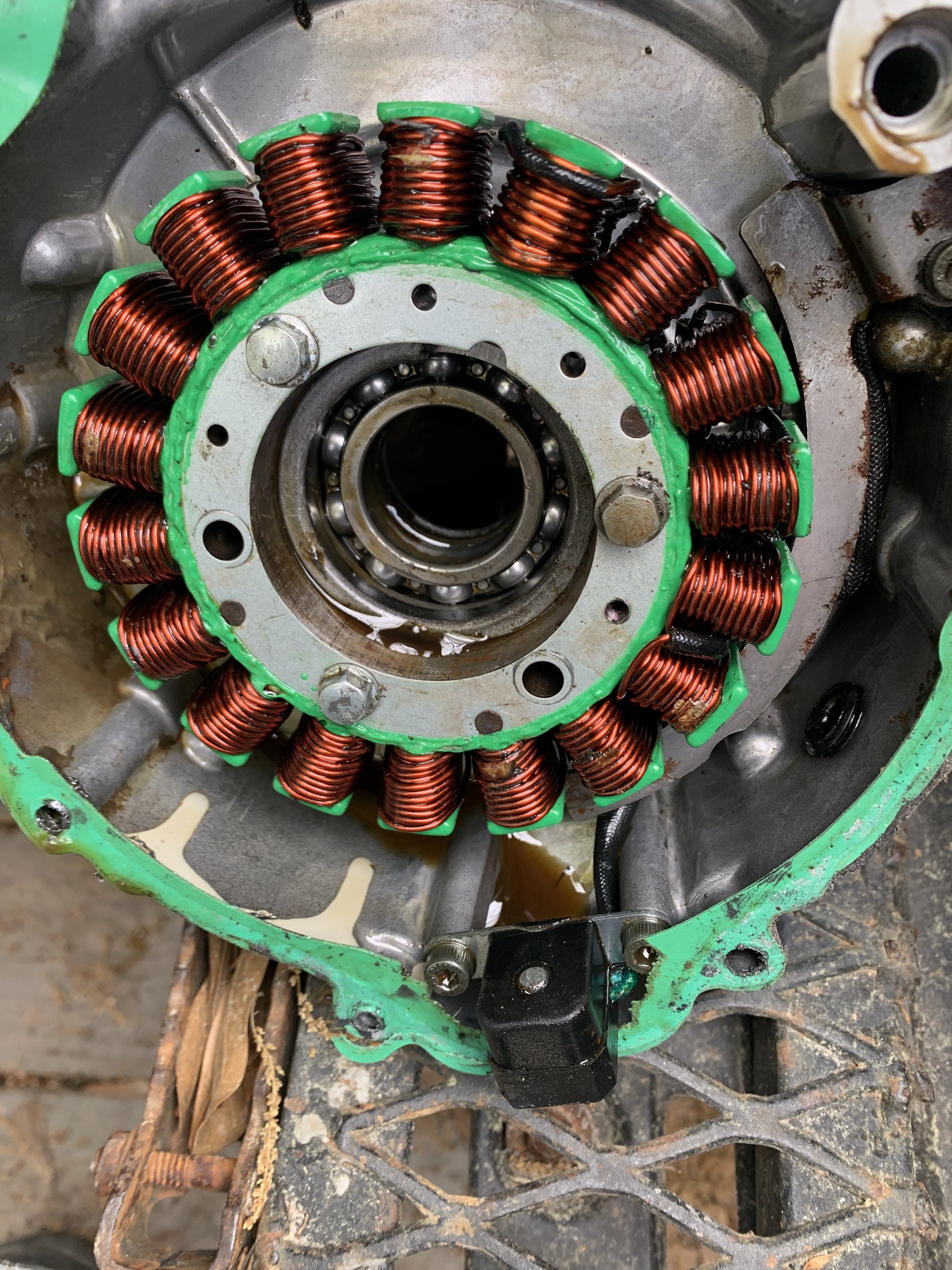

I took off the stator cover and found very very slight surface rust on the end of the steel strip on the flywheel. It looks like someone has replaced the stator before but the pickup coil appears to be in the right position the metal part points straight towards the stator. Is there some sort of alignment that has to be done when you change the stator and or pickup coil? the pickup coil is also magnetic and so are the magnets on the inner part of the flywheel.

I would go over the steel strip with 600 to 1000 grit sandpaper just to get crud off with maybe WD40 or some sort of contact cleaner, I would do the same with the little metal button on the pickup coil, just to get them clean and polished. Even though the metal button on mine was pointed toward the stator it was upside down sticking above the side cover, that's probably not you problem because you are getting some spark, I was getting nothing, but I would clean the 2 metal pieces and any rust you see while you are in there.
