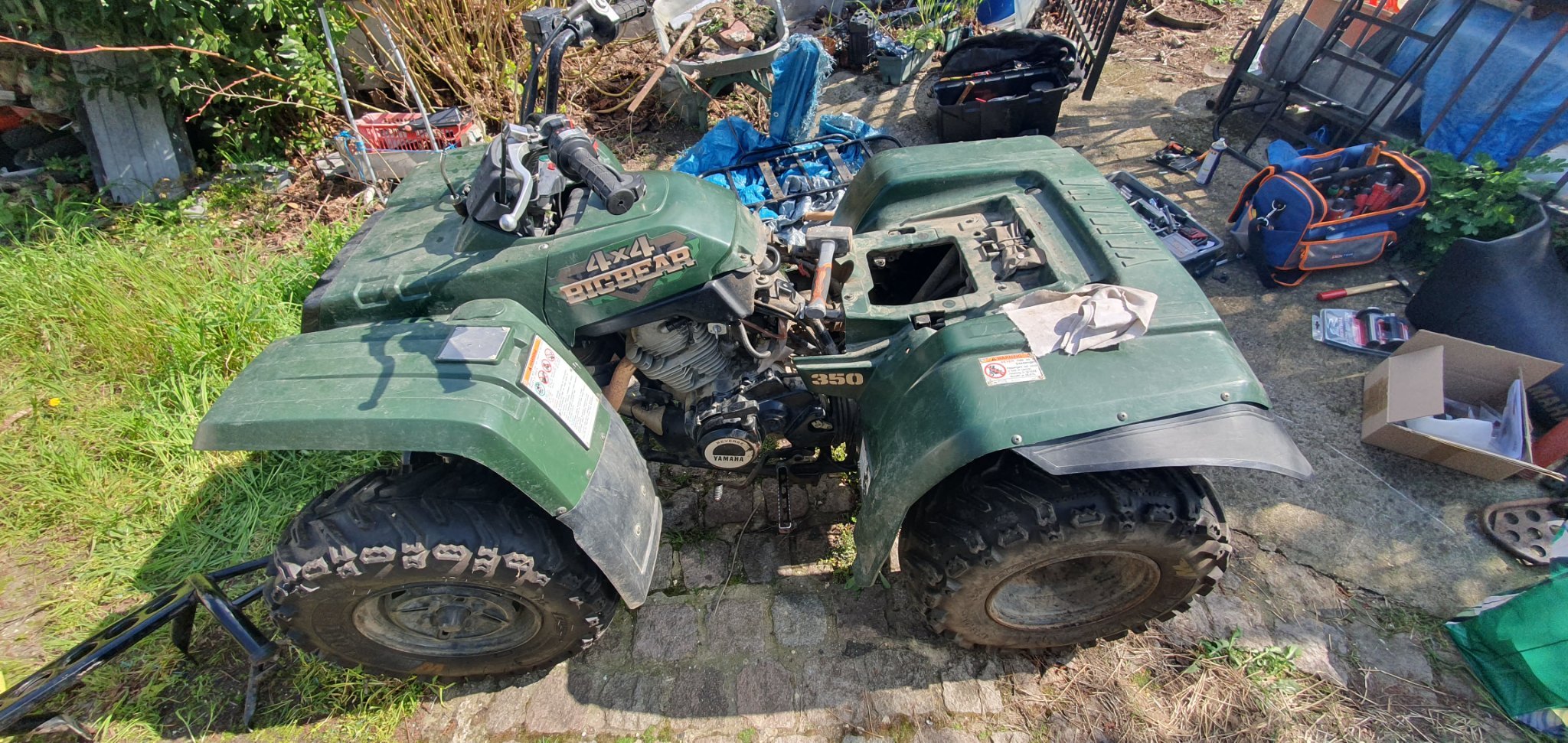

it's seem a good ATV, but a few parts are expensive and became difficult to find it.
Now i need to find the repairs manual for check all parts.

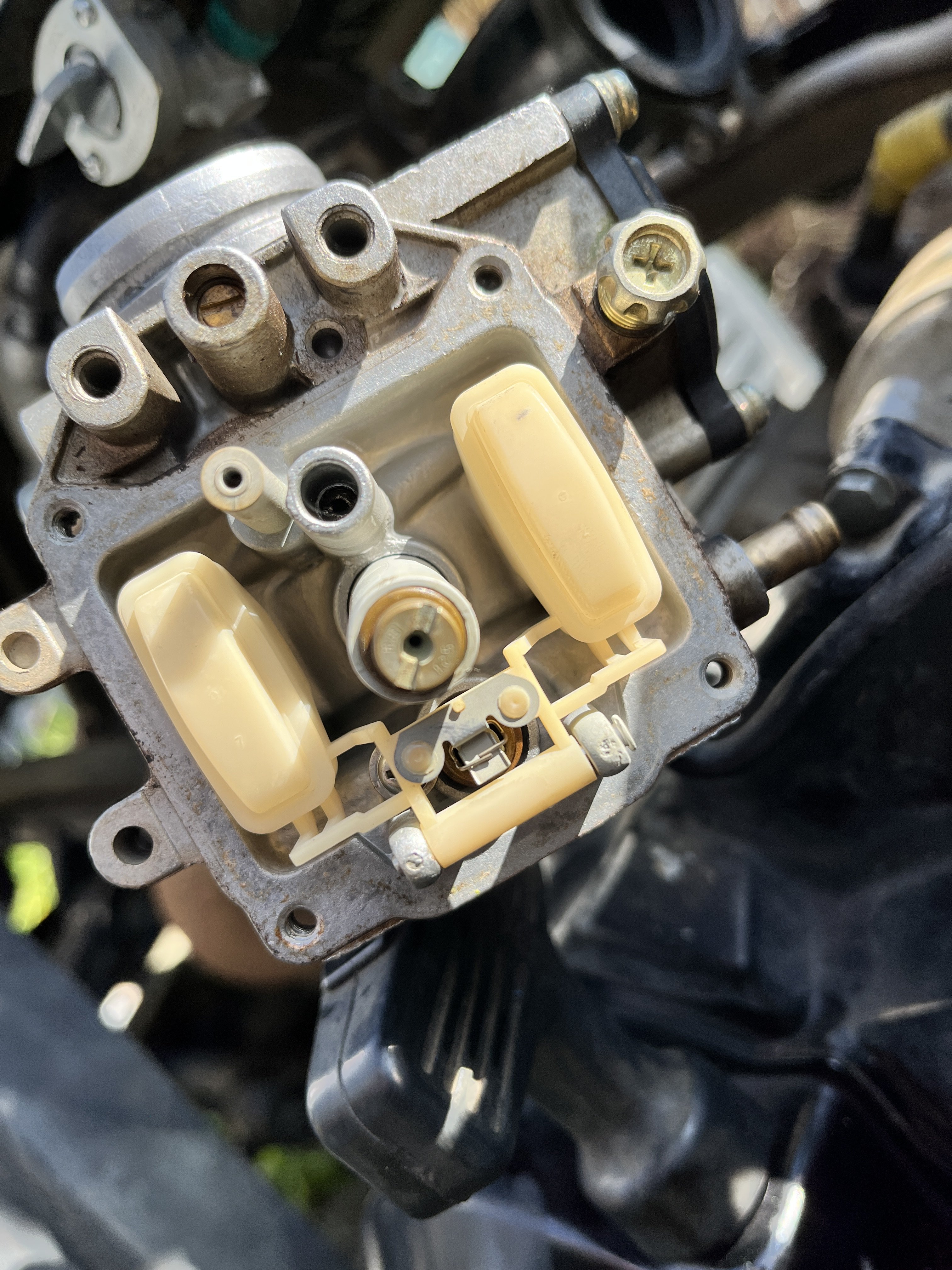

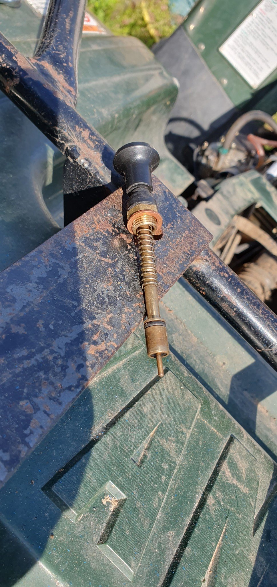

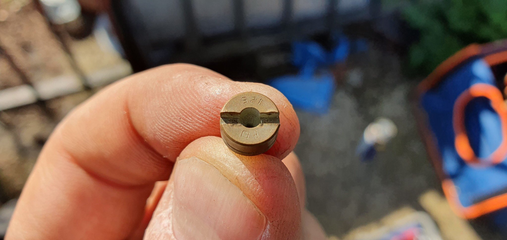

first cleaning carburetor and change the nozzle too big 130
That a new challenge for me, and if it the better i will sold my kymco MXU and keep the big bear for hunting and farm work.image00000016.thumb.JPG.baea0ff4ff72585d75fbca9eef14ceed.JPGIMG_2904.thumb.JPG.3e60e4b578acf0cf426dcbf5591115fe.JPG

Yes,I like to see the old bikes restored and hear them rev back to life. Atv where you can't go by truck you can with those little buggers. Like to see pictures when restoration complete.
Indeed it seems in good condition, but already some surprises in the dismantling. Welding to be done on the luggage doors and clutch adjustment
and the carburetor was too rich. but nothing insurmountable for the moment :-)
