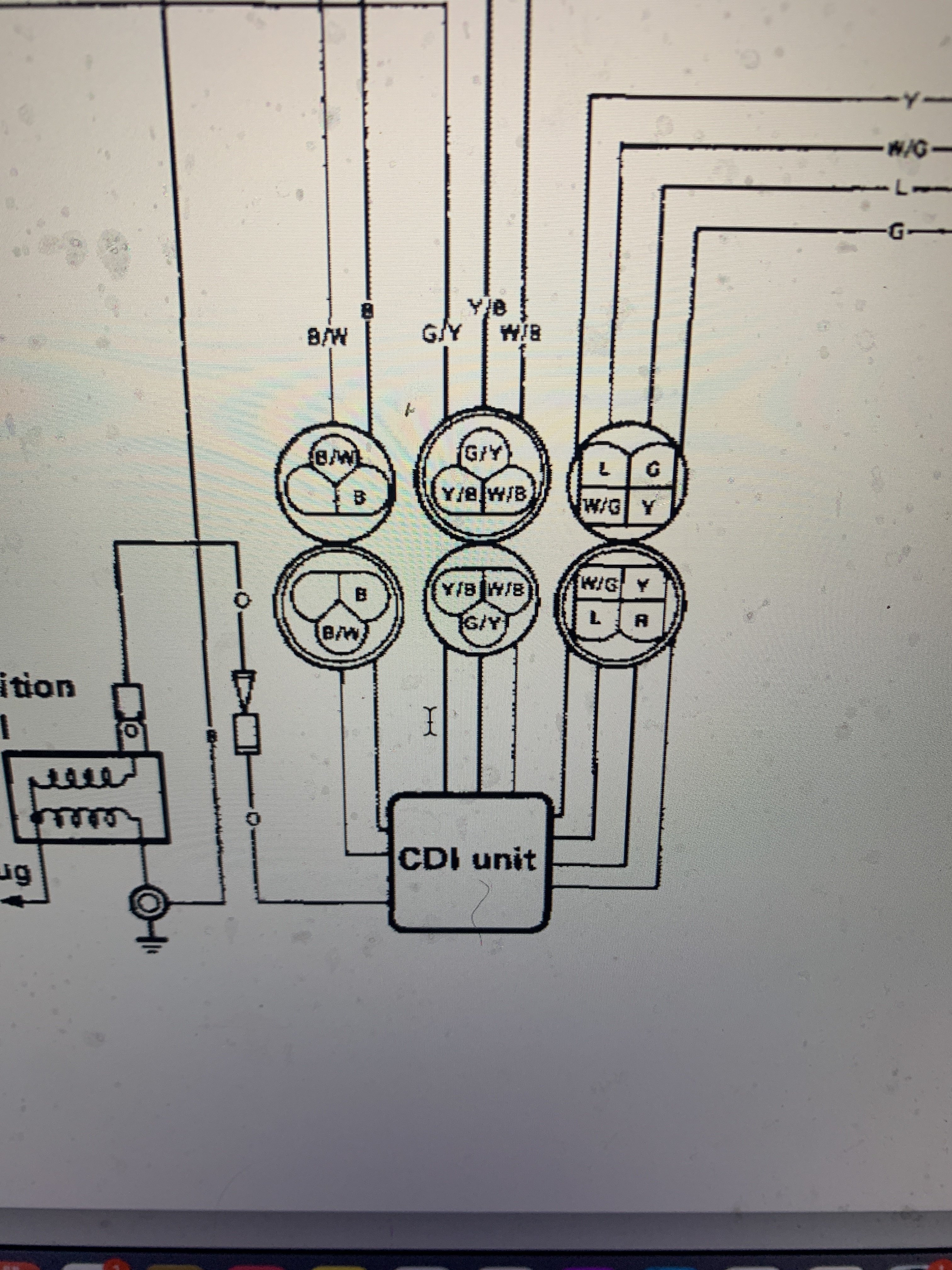

So, if you go back to one of my early posts you will see I asked some questions about the key switch, the and how the starter circuit is connected to the cdi unit.. If you answer those questions either Gw or I will be able to find you a diagram that will work, and have the correct specs.
So far though, it does sound like the coil is open circuit. You should use two pins a little way down the wires from the plug and check the wires are't just broken near the terminals.. No point pulling the cover if it's not needed.

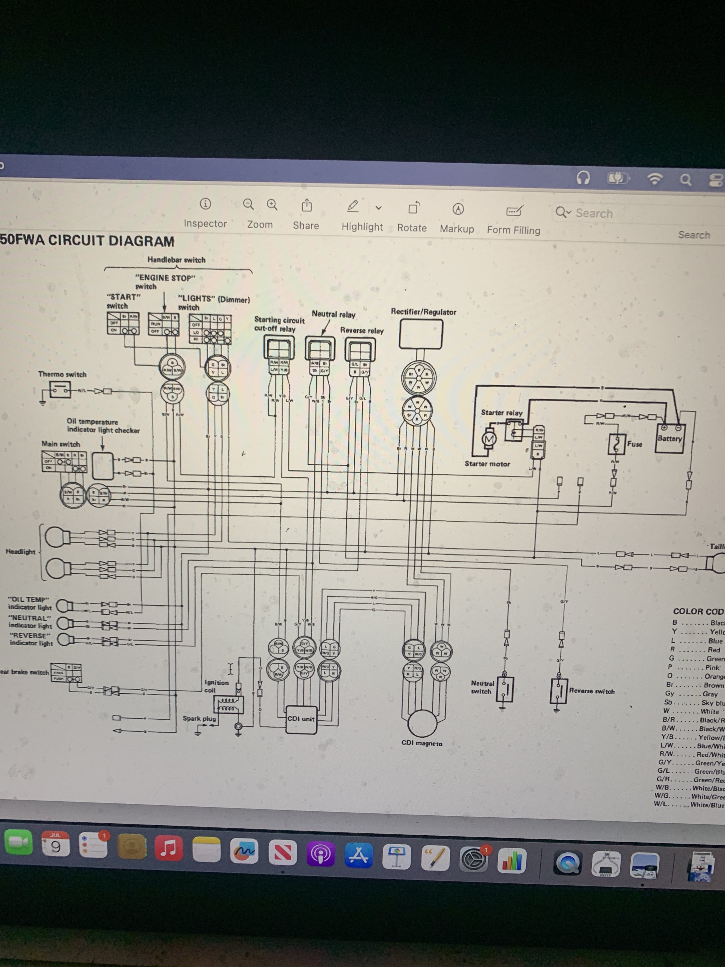

I did find another repair manual but it wasn't for the 350UB, and looking at the wiring diagram the plugs were not the same as your. 99 must be a strange one, maybe an odd year before the 400. I did find an owners manual for the UB I think it was maybe UBW looked through it and no wiring diagram.
May just have to old school this one, check all your coil resistances to make sure they are in spec, check that you have continuity on all your wire, make sure you have 12 volts to CDI and good ground at CDI, check to make sure all the stator coils for ignition are putting out voltage. Check start stop and key switch for correct operation. Make sure you have 12 v and continuity to ignition coil. I know all this has been talked about already I was just going through my check list when I don't have spark. Im sure you have already checked most of these things.
So when all of these things are in spec, then it's time to replace the CDI, but before I did that I would pull the side cover and make sure pulser coil is in the right position and not loose, with no problems there no trash or metal flakes obstructing it, that's a test you can only run with your eyes.
Yeah I looked too Gw and found the same owners manual.. no diagram.
As for it being an odd one for the year, I'd suspect it's because it's for some other market.
Some countries enter into trade deals where they get to contribute some local content to the build. It's quite often electrical or electronic components. Apart from a trade deal, some markets just get different spec bikes than america gets.. Here in NZ we get machines spec'd for america, asia, japan, australia, europe, GB, africa... oh.. and New Zealand.
If we identify the specs and systems the bike is using though, then we can identify parts and tests to fix them..
