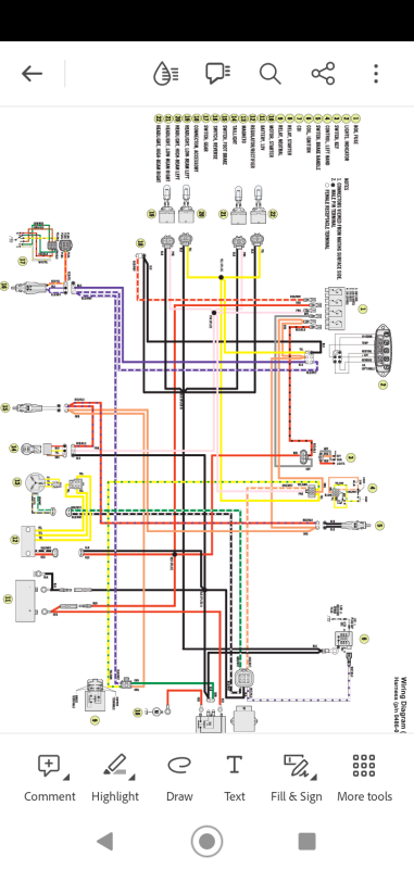

My 2005 Artic Cat ATV (250, 2x4) started up and I started to move when it abruptly stalled and died. Now when I turn the key, nothing at all happens. The "N" indicator doesn't light up, the motor doesn't crank, nothing. Any clues as to what might be the problem?
Blown a fuse.. Get a wiring diagram and start checking the power from the battery onwards using a test light. Check the earth cable too..
A test light is better to use for that purpose than a digital meter which won't detect bad/dirty connections.
Check the battery has power and an earth and then start tracing.. I'd jump to the main switch first off after checking the fuses since there's no lights or neutral or anything.  If there's power there then onwards, other wise go back towards the battery.
And check the main switch is working...  Test before(on the power side), and after making sure it does switch on.
I have seen this problem before and it ended up being the switch itself burnt out.  Do what mech said and test all then test switch itself to see if you are getting power to it if so then look at switch for problem. Hope this helps
Hi, please forgive my ignorance but when you mention the switch, are we talking about the ignition switch with the key? Thank you.
