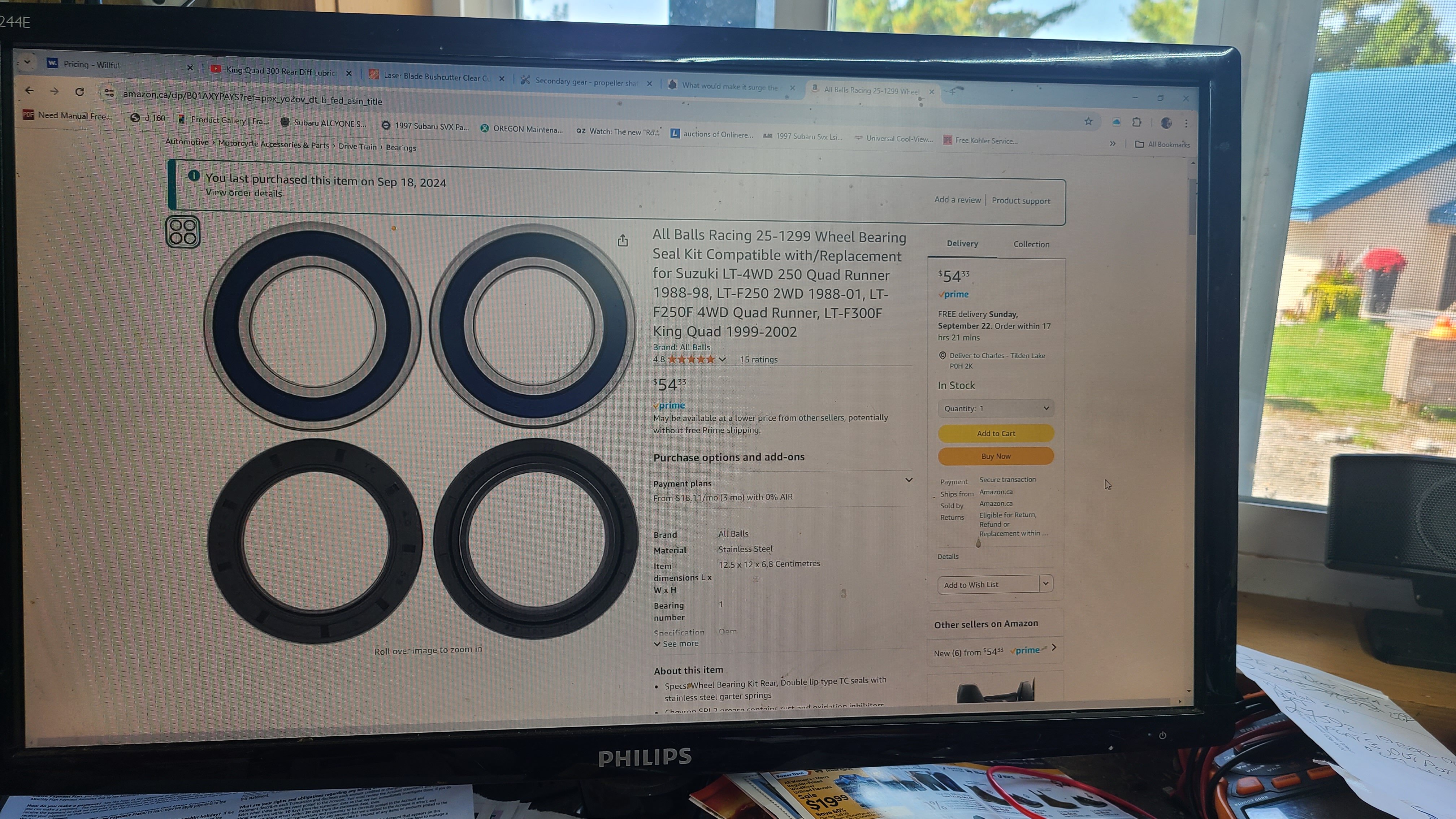

So... on that note .. I ordered ( what I hope ) is the right seal and bearing kit for the left rear axle. I'm pretty sure that that was the root cause of the whoop whoop.. As the wheel had at least a couple inches of play.

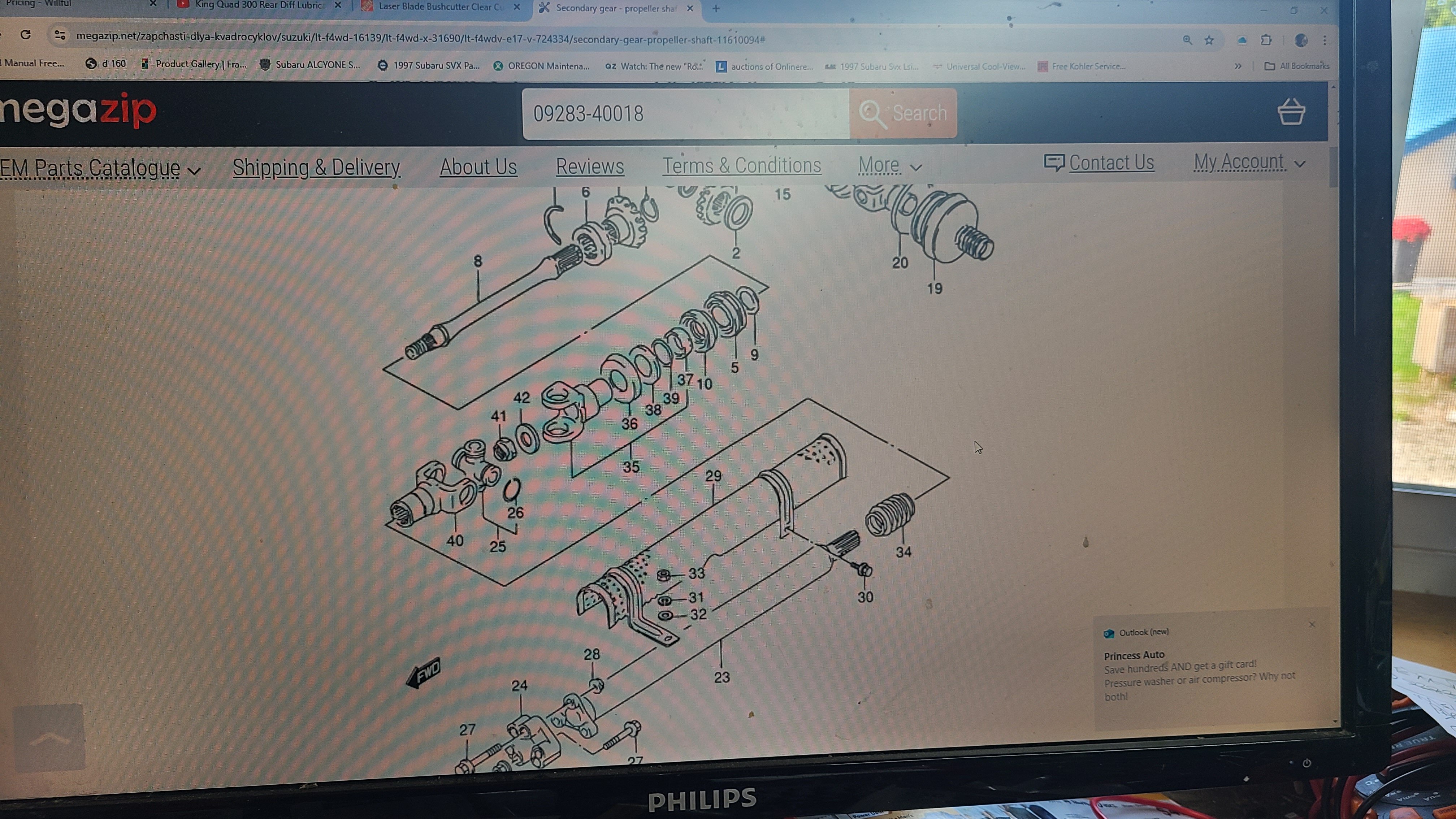

Here's what I found for the right  bits to fix the drive shaft leaky seal. I'd appreciate it if someone could tell me which bits I need, and which I don't. Also, should I replace the U-joint while I've got it in pieces?
Yes you change the uj. I described the steps involved in #29. You need part 25 and the seal which is part 36 or 38.
The seal can be bought aftermarket but I'd recommend the genuine part because it has a hard wearing lip to it. Same with the rear seal.
When you put the yoke back onto the bike it's important to seal under the washer, and the nut, or it can leak oil.
If you've done universal joints before, the following, from an earlier thread, might make sense. If you haven't done universals before I can describe the steps in more detail.
"The universal is a bit of a bugger to do because you need to dismantle it in place, then put it together in place again as well.. unless you have a special dealer tool to undo the bolt to take the shaft away from the gearbox. The good news is that the universal joint is an excellent design and as far as universal joints go, it's almost foolproof.
Most uj you need to be very careful as you put the cups into the yoke  and onto the cross because it's really easy to dislodge a needle roller. On these crosses you can slip the cup into the yoke and onto the cross without having to press the cup far in, and then the other side cup goes in and onto the cross before it has a chance to drop a needle.. If you've done a car universal you will know the normal problem that requires you to press the cup a long way in till the cross is poking out the other side, then get the cup on the second side and press the whole lot back to the centre of the yoke. You don't have to do that with these ujs.  The hardest part is getting the circlips on and off. The cups also seem to slip most of the way into the yoke too before you have to start tapping or using a g-clamp on it.
They look daunting, but are a lot easier than it looks.. If you've done a uj before you should have no trouble.".

Yes #38 is the seal and if you bend #36 getting it out i would replace that also along with 39 which is an O ring, im sure its quite brittle.
Great description of changing the U joint Mech its always good to heaar little tips and tricks for getting them in and out.

It's too late to cancel the rear seals and bearings, but "All Balls" parts have previously been of decent quality.
I'll print this out, and hit up the Suzuki Dealership, and get  the bits I need to get it done.

Umm not so much, as least as far as the rear bearings are concerned. The bugger came apart in pieces. The pieces from "All Balls" arrived, and I had at it. All went according to plan, at first, ( well.. doesn't everything?). All good right up until it came time to pound in the inner bearing. I should have known hurt was coming, as the outer went in just too damn easy. Maybe, because it was seized and had probably spun, or tried to..  Might have been the reason for the " whoop whoop whoop" tire path. But anyways.. When I went to bang in the inner bearing.. no frickin way. I started by cleaning the internal race... Brake cleaner, compressed air, wire wheel on a air die grinder.. wash, rinse, repeat.
I started trying to tap it in.. At first, all good.. then it just got plain old stuck. I slowly, but surely, increased my aggressiveness on banging it's sorry as* home. No dice. pounded it so hard that the outer fell back out. 4 pound sledge hard.. no way it's move another thou..
Flipped it over, and three smacks later, the inner is in my hand. Only problem is, is that I hit it so hard, the inner is no longer a bearing. the inner won't turn like the other one that literally fell out when I was banging the other one.  and I used what was called for..  nice fat socket, moved it around, smacked it ... probably 3 to 4 hundred times, with various degrees of impact. Got out the torch and ( gently) heated the outside of the 2 cones..  No difference,, it wasn't going in another thou... no how.. no way.
FWACK... FWACK 'effin FWACK!!
So.. I ordered another bearing / seal kit from "All Balls" through Amazon. Should be here on Saturday, the 28th .. I've re cleaned the inner again, ( wire brush bit on a air die grinder ).. Do I take another whack at the Suzuki King Quad Pinata, or do I take the bits and hand them over to a shop with a press?
