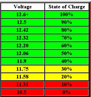

ok.. soo I checked the battery and it reads 11.40 on a 20v meter so I took the starter off and grounded it to the frame and it turned over but sounded rather weak to me. soooo I hooked it back up and used the solenoid ground this time and got nothing..... soo then I bridged to solenoid and stillll nothing. now my solenoid wont even click......... then I went on a rage and threw a few wrenches and came and typed this. haha thanks for all your help so far man!
U might wana put it on a battery charger on the lowest setting
For several hours.. Maybe over nite and see if it will try to turn
It over..
I know that the battery in my sons quad won't start my big utility quad ...
As it dosent have enough amperage ... It will click or may make the starter
Drag ... An turn very slowly till it comes up on the compression stroke and
Then it will stop and click .. You might need alot bigger battery or 1 that
Has more amps per hour rating ...
i usually let mine go all night, but if you are reading that, it should be good ...
you might want to do what ck suggested with the starter, i would try to take it to a napa or someone that can do a load test on it. it might spin while out of the engine, but might not under a load. i would check the gear/sprocket the end of the starter goes in too. it should spin freely one way only ...
