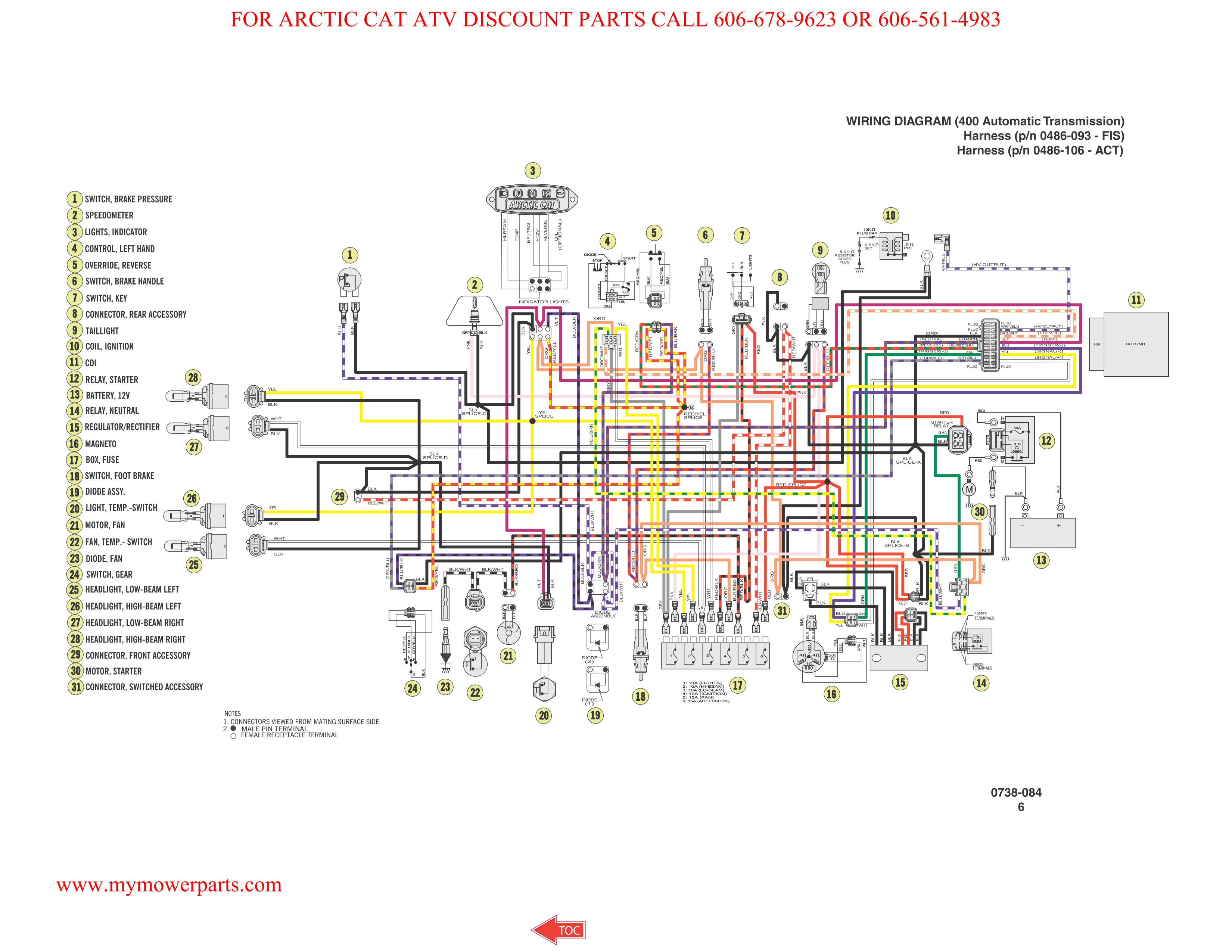

I replaced the plug and still no fire and i tested the cdi on an identical arcticcat my buddy has
Next step would be the coil. I attached the diagram, it is #10
I would also check #16, if you look at the diagram there is a sensor that sends a signal to the CDI to tell it to fire the spark plug.
Pull the connectors apart, check for corrosion. Clean with electric clean and grease with diaelectric grease before plugging back in.
