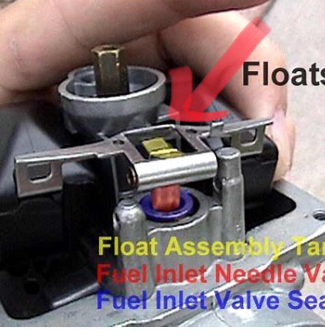

I’m wondering if you have the float set at the proper level. Is it possible that you bent the tab that holds the fill needle in the bowl and maybe prematurely cutting the fuel filling up the bowl to the proper level?  Maybe take a look at that it happens.
Take a look at this pic, I added a red arrow pointing to the tab but would only apply if you have the metal tab on your float as some floats are only plastic. It gets bent in any one direction two things will happen the float will push up to soon or not push up far enough resulting in a flooding of the carburetor. Good luck.
my float is plastic,, no adjustment... if I open my drain screw, it will definatly run out faster than it could use it.. so plenty is getting to the bowl... and usually if its ignition related,,, i should hear some form of misfire or something... this thing runs like a top!.... i have had some issues with my starter valve hanging up... but while i was cleaning the carb,, i sprayed it also, (the valve and the bore) now it works as should...what a puzzle aye?... air, fire, fuel.. ... i know im getting air.... i know im getting fuel to the bowl... clean carb, jets all are open... could a rev limiter malfunction and cause total shutdown of the spark?.. im yet to use the timing light to see if its still has fire when it shuts off... sure im not the first one this has happend to... hope someone could give definite answer...i will be sure to post update if I find it...
Even  plastic floats have a  height adjustment  tab.  It  may be set too   low  and the  carb bowl  is not filling to the proper level.  Opening the drain screw  merely tells you the   bowl  is  getting fuel,  not  if it is at the proper level  or  not .
