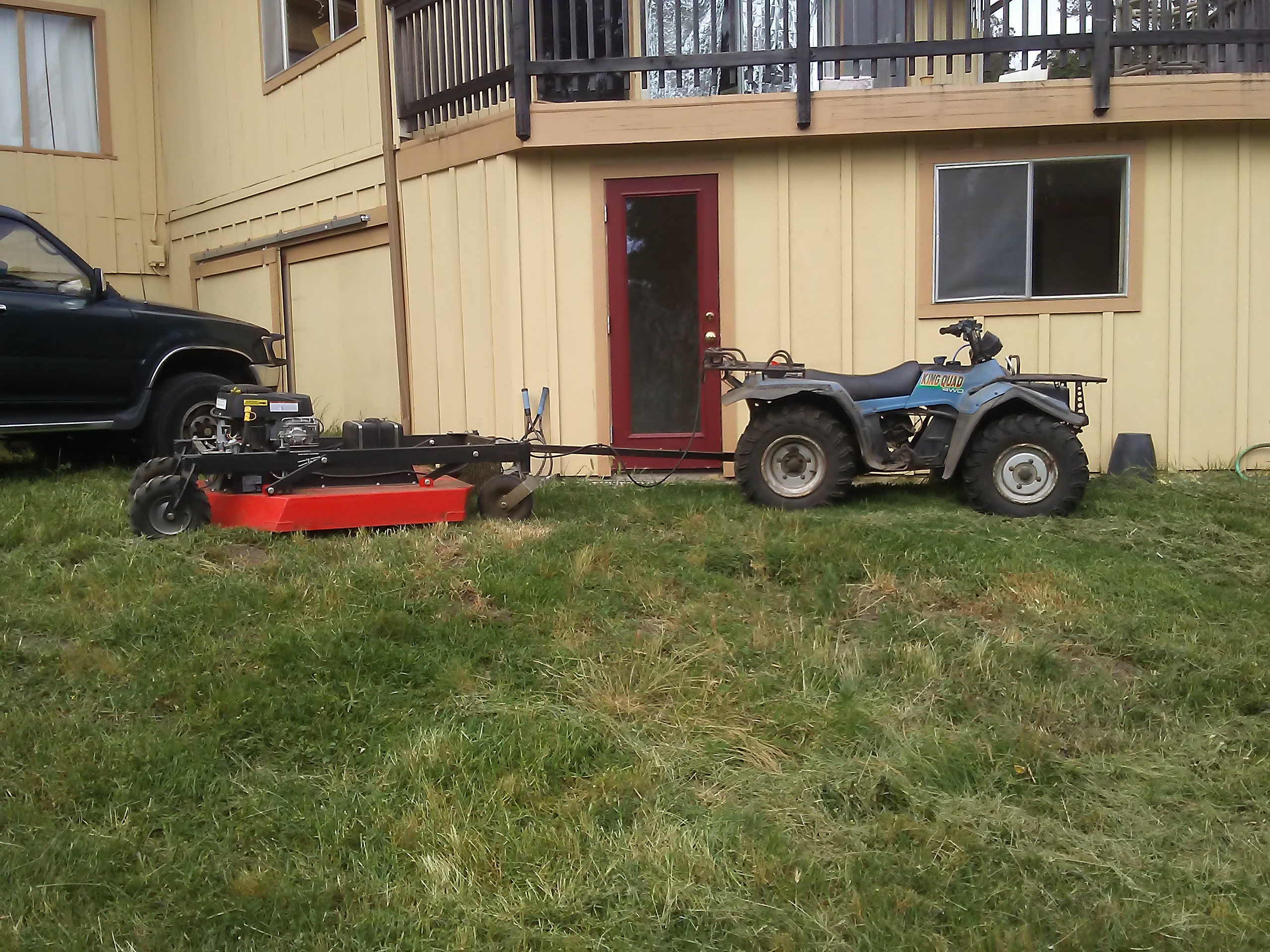

Hi Dra O, I have a 98 model, I agree with AJ also my shop manual, not owners manual stresses changing the oil filter gasket every time, it's an O-ring and should come with the new filter and don't go cheap on the filter and good oil, SF or SG classification no synth. You can see mine and one of the uses it has in the Suzuki forums under ignition?'s. they are a solid machine and workhorse, Enjoy!

If you are planning on doing your own work I recommend  purchasing a Clymers shop manual for your machine. you will need the vin# and mod /yr. You can find the vin on the left rear frame down tube. As for fender removal I use an air driven ratchet or impact screwdriver for the tough ones. A little spray of blaster and soaking time also helps. The nuts underneath are 9 or 10mm, I have CRS so you'll have to figure it out. The only other bolts are under the battery and underneath by the front shock mounts (2) these are 12mm. 2 screws,one each side at the frame down by the bottom of the mud guards. And of course the shifter knobs and shifter plate cover( remember to put the gas cap back on) and the remaining bolts/ screws. there are 2 at the steering post you can access by turning the wheels lock to lock. Then disconnect all the elec conn up front and have a helper guide the assembly off the bike. It is recommended to remove the front mounts for the rack( that you have removed? I omitted cuz I thought it was obvious🙄) but I have managed to pull the fender assy off without doing that. But if it's starting and running why bother, check oil and fuel and go ride! time for me to go mow!
