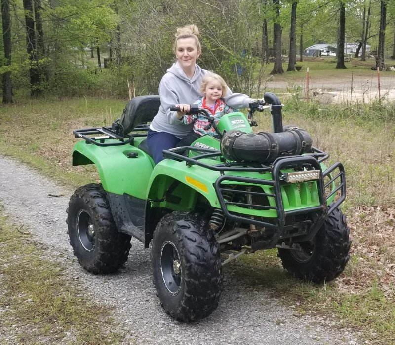

Well, I bought a timing chain and tensioner and it solved the problem. I installed it Saturday and have put some hours on the A/C and it starts and runs great!! It starts and runs first time every time. It feels strong whith no smoke and I think its gonna make a fine bike. Also I used a solid aftermarket tensioner that seems to work very well if anyone was curious. I actually believe that the stock tensioner was the failure point. I have never been a fan of automatic tensioners. Thanks for your help davefrombc.
