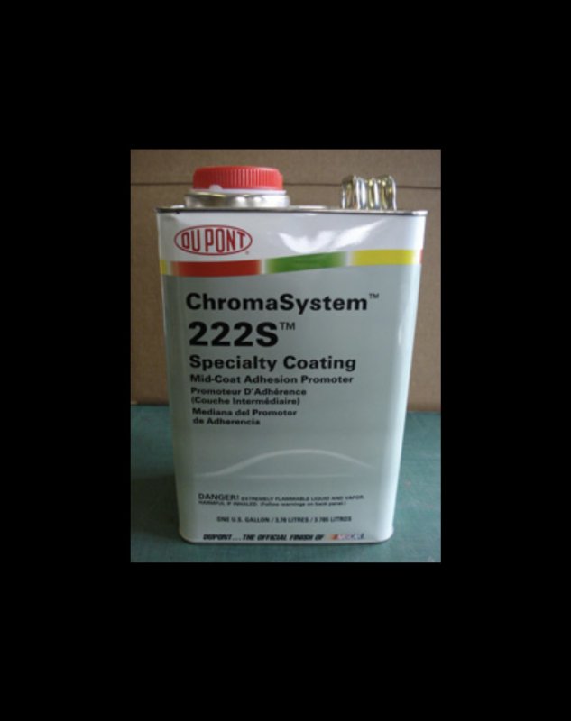

You can actually clear coat. I’ve been experimenting with a special chemical called 222 by DuPont. Body shops have been using it for years.  What it does: you water sand the plastics with a 2000 grit sandpaper and wash and dry the plastics.  Then you spray this 222 “mid coat adhesion” on the plastics and then a clear coat.   The mid coat does two things.
1. It’s completely flexible so no cracking and is made specifically for the rubber and plastic bumper parts on cars.
2. It allows the clear coat to stick reallly well and makes the clear coat flexible as well.
Im waiting on the right bike to try it on or a faded free piece of atv faded plastic to experiment on.
You do need a spray gun however.
You can get it at any auto body paint supply shop.  Its in a square can.
So you have to follow the directions or ask Any local body shop and they will tell you how to use it.   It’s sprayed on and then the clear coat.  You can also add a little to the clear coat for flexibility. Use a  DuPont clear coat as well.  I can’t wait to try it.
