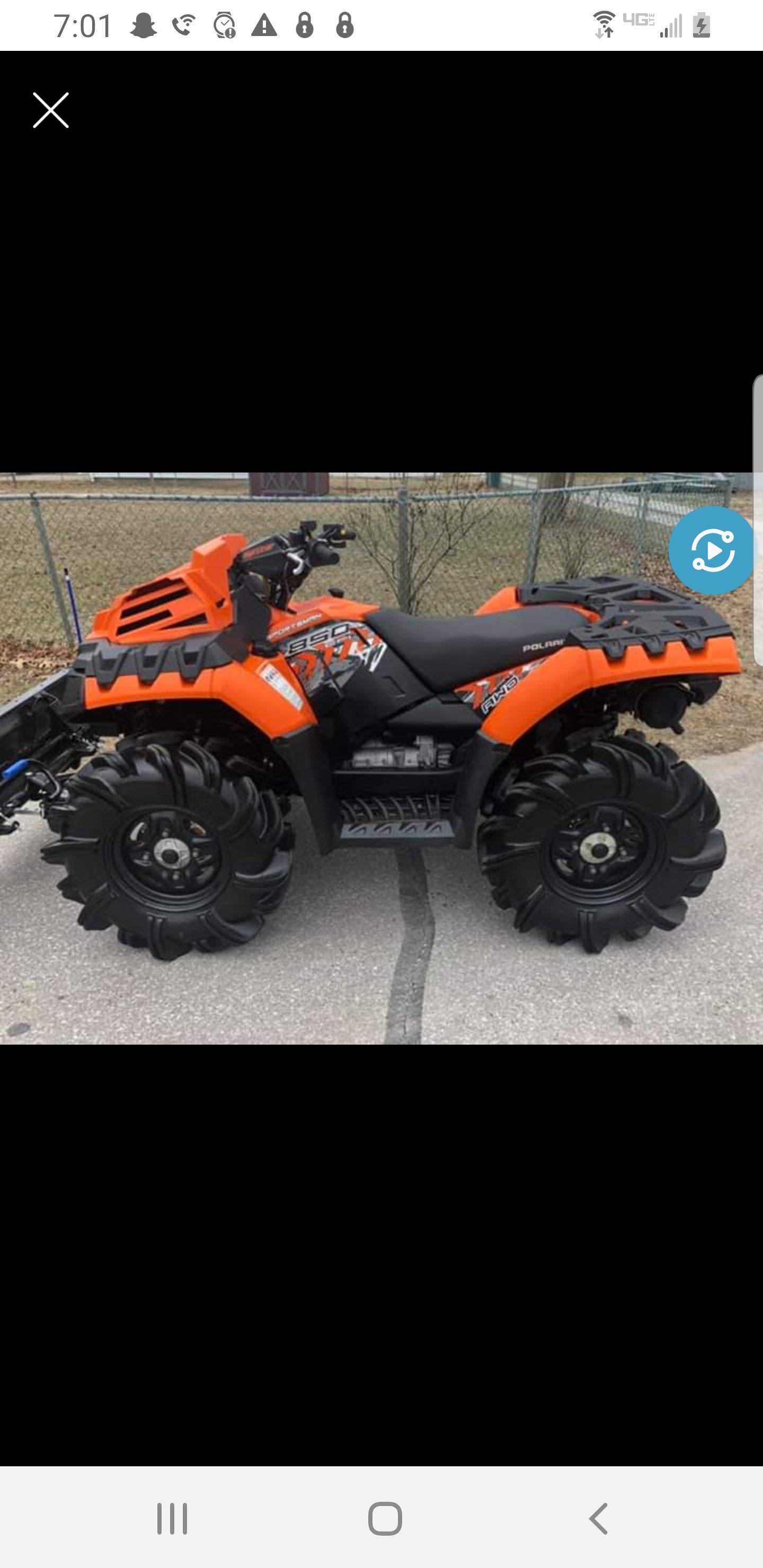

Tried to start my 850HL the other and had no spark. Changed the plugs, but while checking for spark noticed not getting fuel either. So no spark and no fuel. ECU? Anyone else have anything like this?
