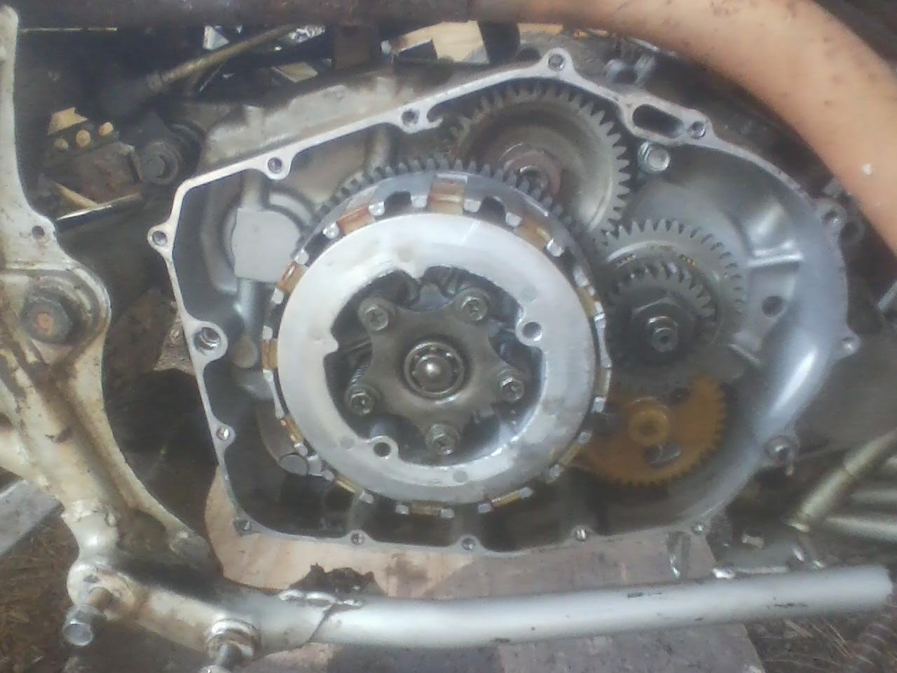

drained the oil and took the side cover off today.  this is what the inside looked like.  i think i have the black bolts on the clutch adjusted wrong...?  The linkage from the outside to the inside looks good.  i had those black bolts all the way in.. dont know where they are supposed to ba and didnt want them to rattle loose
figured out the issue- just the incorrect tooth on the linkage.  Jumped the bike and took it for a ride (strained the oil, cleaned the oil filter, and put it back in).  the clutch seems jumpy like it engages all the way at about 3/4 way out.  And it doesnt like shifting into neutral when running and when its off, neutral is between 1st and 2nd gear...??? gonna order a new battery for it as every time i stall, it has to be jumped..no pull start.  also, i was thinking of getting a aftermarket air filter that attaches directly to the carb so i didnt need an air box.  is this a bad idea?  the old airbox melted on the exhaust.

Sounds good. Nice work.  If the clutch is grabbing 3/4 way out the clutch needs replacement plates and springs.  Not a big deal.  Yes is one down four up or five up whatever it is. When you want to go to neutral you go all the way down and a half click up, that’s neutral.

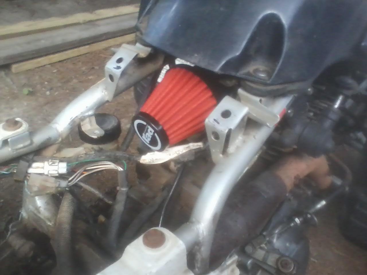

This is the type I put on from amazon
45mm Universal fit"Turbine" Air Filter - Motorcycle Scooter Pocket Bike ATVs - Blue (Model 10410-02) https://www.amazon.com/dp/B01DWGRL14/ref=cm_sw_r_cp_api_i_6YseDbM4GBSQ3
ohhh  ok thats what i thought.  so i think there IS a breather, but it didnt hook up to the old airbox nor was there a place for it to hook up.  it just stuck up and dead-ended under the gas tank..  i tucked it under the carb so it wouldnt collect rain (i believe this was how water got into the engine from sitting out for years).  anyway i bought a 45mm high flow filter for 20 and it looks beautiful!  sputtered at top end so i adjusted it richer like you said and now it runs great.  I was having issues with the clutch engaging to hard and stalling me but it softened up and is easy to drive now.

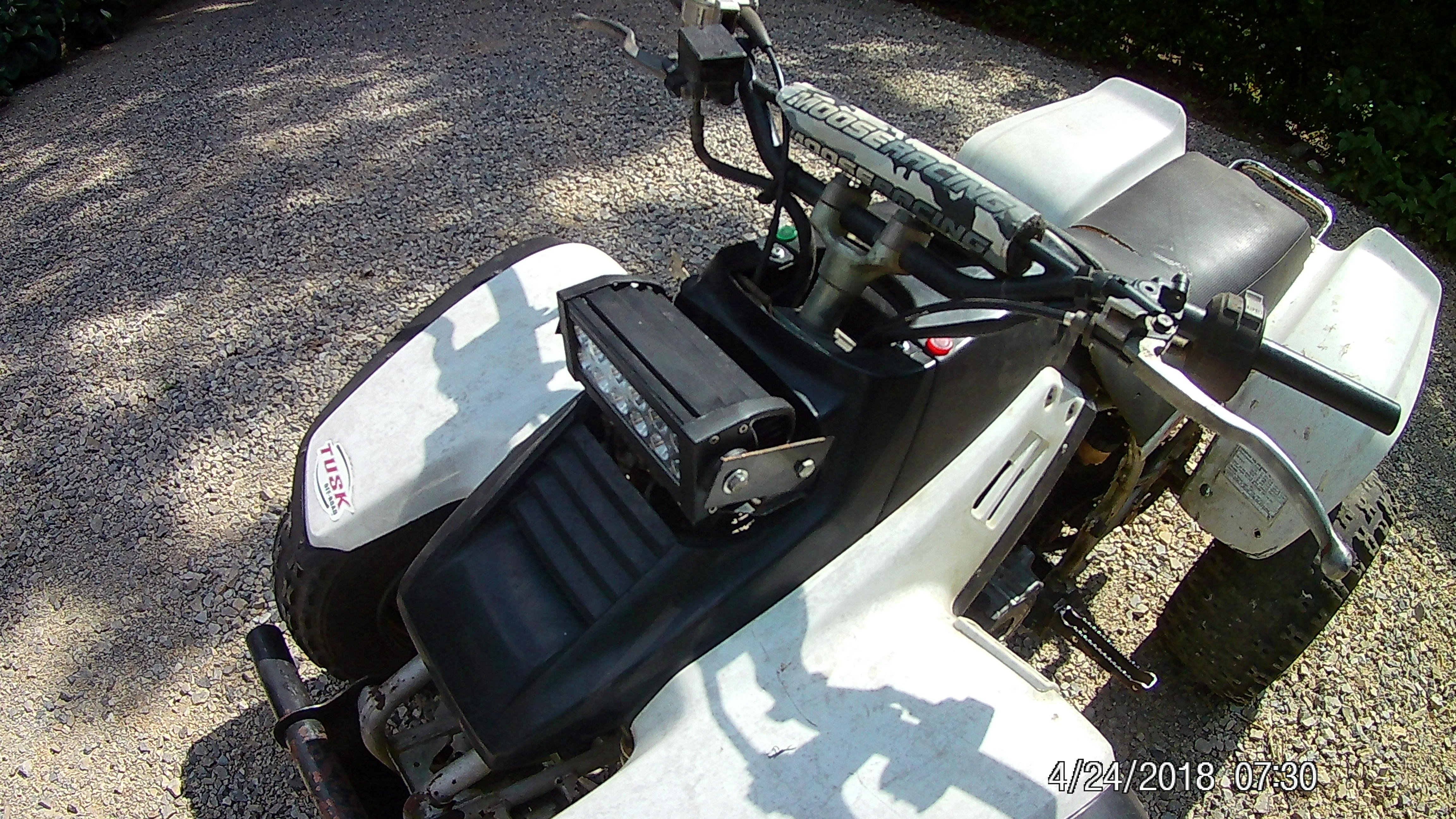

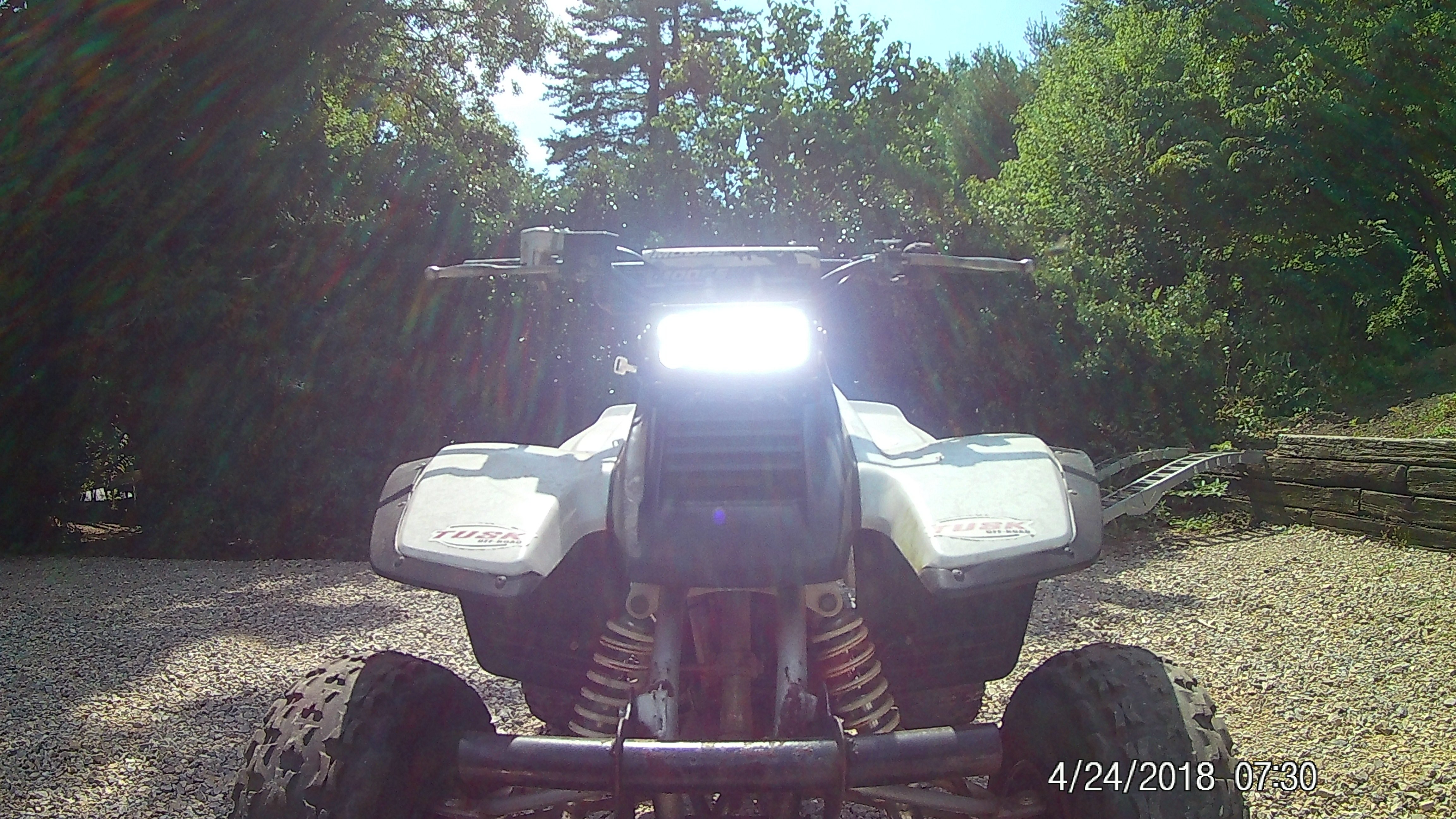

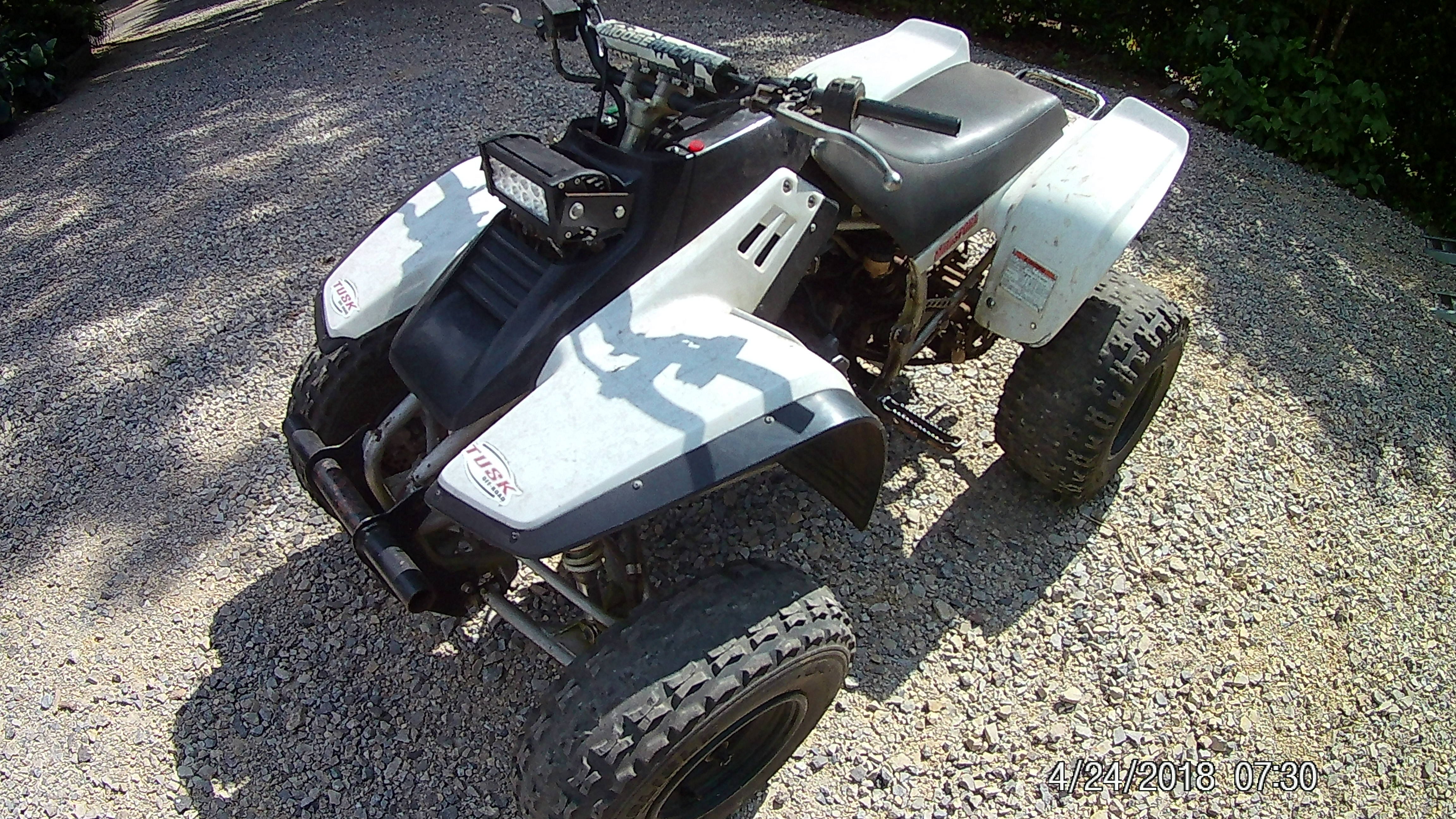

oh and i took those ugly lights off and put on the lightbar that i used to have on my bayou on this bike:
lol those are gopro pics- and its date is off.. i took those this afternoon
