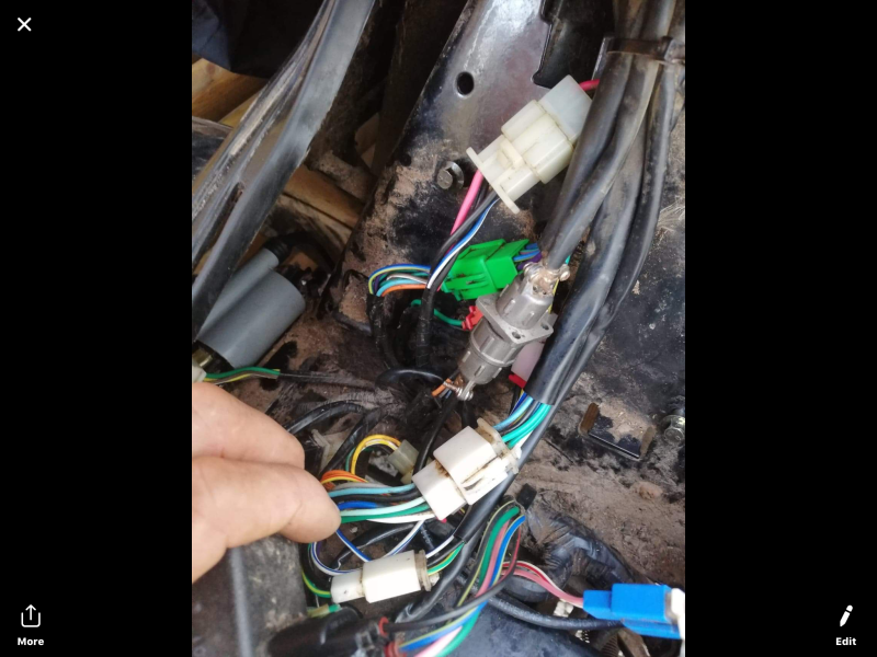

That could be a solenoid, a dirty plug or connection, switch contacts etc.  Nothing burnt up though right ? Fuses were all good prior to the rectifier swap out ? Nothing happened to the bike? Got banged? Any service work done that could have resulted in a pinched wire ? Check along the neck of the bike on the front end where everything comes up to the controls. I would think you should also unplug, clean and add dialectic grease to the connections as well because this honestly could be something along those lines.

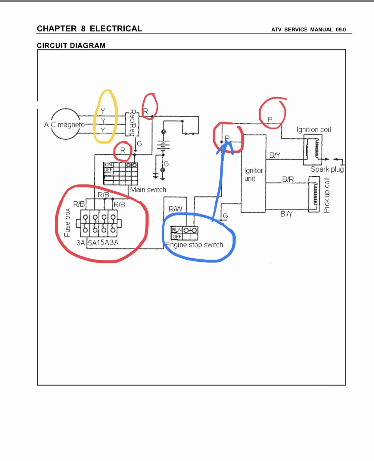

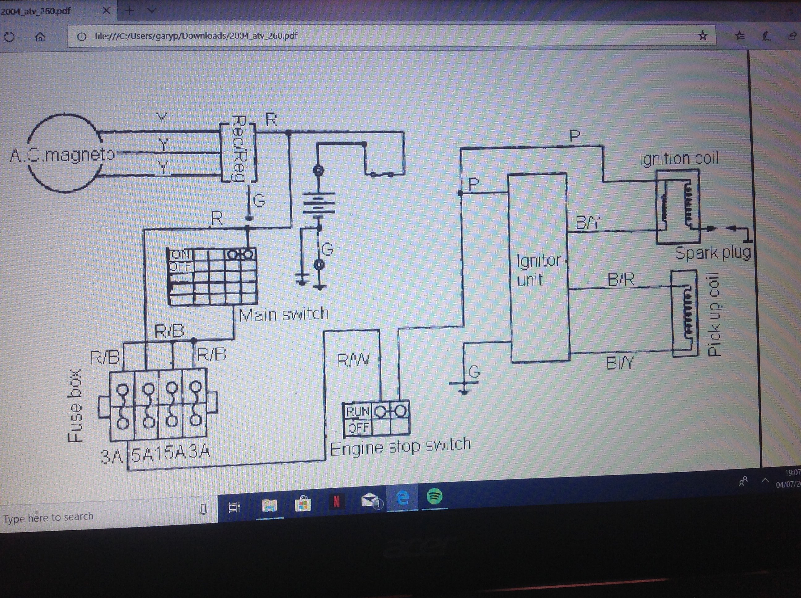

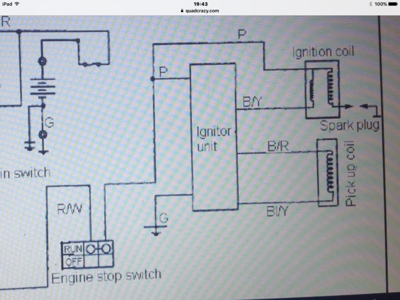

Hey Gary, I was looking through your wiring diagram and highlighted a few things.
Please verify that I’m looking at the right diagram please.

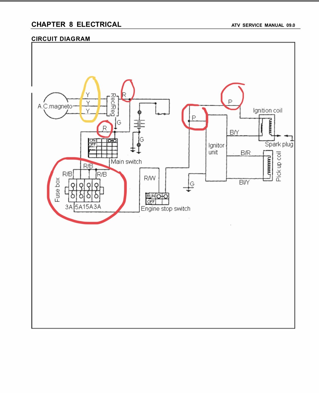

As a side note have you tested your stator coil to see that it’s not dead shorted. Reason I’m asking is based on your wiring diagram it looks as the stator goes directly to the regulator/rectifier. So I would unplug the stator and do a quick test from each phase to ground and see if you get any sort of continuity on the tester. You shouldn’t get any reading from any of them yellow wires to ground. If so there a problem within the stator. You can also unplug the stator and try the regulator again and see if it blows a fuse.
Then if that checks out ok I would disconnect the battery and put one lead of the tester to the ground and start touching various parts of the red (hot wire) that comes from the fuse block going to the regulator as well as other areas that carry a 12v hot lead looking for a short.  So make sure your tester is on continuity/ohms setting. I like to use a tester that beeps when there is continuity.
Also test the starter wire, starter relay and the line going back to the battery to ground for continuity. This way you eliminated everything that could be a short leaving only a fault in the cdi.
lastly the third pic I circled the on off switch in blue it appears the wire is listed as “P” so maybe (purple?)   it comes from the on/off switch and if it’s disconnected it appears it will isolate the cdi unit from the rest of the system. So try to find that wire around the kill switch and unplug it. Install the new rectifier and see if the fuse pops.

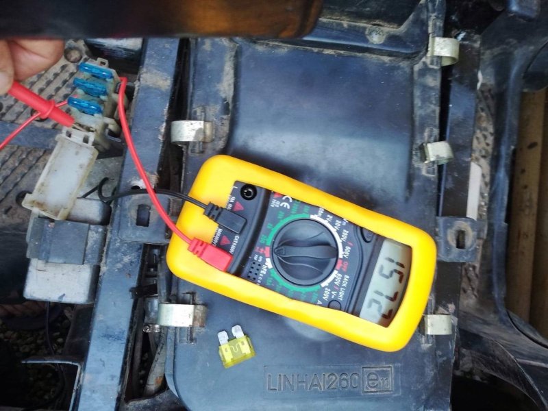

      I have a 2022 Honda Rubicon and I have an issue where it won’t start, when I turn the key for power nothing lights up and it won’t start but the lights will turn on with the light switch, I’ve checked all fuses and they’re good, I don’t have a wiring schematic I’m not sure where to start, I checked the ignition fuse when I turn the key on and there’s no voltage there, I used a jumper wire from the batter to the top of the ignition fuse and then it works fine and starts fine but as soon as I turn the quad/key off it won’t start again until I jump the ignition fuse with battery power, just wondering if anyone could give me some tips where to go with this or if anyone has had the same issue, thank you.

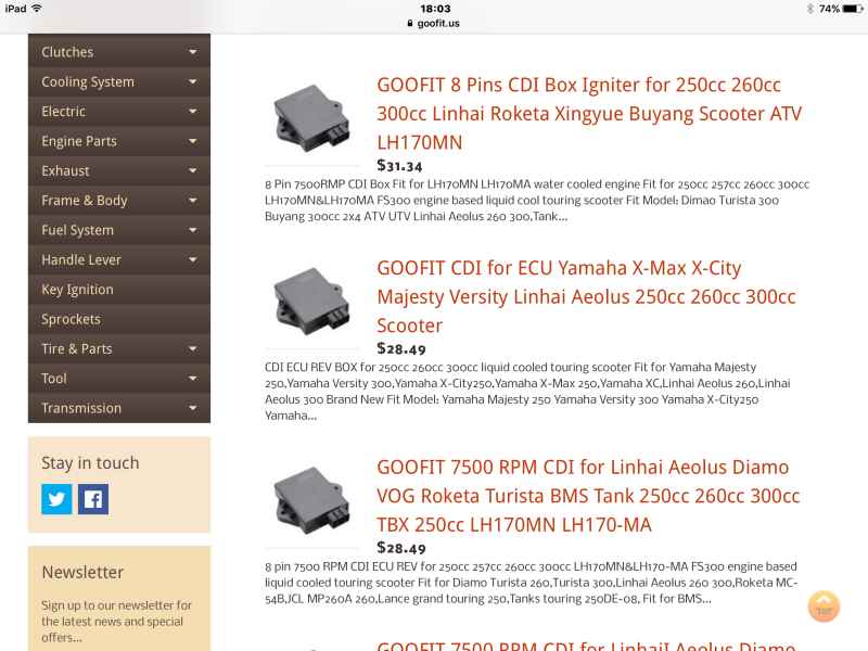

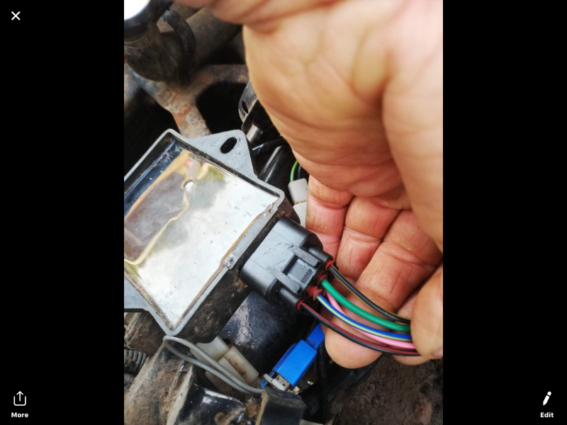

      Bought the project a few weeks ago with weak and intermittent spark. I could smack the CDI box with a screwdriver and it would work fine for a few days. Now, the smack trick is not working and machine is running awful with the weak spark and will most often not fire enough to turn the engine over through combustion (cranks very good). I ordered the GY6 CDI to see if I can get it going again as these CDI boxes are way too expensive even used. battery is fully charged and charging very good.
      Wondering if anyone knows how the GY6 (6-pin AC) CDI would wire to this machine. Attached is the electrical diagram. My confusion is with the green and orange wires sharing the 2-pin connector and the Blk/Red wire that runs to the magneto solo. How would I get AC power to the CDI through pin 1 on the GY6 when the CDI has two wires to the pickup-myabe just try one (orange then green) at a time?
