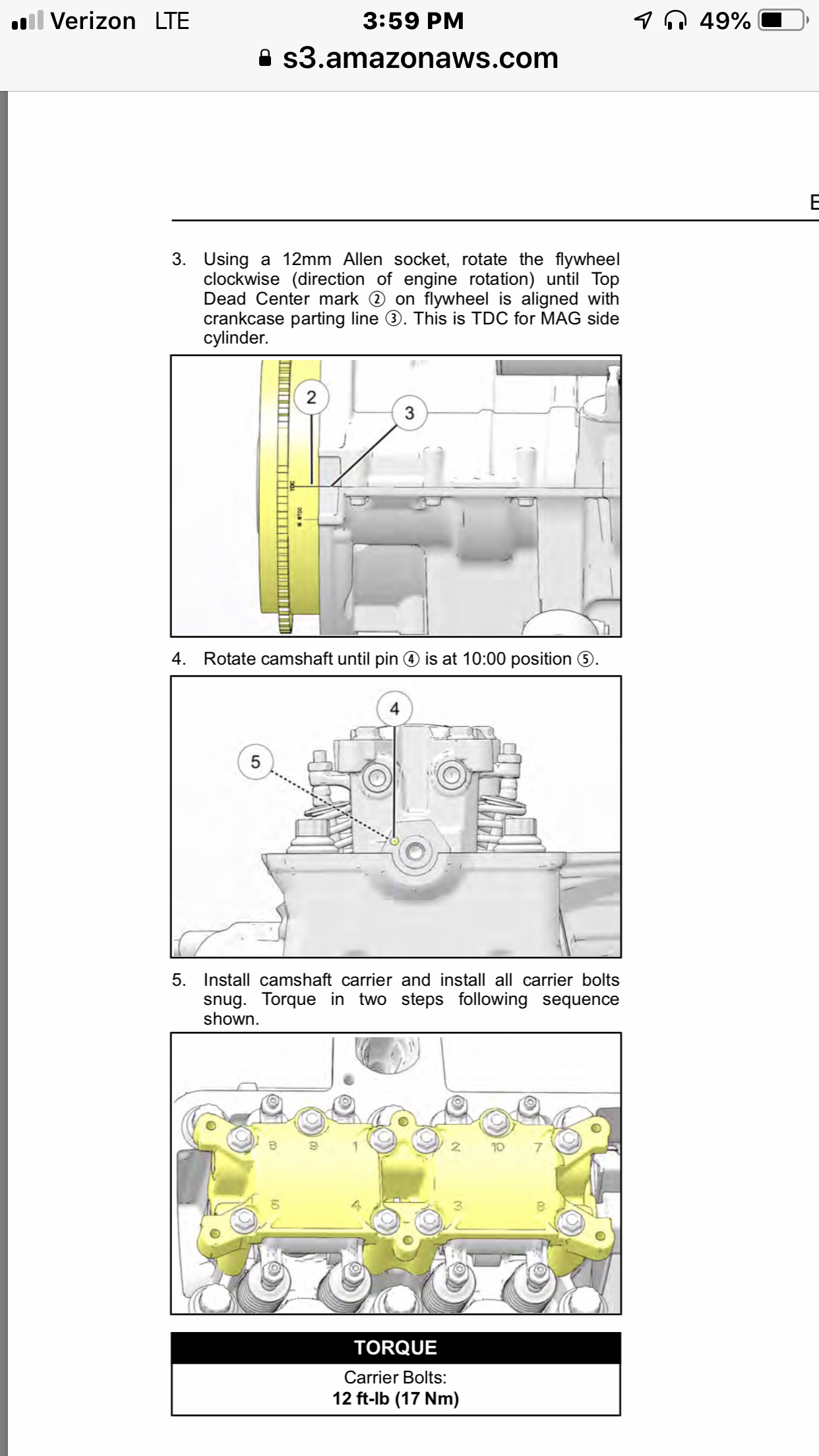

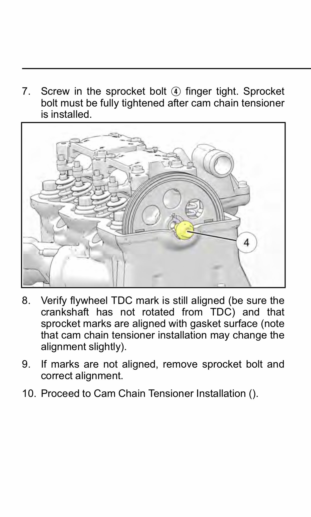

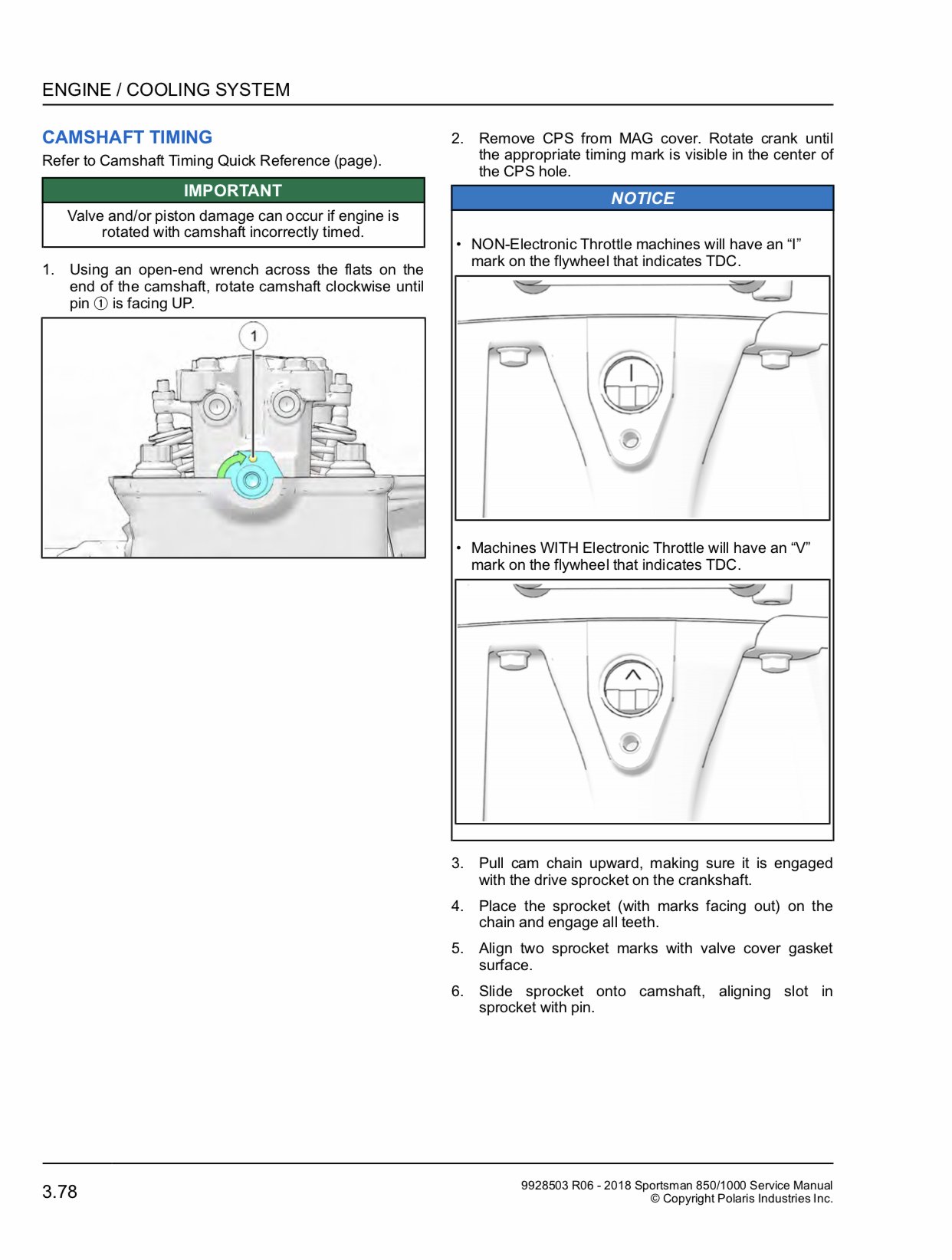

I'm having trouble identifying Mark. I know where the mark is in the Stator cover. Is the T at about, the 12 o'clock position in this photo? I've got to buy another Stator cover as the one I have has a hole at the bottom of it. Due to failing eyes, I have a lot of trouble anymore. Thanks! 🙂
