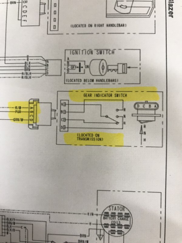

You mentioned it will start if pulled or if you  bypass the starter circuit  and jump from the battery to the starter.. That  makes me suspicious of the neutral safety switch,  or  a relay  connected  to the starting circuit. First , do you  have  power  through the  key switch  when  you  have it turned to   start ?  check  that   you  have continuity through the  neutral  safety  switch, and then  through the  starter  relay. I'm sure  you'll find the fault somewhere in  that circuit. The  no  lights  might be related or another problem to trace down  after you get the  start  sorted out .

The gear indicator switch. It’s located on the transmission. Should have a Red wire with a white stripe. Also should be a purple wire and a green wire with a white stripe? See if you can locate them. This way we can confirm that it’s the correct diagram.
That switch will lock you out of any starting capability if it’s faulty.   You can jump wires to test it and see if you get dash lights.  The red with white stripe and the green with white stripe look like it will bring the dash lights on if jumped together however you should only use a test light or ohms meter to jump these two Incase there’s and issue nothing will blow.
Also the ignition switch. Test the plug for power and see if you have 12 volts at the ignition. If so what color wire has the power it should be the red wire.

Thank you it's not the kill switch i have a new one i just installed on The machine and after using the multimeter it definitely seems to be the indicator switch thank you guys if I'm wrong I'll ask for some more advice
