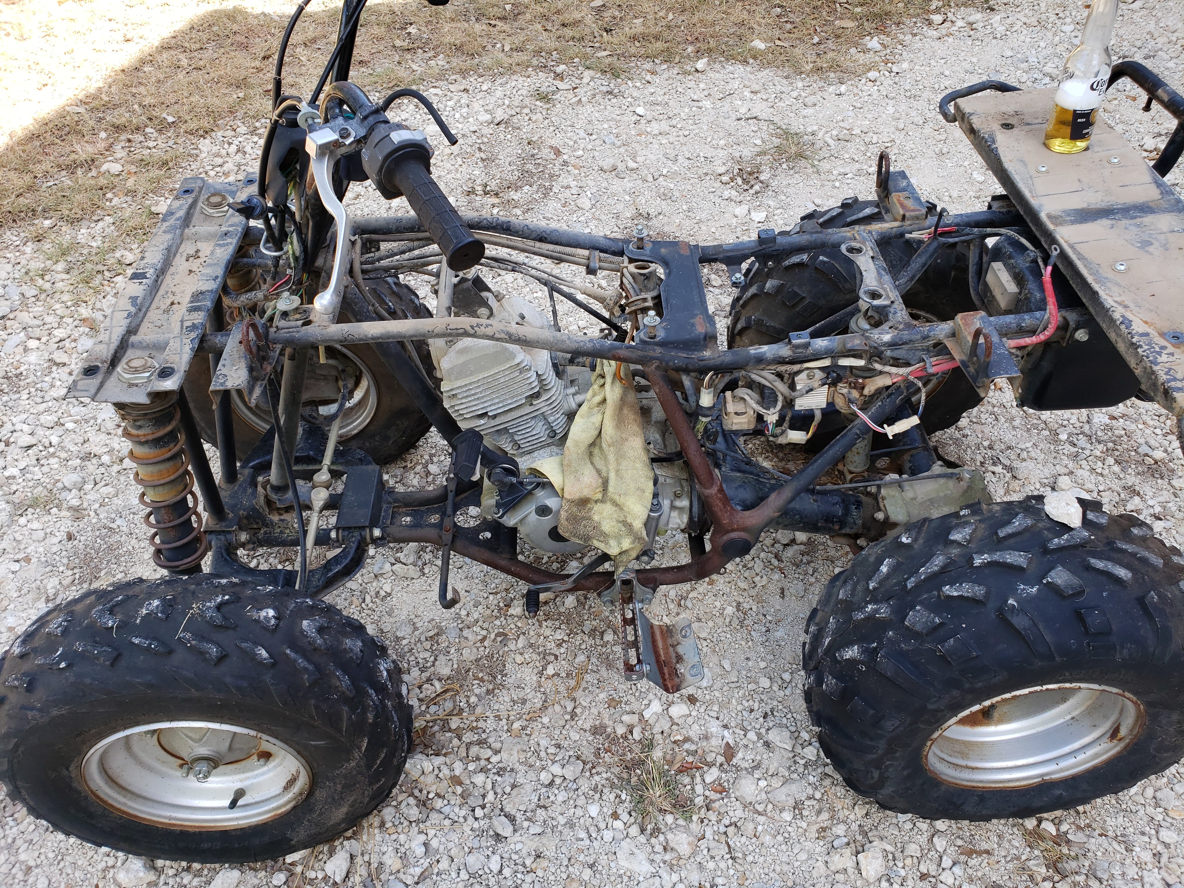

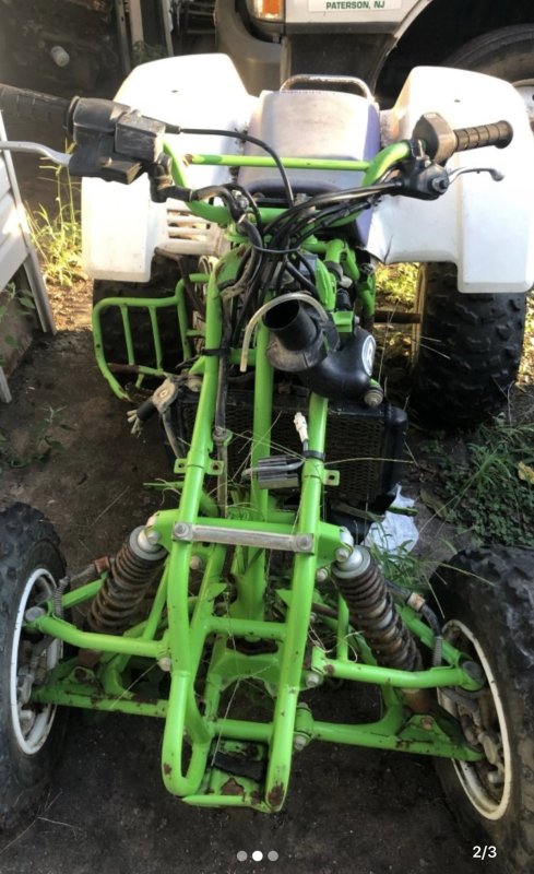

Went shopping on Saturday, picked up another Kawasaki Bayou 220 and a Yamaha Timber Wolf 250
I really should sell some of these but they are a lot of fun to find, fix and ride
Of course neither of them run but that's part of the fun!  Az

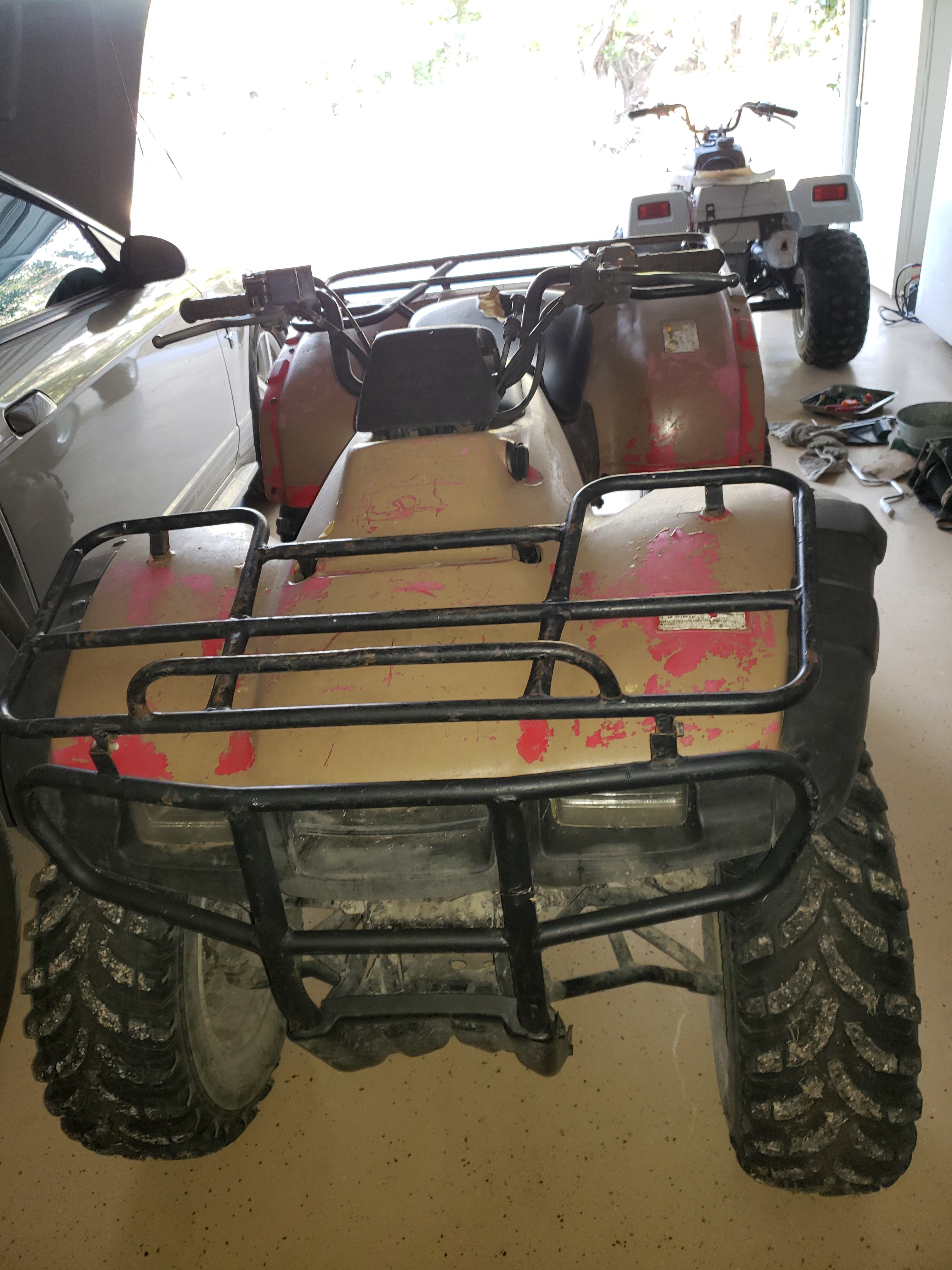

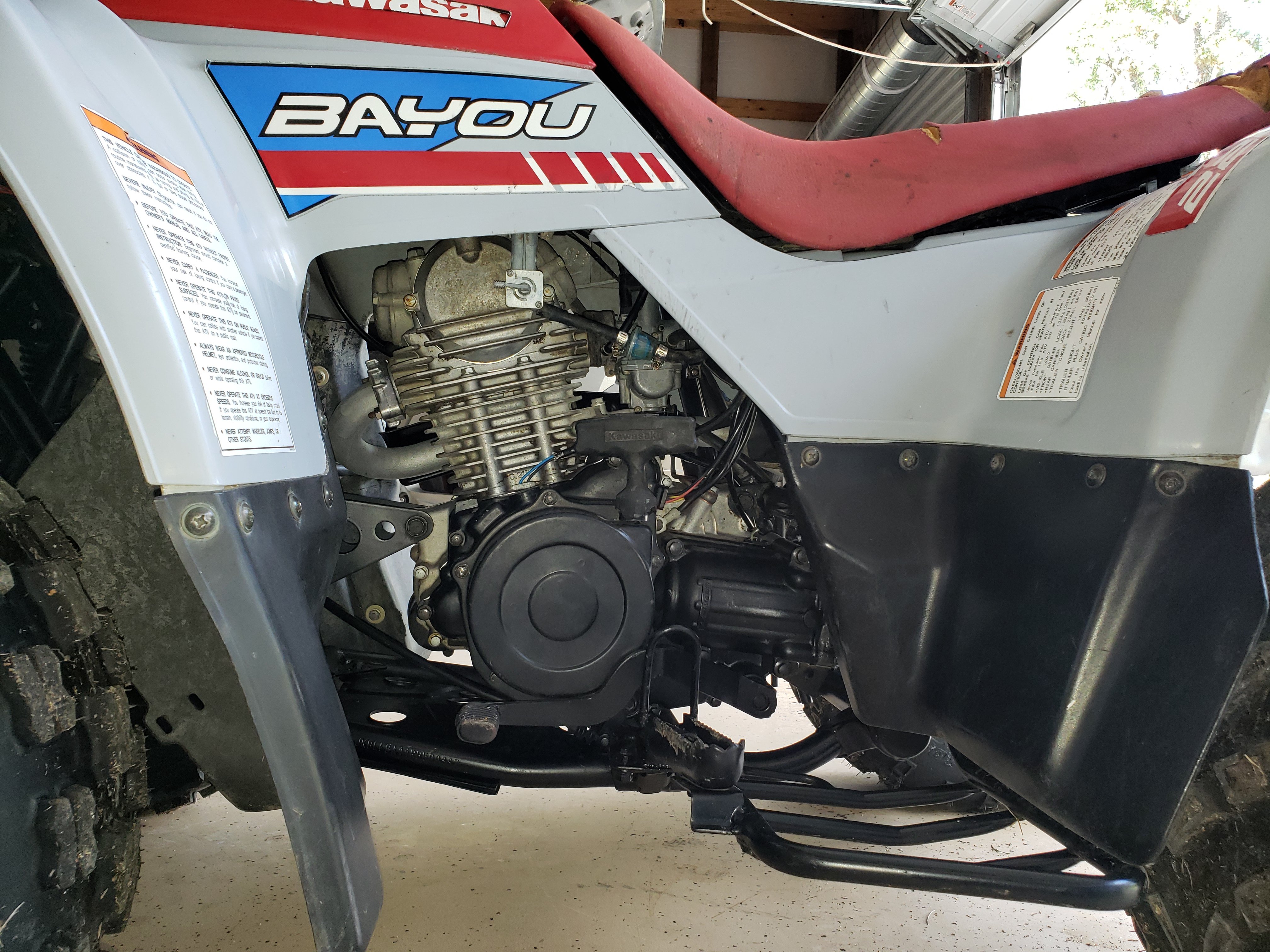

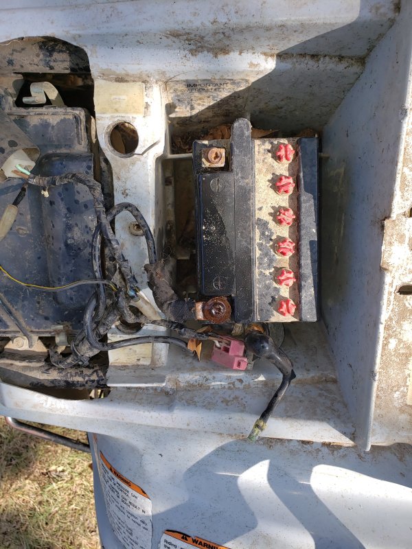

little on the high side, 650 for both. But ill probably get it back out of them later. Looking at the Bayou  see anything wrong lol, has the pos grounded! Pos wire is broken in half.

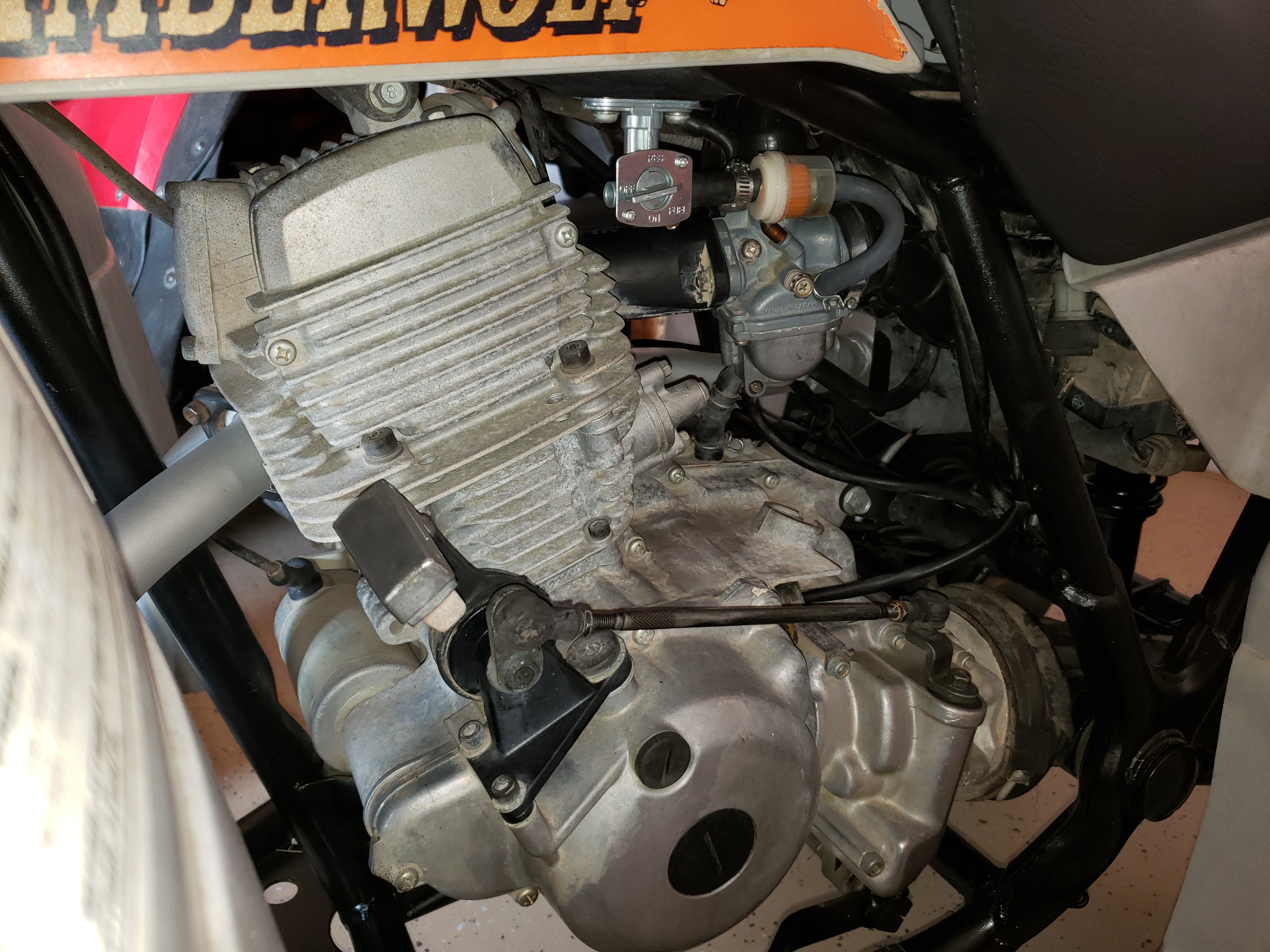

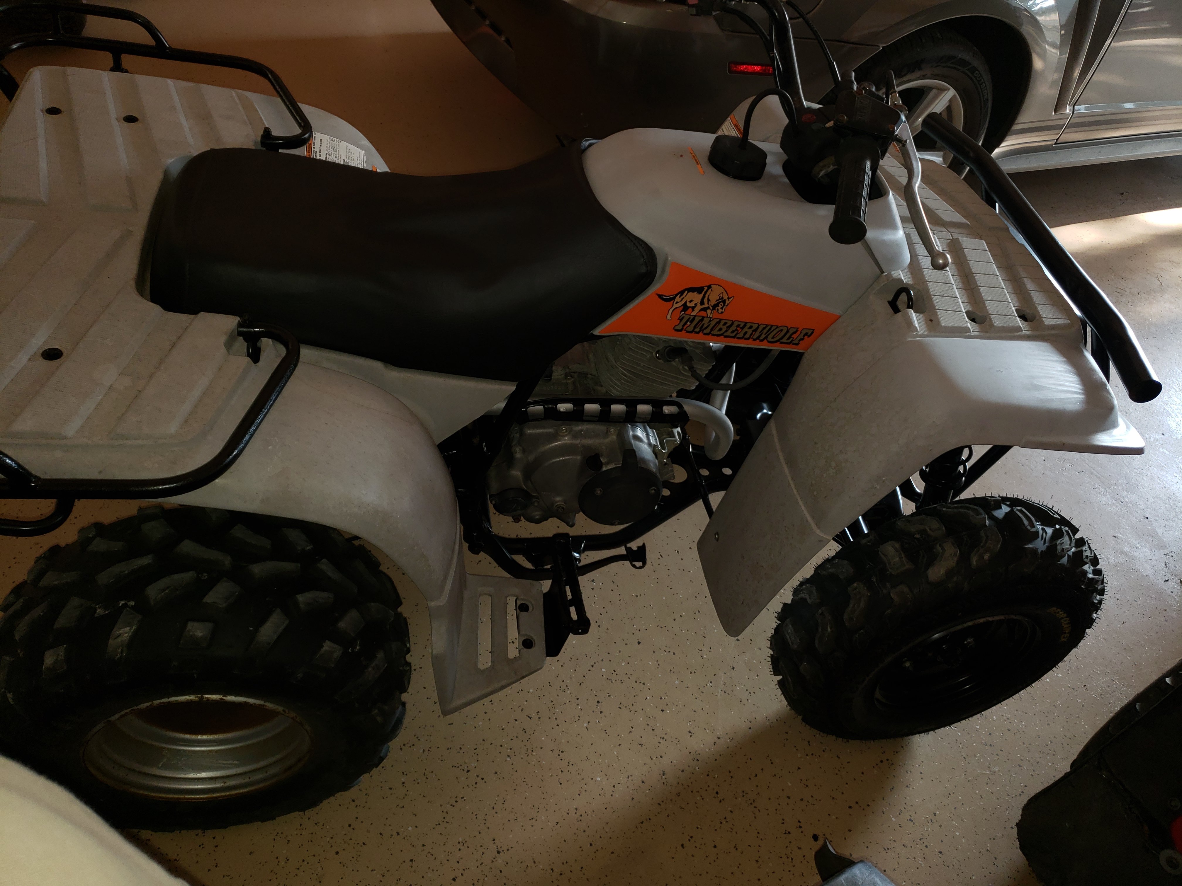

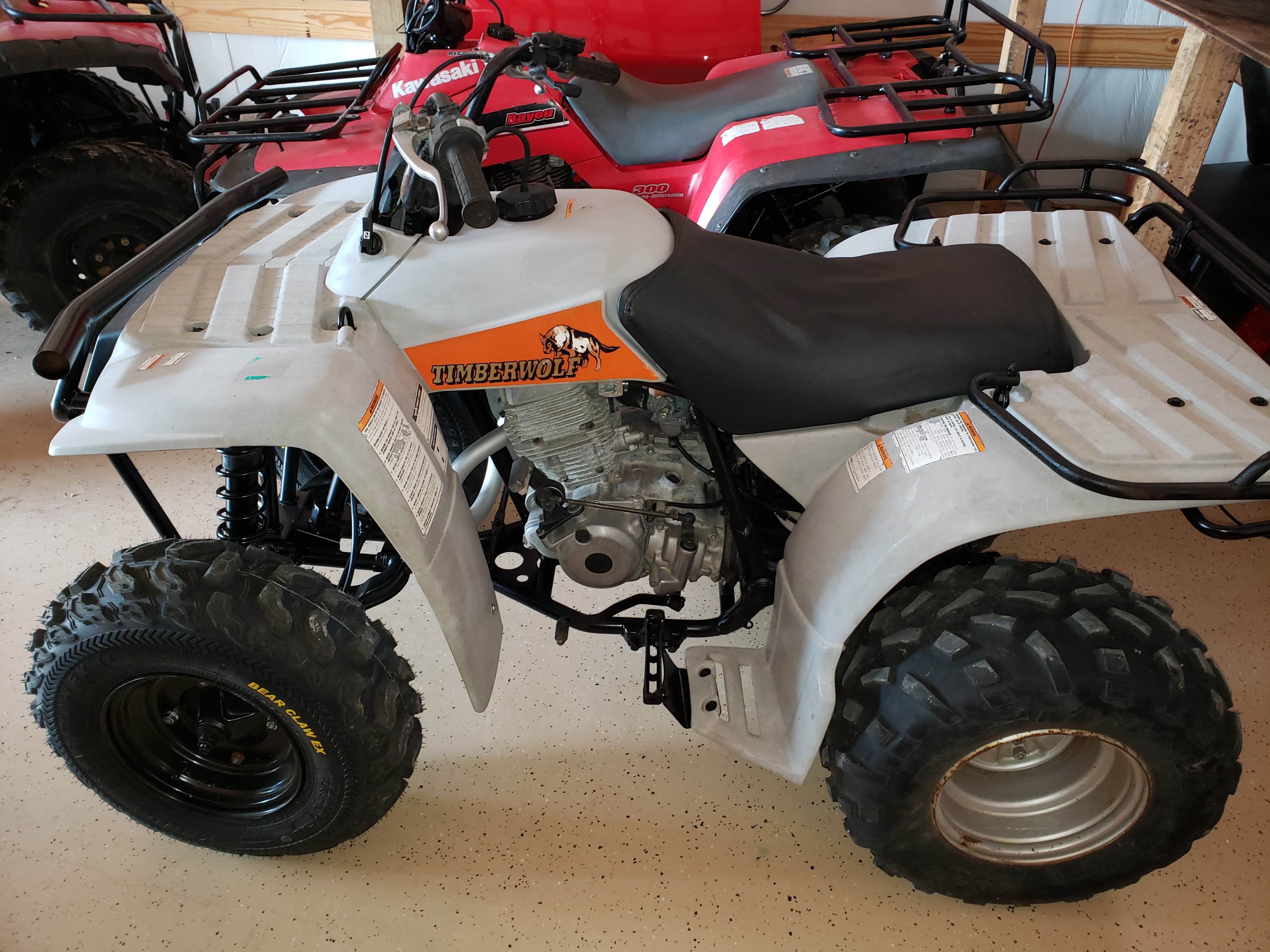

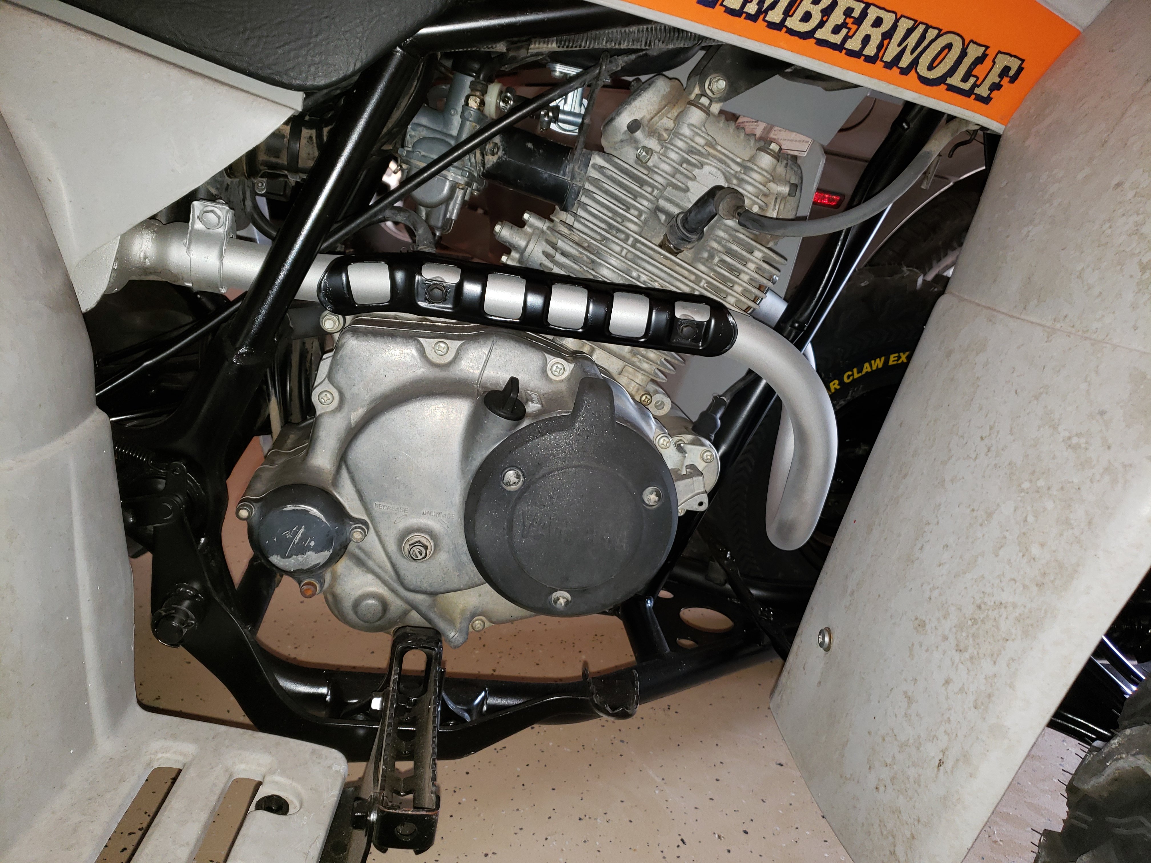

The TImberWolf looks really fun, and is actually in great shape. I got it to spin over with a jump
So that's a good start. Needs some tires and tlc but gonna be a quick one for sure.
Takes a lot of cleaning, usually pull everything apart and go from there but they usually clean up nice.

That’s a good price range to go off of.  I have a max of $500 when buying.  Hopefully that bayou is not burnt up  due to the wires being backwards.  I’ve never seen that color pattern on a bayou either.
I’m really hoping they both only need a good tare  down and cleansing of the carbs and that’s it.   What’s with the seat for the bayou did it come with the bike? I don’t see it.

Yea it came with the seat but was off and did not want it to blow out of the truck
so I had it inside.  I don't know whats up with people wiring batteries backwards.
The Bayou 300 I have was wired the positive and bolted it to ground! People just dont
pay attention. Thank god most batteries are dead when I get them.

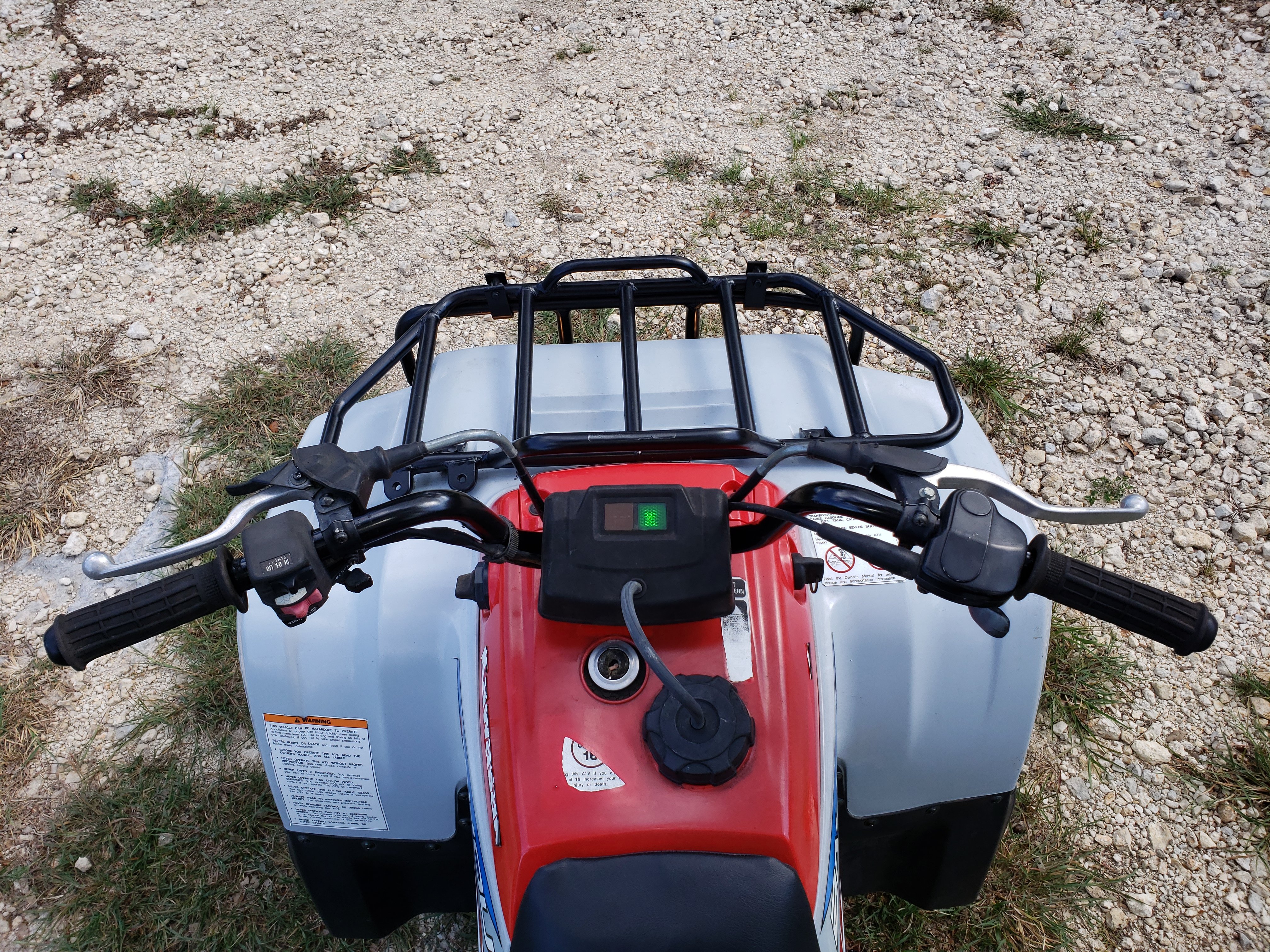

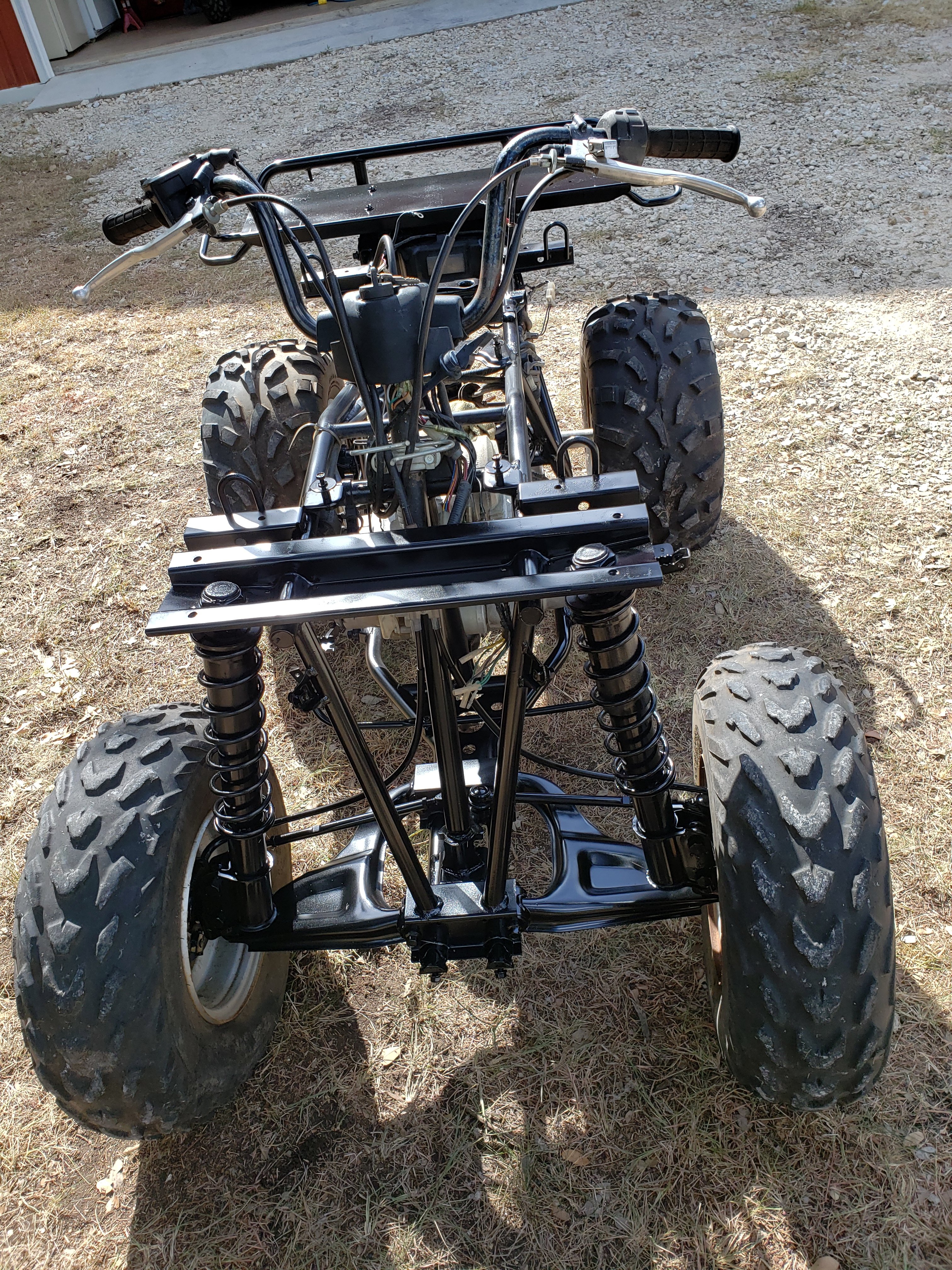

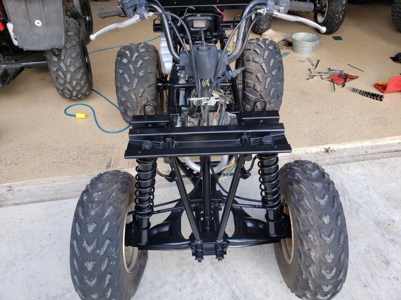

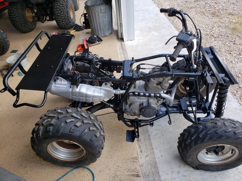

Started tearing it apart, pulled the carb to rebuild, removed exhaust, battery, fenders etc.
cleaned it up pretty good, did some painting, reinstalled exhaust, carb, other accessories and
got it to fire up. Runs pretty good. Ordered me a seat cover, battery and front tires and a petcock.
few more pics after. Will post finished pics when done.  Next will be the Bayou 220 Az

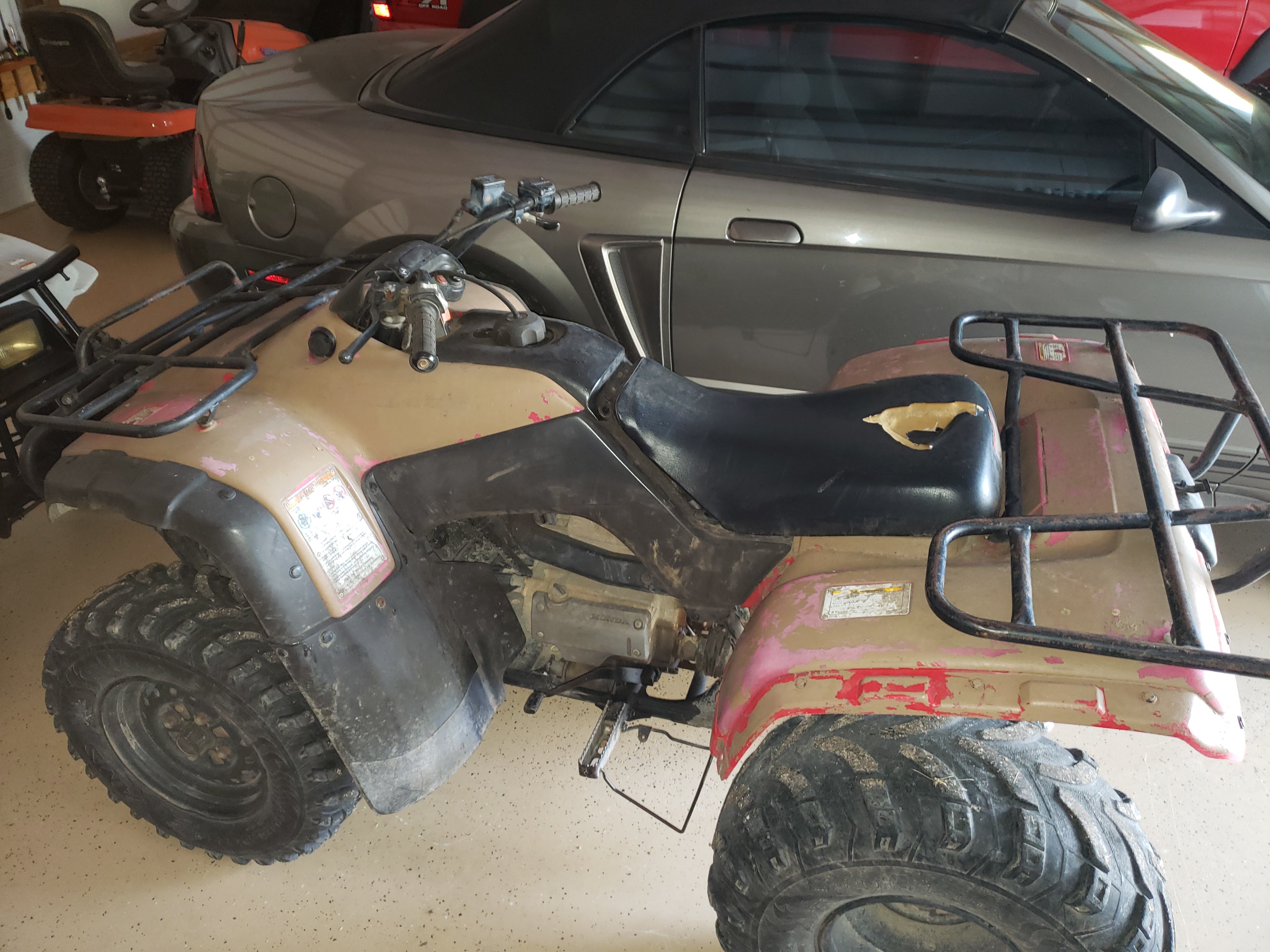

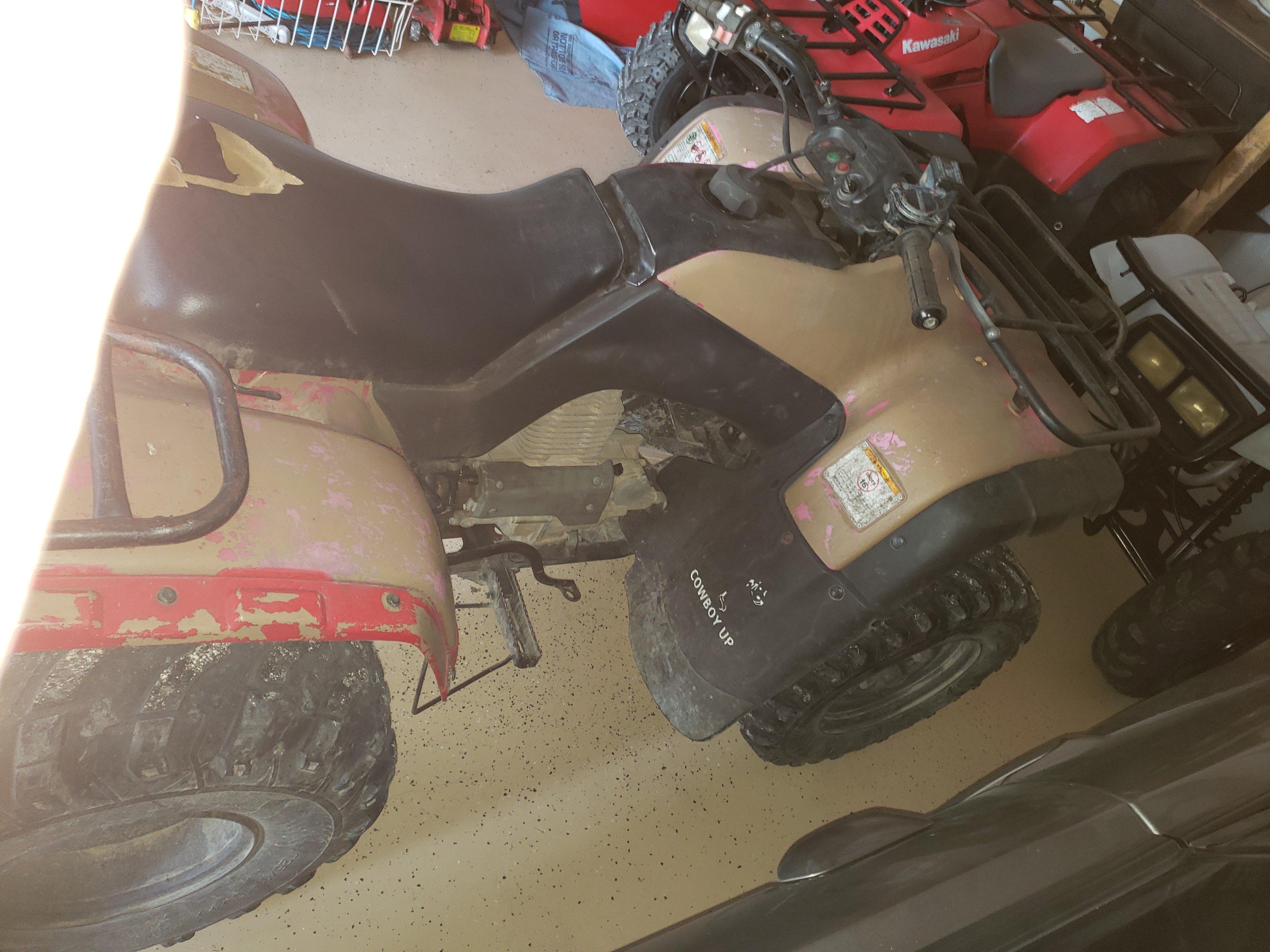

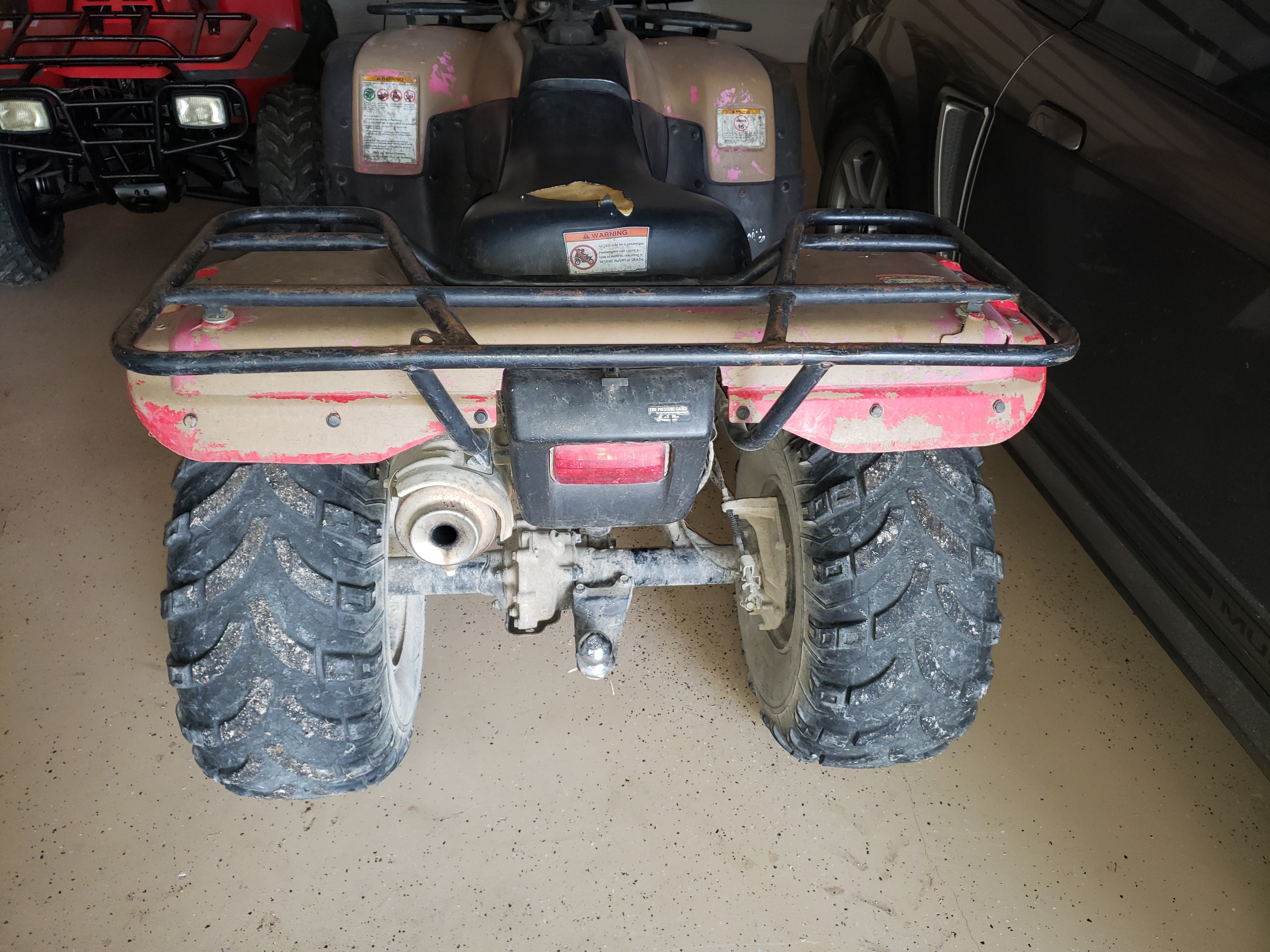

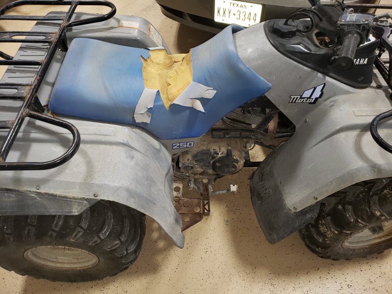

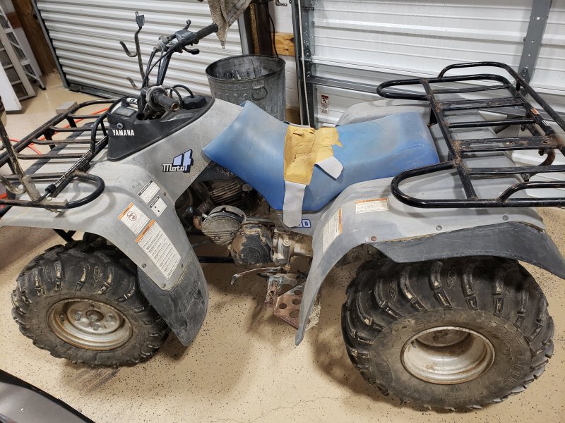

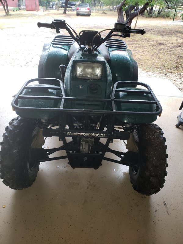

Well yesterday went shopping, found this 02 Honda, pretty dirty but in perfect working order except
for rear brakes and maybe some brake cable and tlc needed. Starts right up and runs pretty good.
Ended trading for a .22 that I paid nothing for and a C-note.
So I sold the Moto 4 a few weeks ago, did good on the profit.

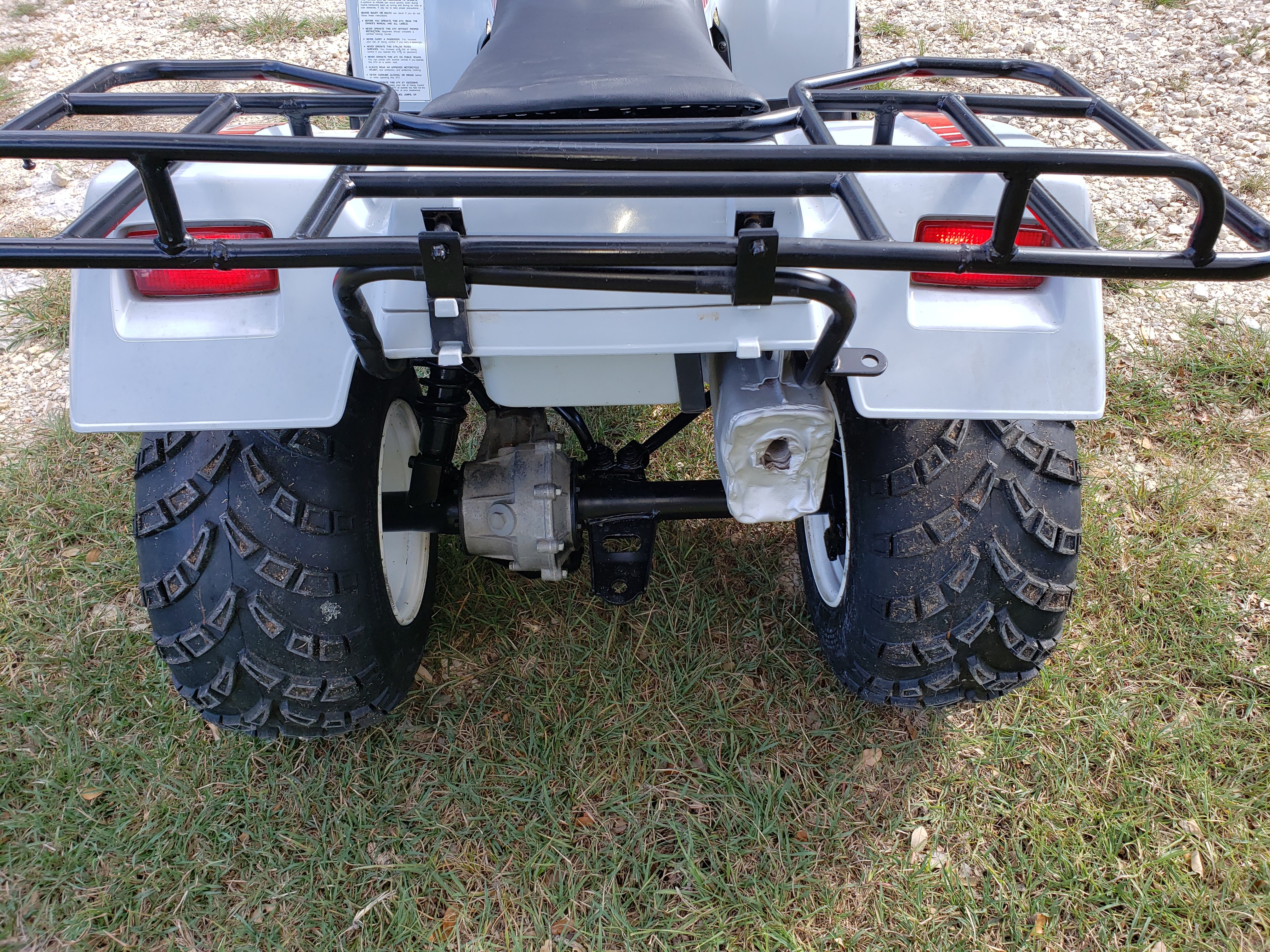

Today I Sold the TimberWolf, Man that thing was a blast to ride, wheelie city!

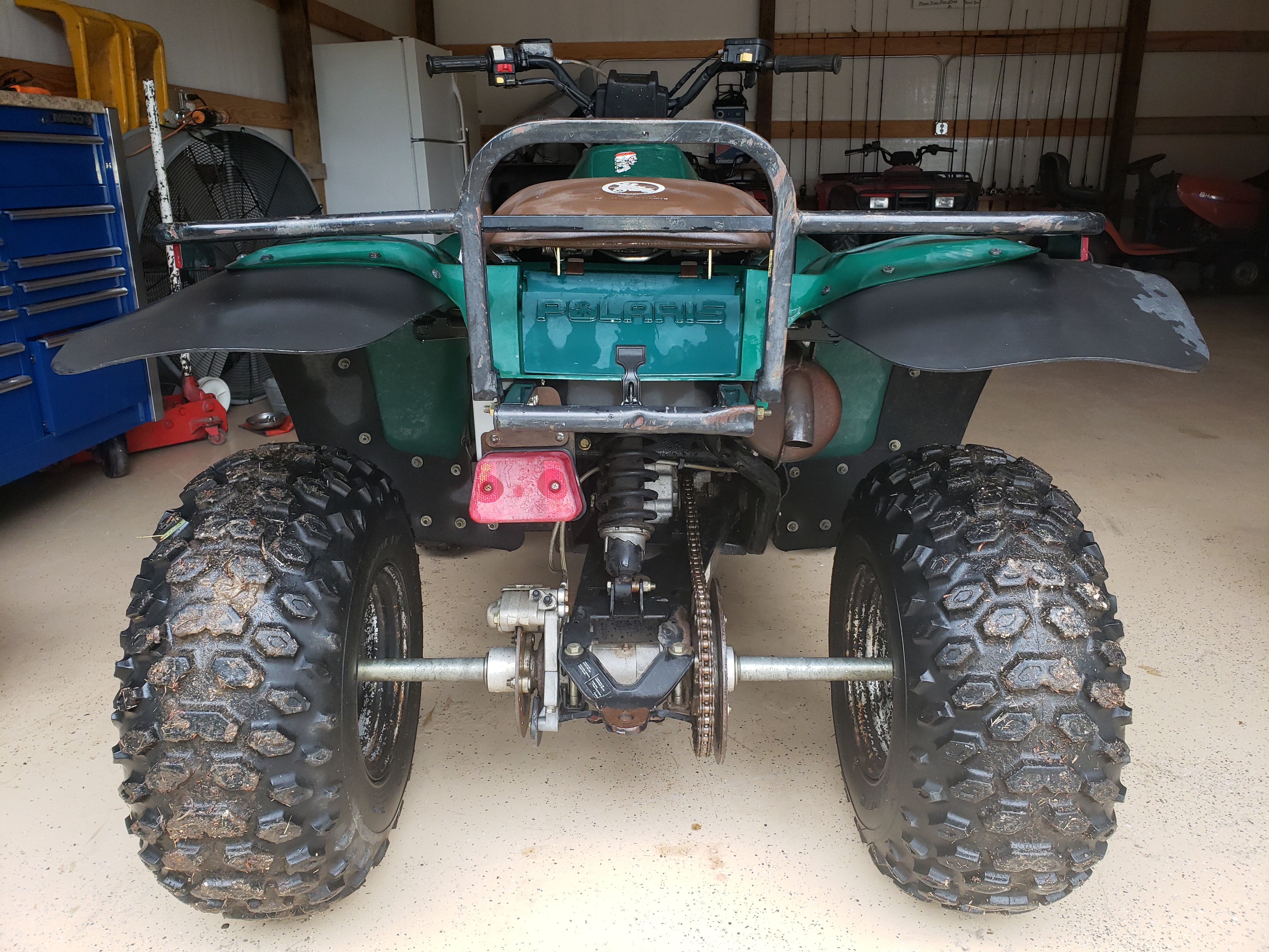

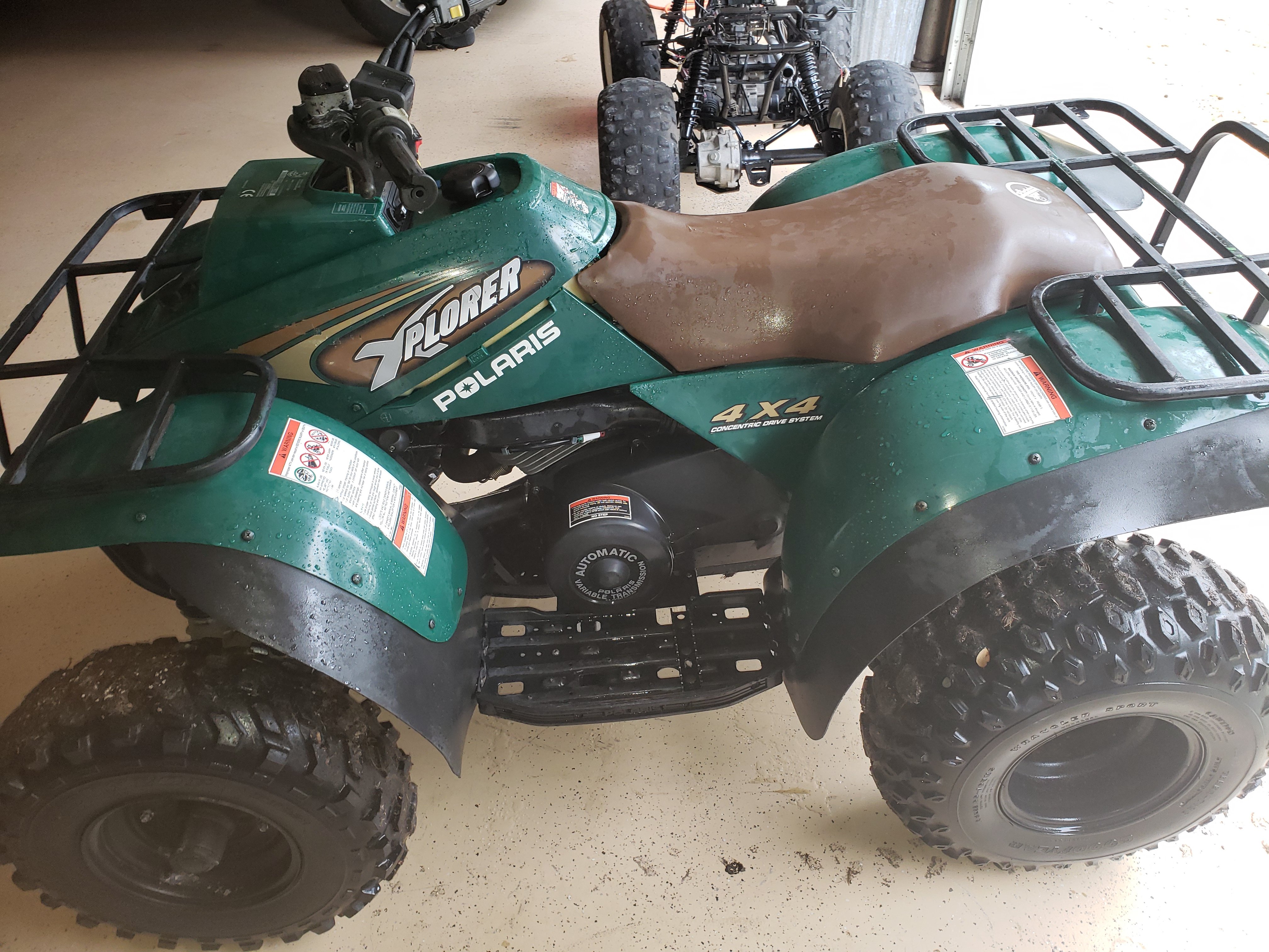

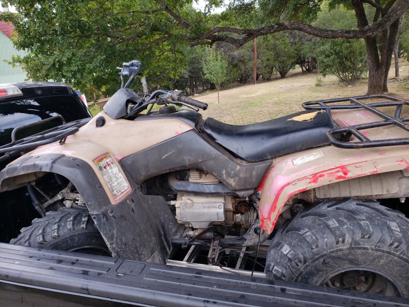

Get this I ended up trading it for a 01 Polaris Explorer 4x4. and he also gave me 900.00
Catch is he blew the motor. I pulled the pull cord and no compression. He said it got super hot
and would not turn off with the key. I assume it was dieseling off the 2 stroke oil, any way he said some
thing flew out the tail pipe (Yea probably the top of the piston) and wont start now. So its on the back burner
while I finish the 220. Couple of pics. Some of the Timberwolf and the rest of the Polaris. Stay Tuned lol Az.

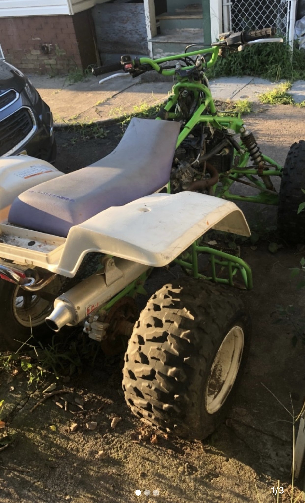

Look at this Mojave, I wanted to buy it for parts for the one I just rebuilt. I needed the air off of it and some nonsense parts as well as maybe taking that cdi for stock. He was firm on $300. I told him $100 bucks to take it away. He told me I was crazy. I said nobody is going to take it for that price! It’s buried in weeds and missing a lot of stuff.
So I said $150. He said nope  so I walked away. He has messaged me 10 times now for $150 he said he has to get it out of his yard. The last message he sent was $100 will be fine. Unfortunately I made my own air filter set up and no longer need the parts.  Some people think that they have gold!!!

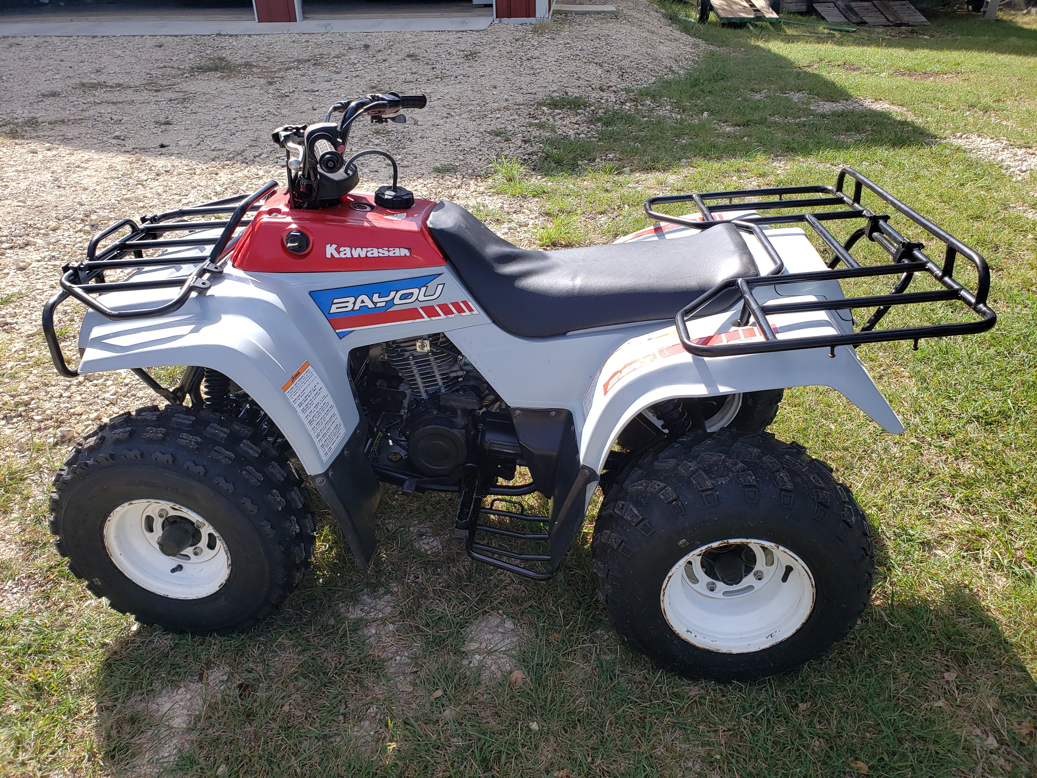

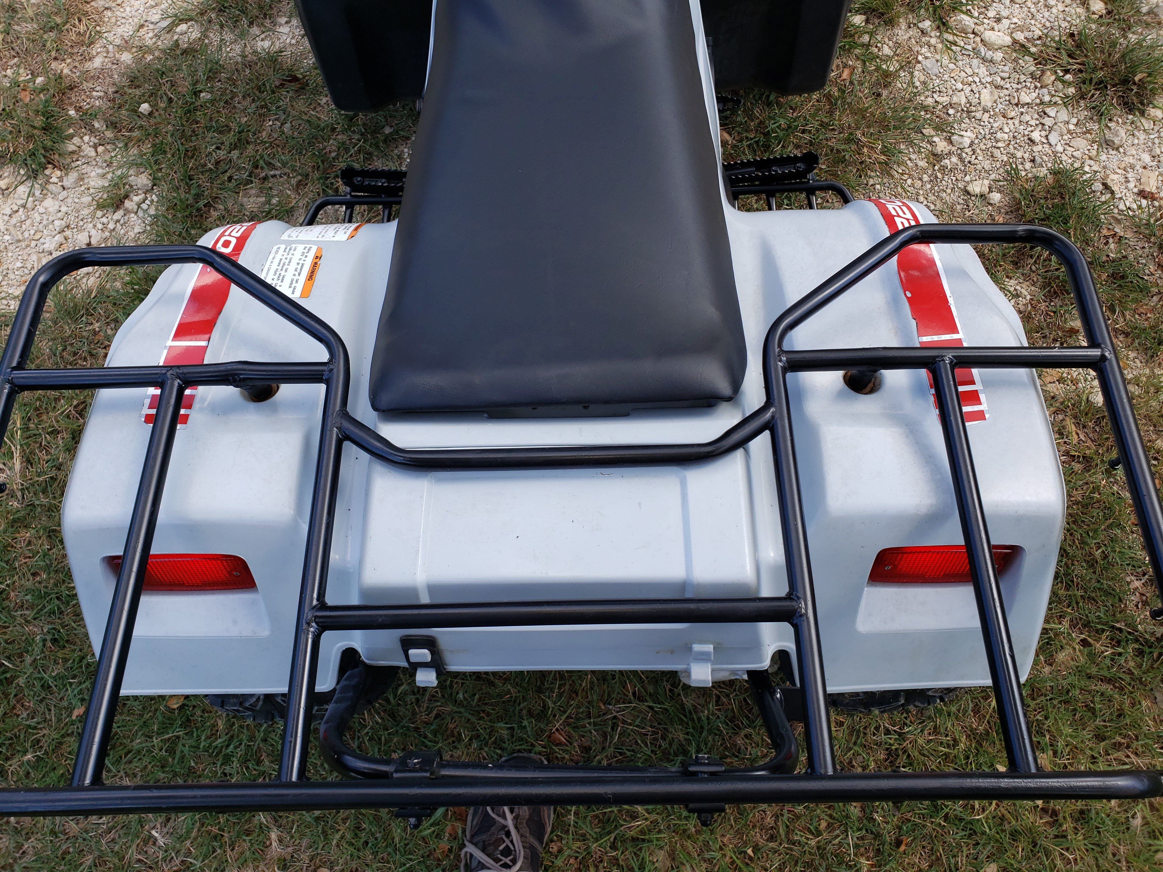

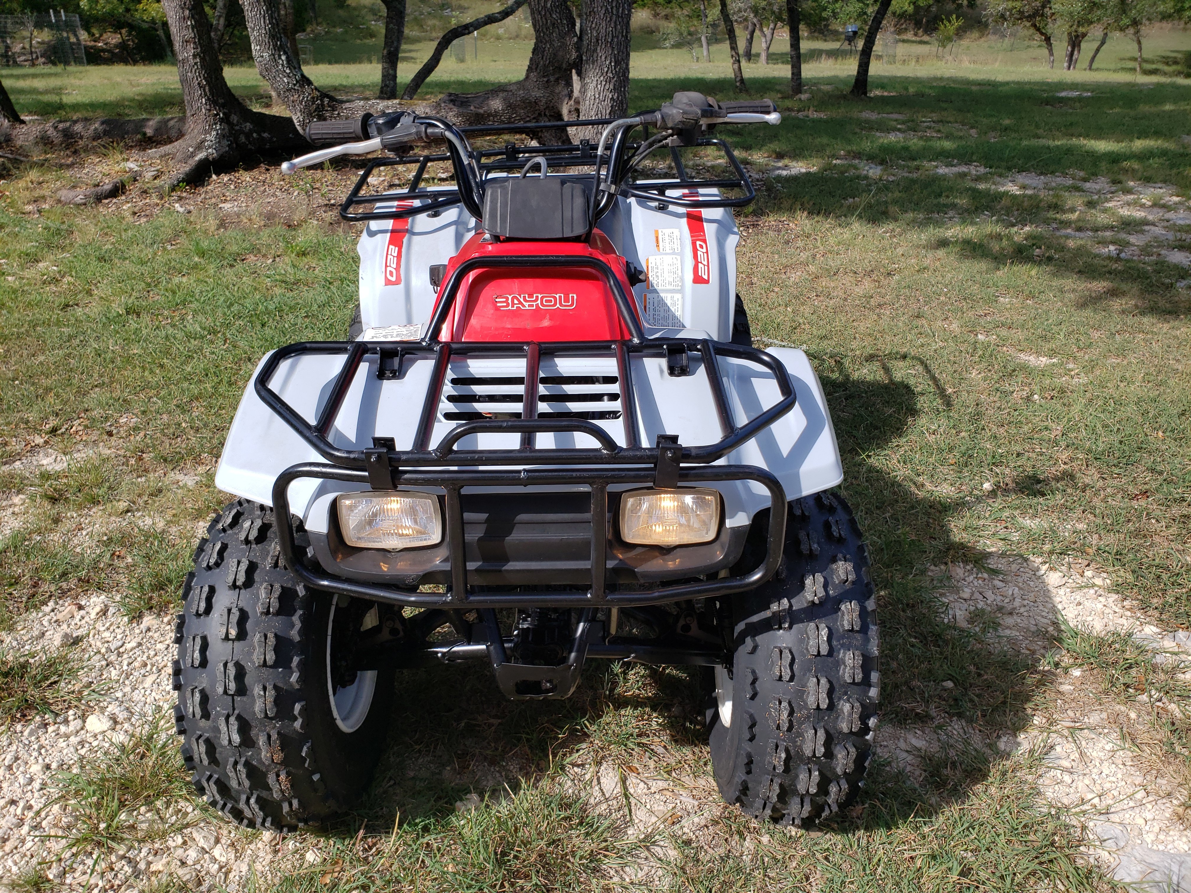

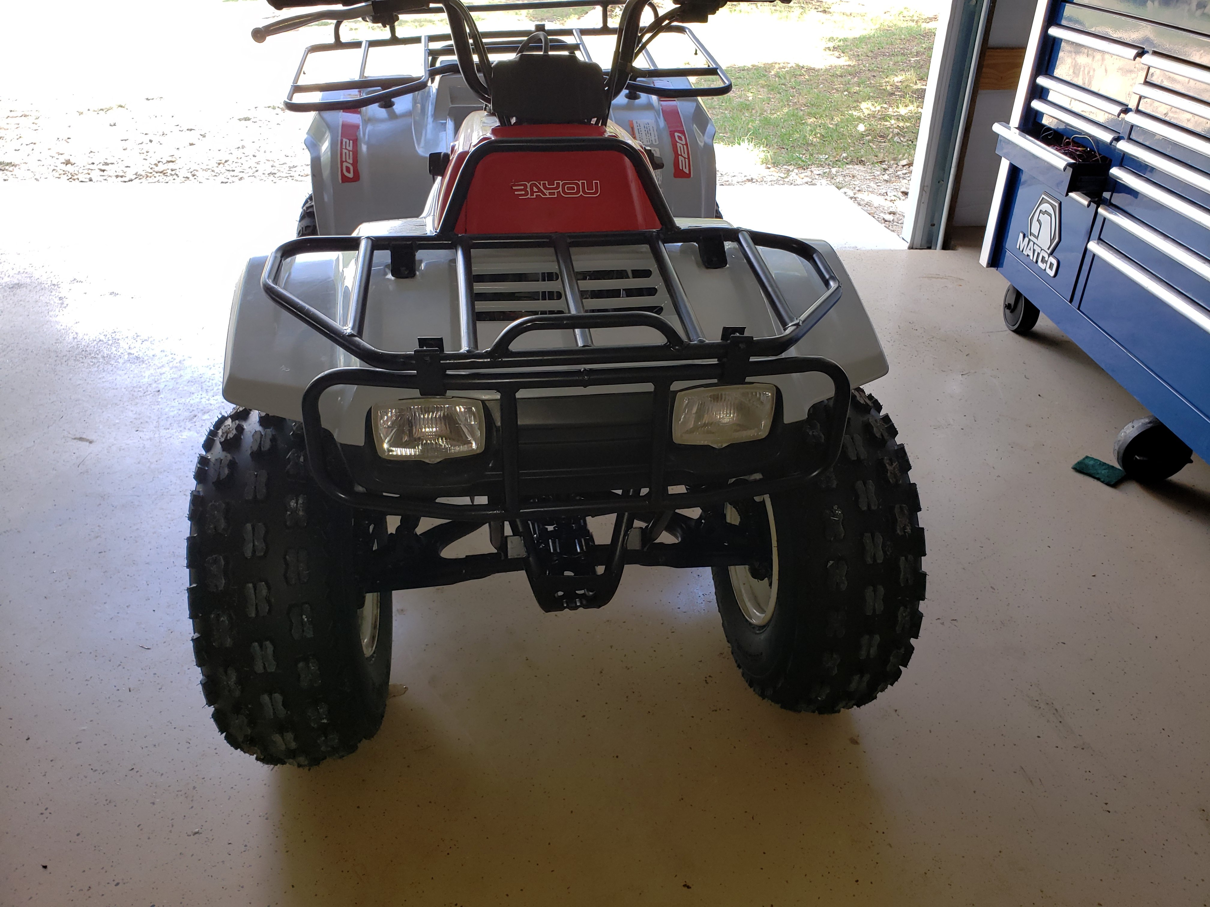

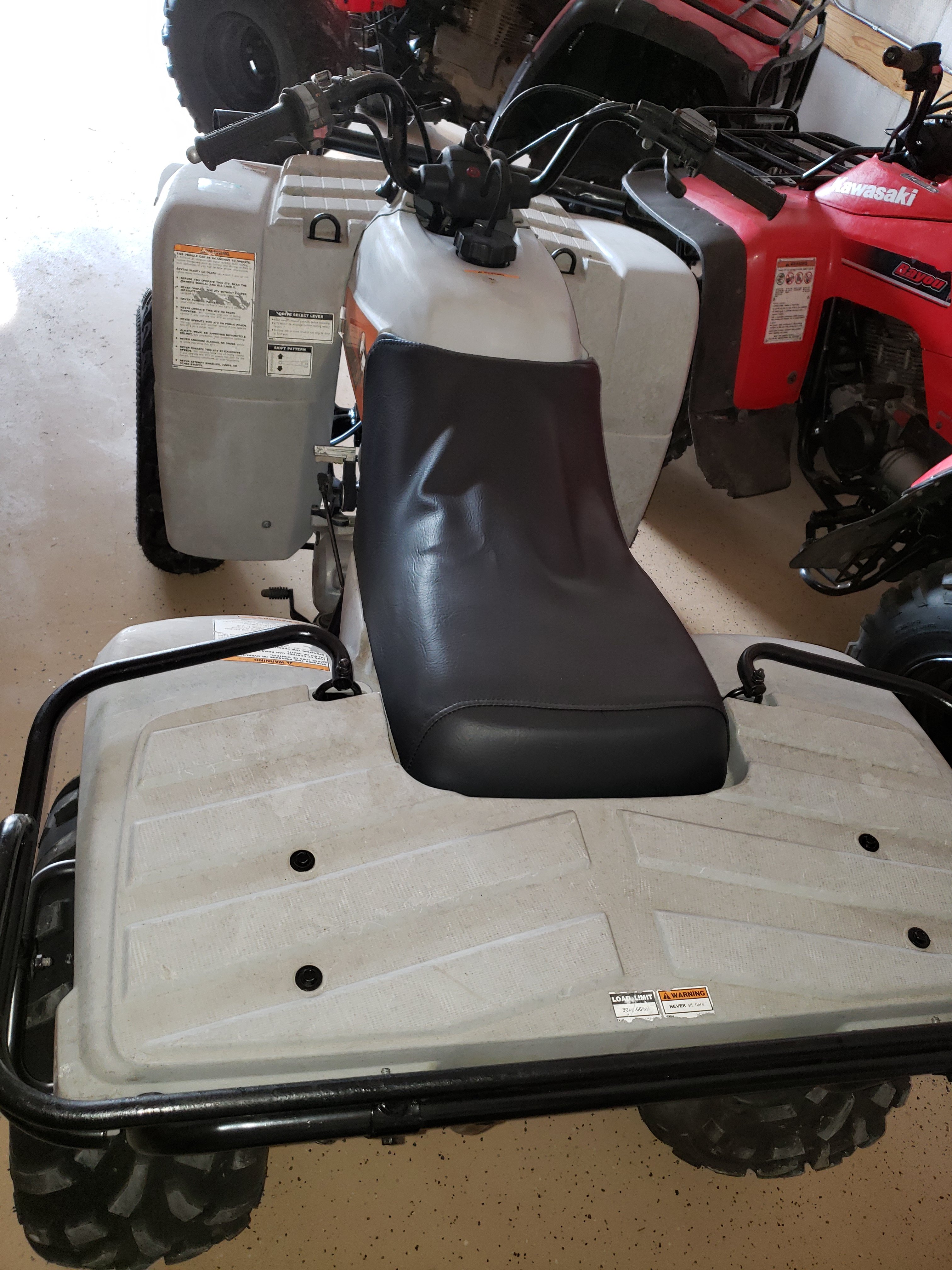

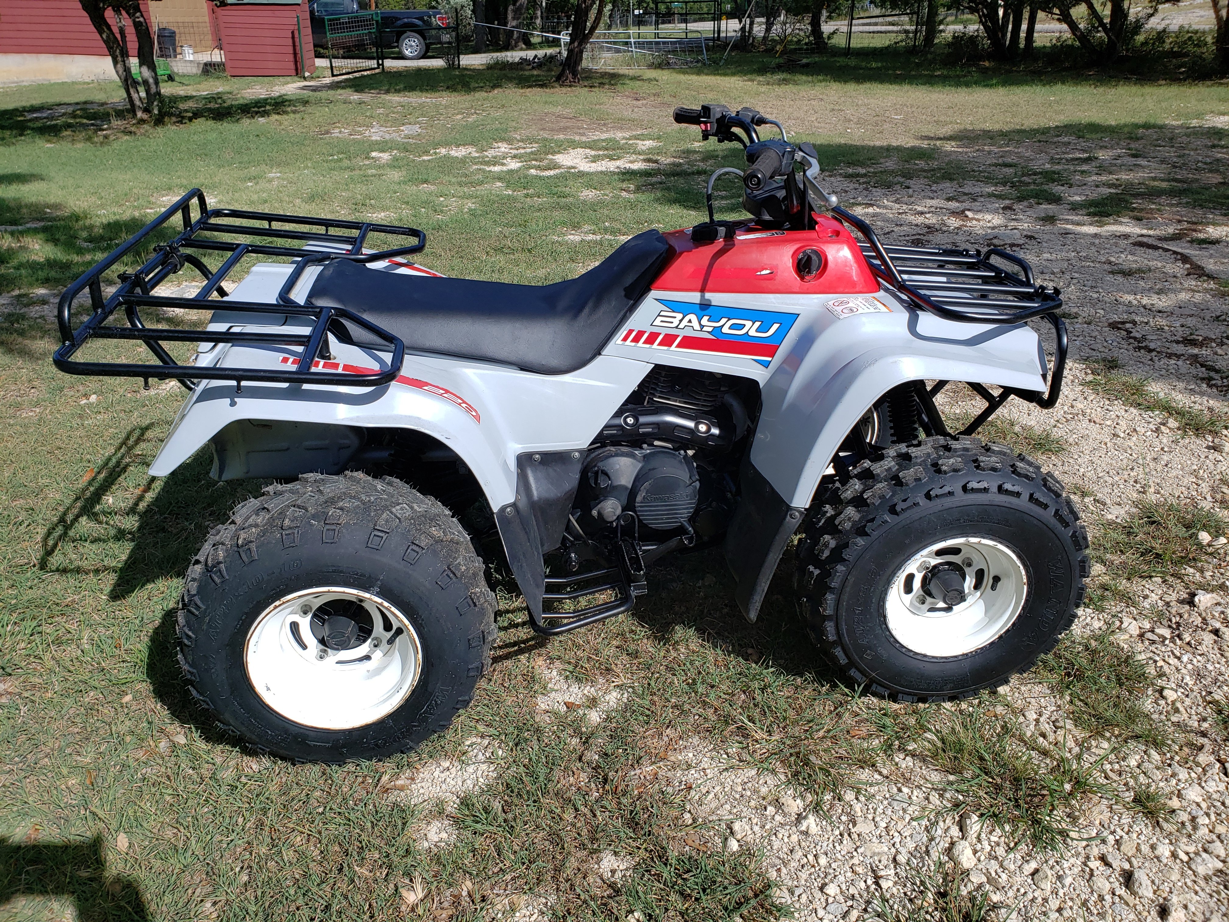

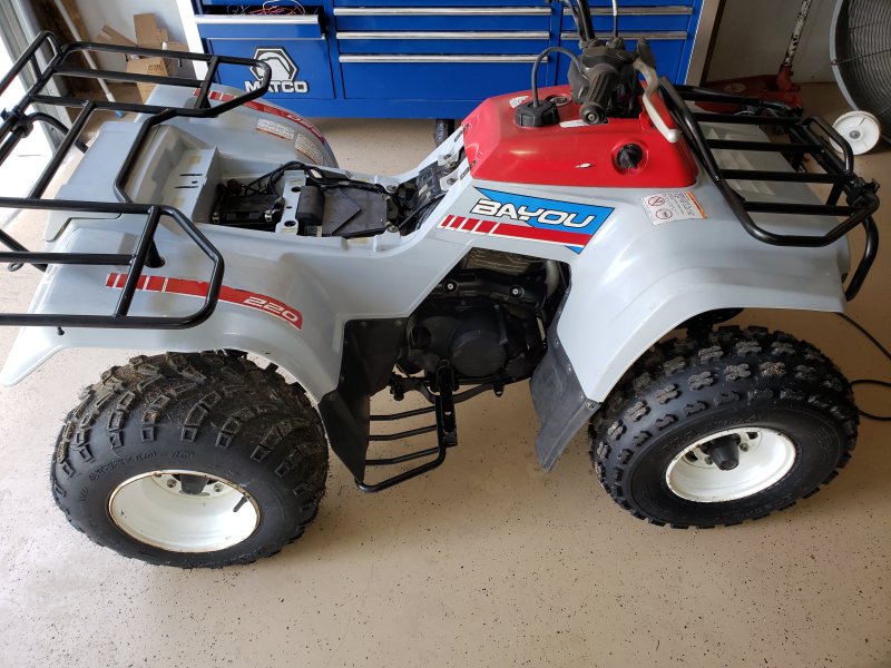

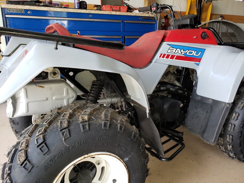

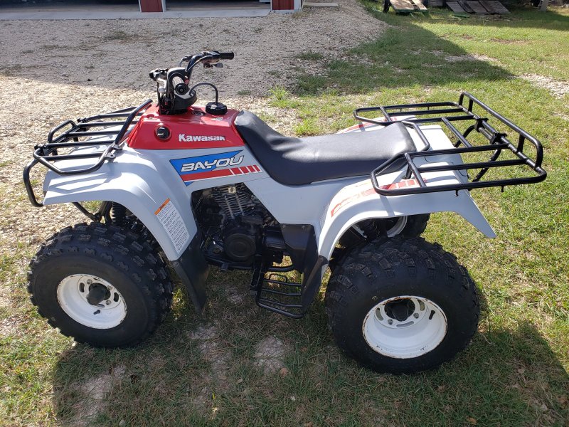

Ok, so the Bayou 220 is done and gonna post for sale. Couple of pics. Gotta love that old nasty seat lol.
That's the best I could do with that beat to hell muffler. Must have flipped it at one time. Az
1350.00 But probably end up around 1150 or so. Just put it up and someone wants it for 1000
I think I will wait and see what it brings. That thing is super clean and runs really good. Az
