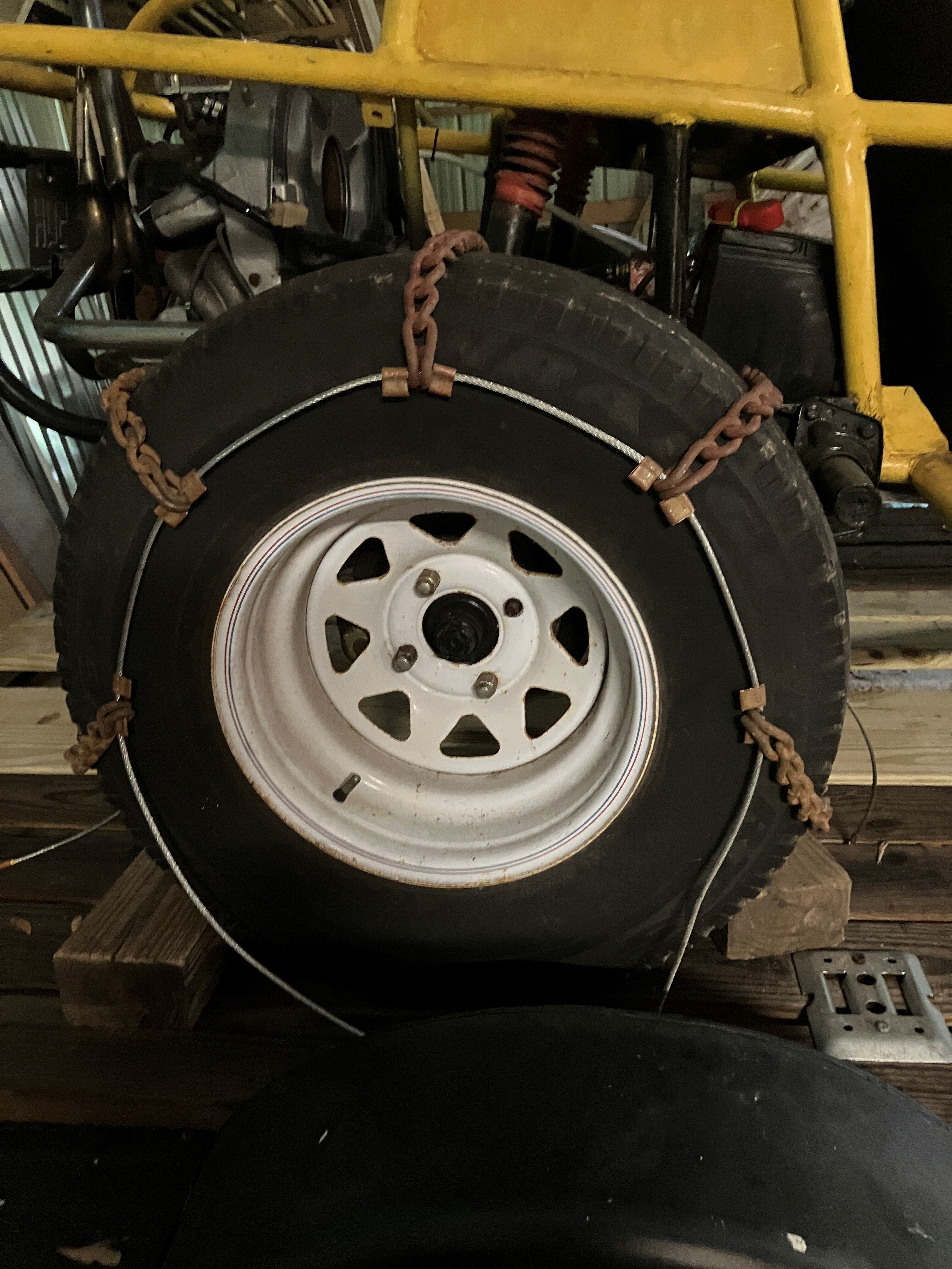

Here is my homemade wheel Bonnets.  A friend gave me a bunch of old snow chain cross chains.  3/16 in steel cable for side straps.  I  crimped on 1/2 CU tubing to keep chains from sliding along steel cable.  working on best tightening system now.   The tire shown is a 15 inch on my sand rail.  Should easily fit my SXS tires also.

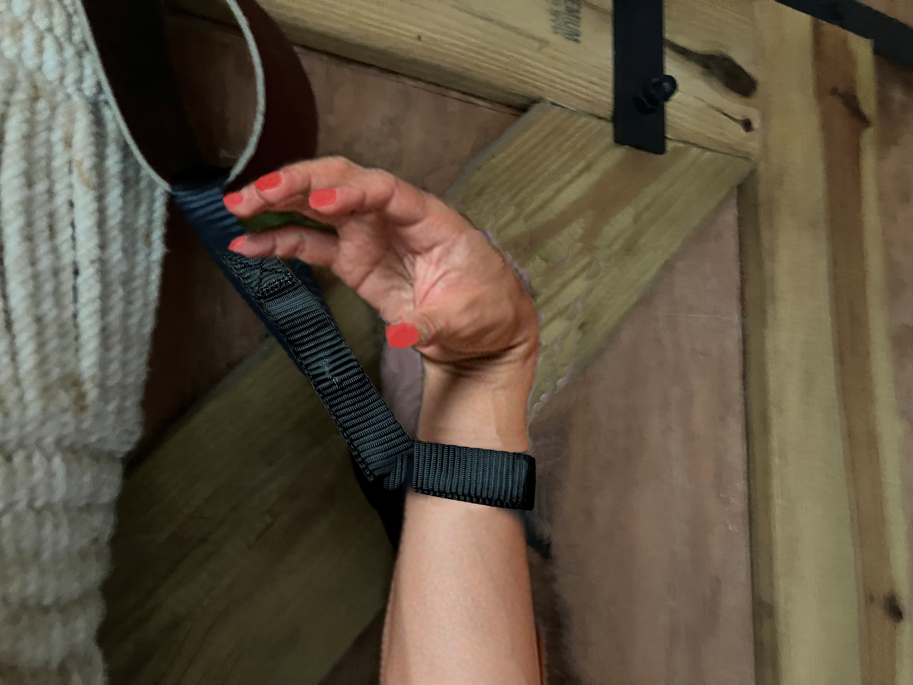

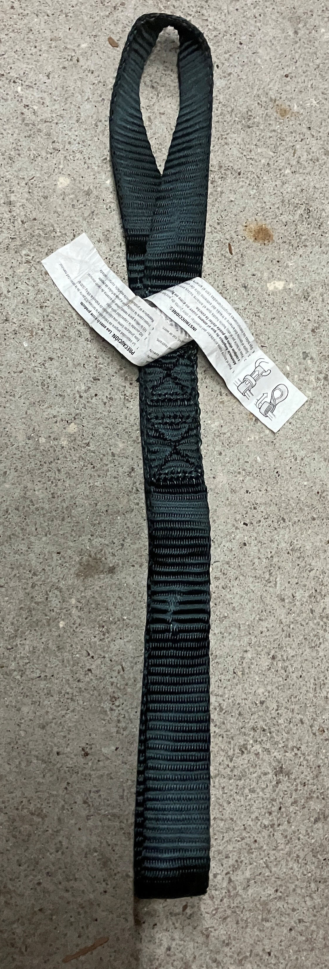

BTW...for tender sufaces that you don't want marred i have soft nylon motorcycle tie downs.  They are rated in Lbs  ,600 lbs i think, and have a sewn loop so it can quickly be looped around something and be secure.  the p-other end has just a straight loop. Herewith is a picture of a 12 inch strap.

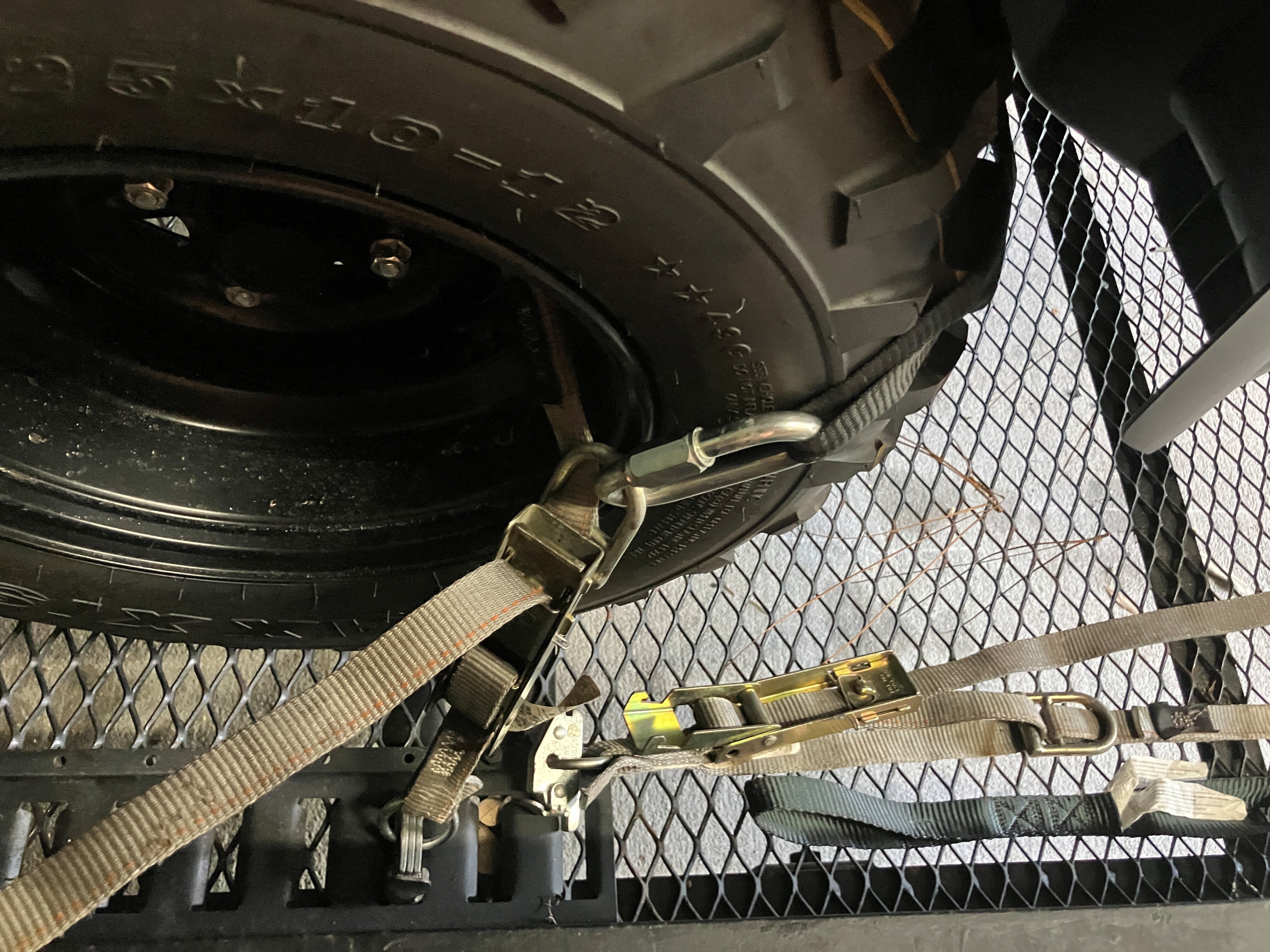

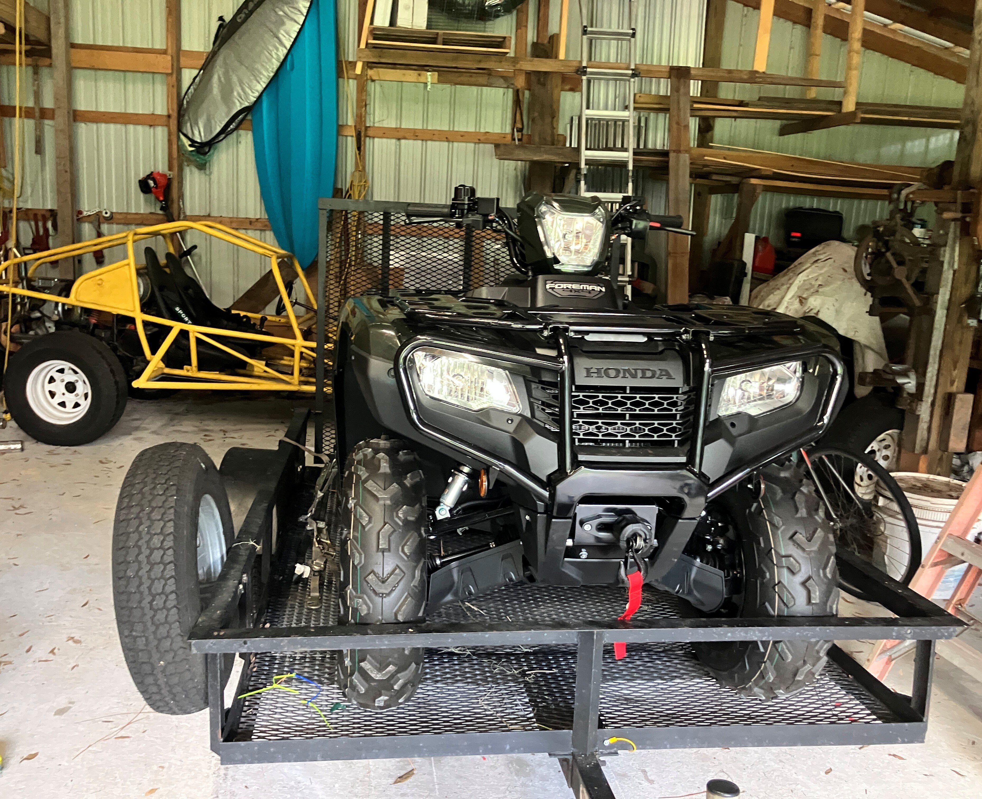

Transporting about 1K miles. using small trailer behind my Highlander.  Using Over center tensioning straps aroud rear wheelswill use ATV wench to hold front down/ up against trailer rail...  Saying good bye to my surf board ...😢 and my Sandrail
I use "soft Straps" to tie down the wheel tension straps shown.  The soft straps are very versatile and will not scuff paint and damage tender surfaces.
  The straps have sewn in loops at one end to ease strap pressure on frame members.

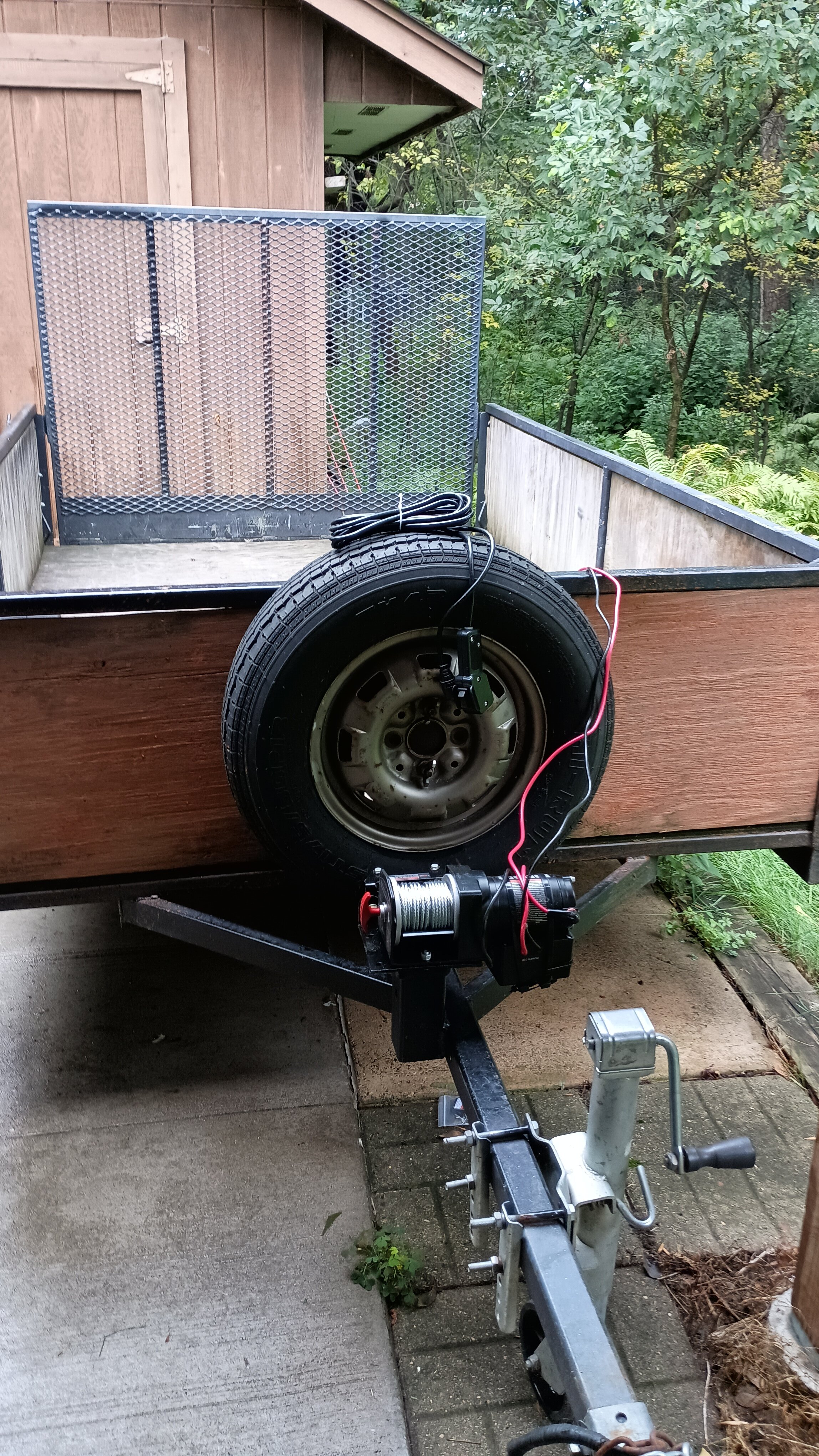

Yes I agree with your concept of triangular braced tongue, as I welded onto my 5 x 8 light duty homemade trailer as shown.  I also added a light duty battery operated winch to load any stubborn materials.  (Remove spare tire to access the cable opening,).  The winch has wireless control for actually sitting on the atv or motorcycle while it is being winched into the trailer.  As with your trailer this is the perfect size for atv moving as well as general purpose.
I have another 6 x 12 single axle 3500 lb open top trailer that I use for heavier equipment.
Yes, the angles do improve tongue stability.  I used 1" x 2" steel tubing, not sure of the gauge.  I'm sure there are professional welders in our group who would offer advice.

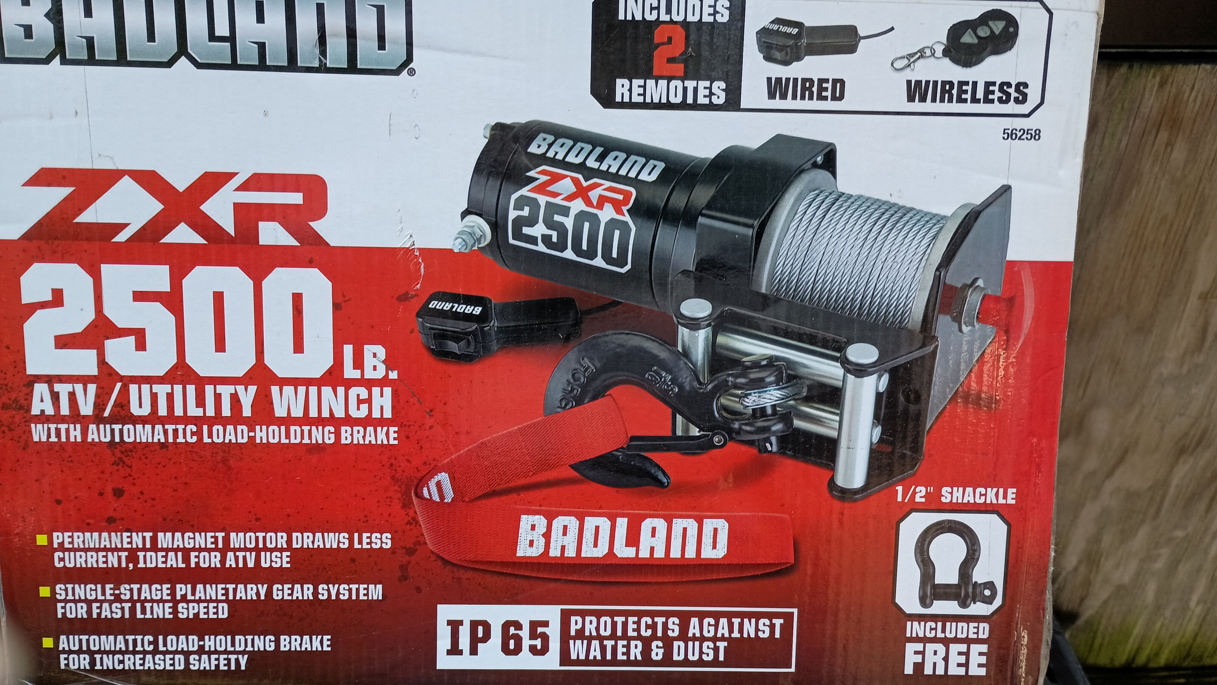

the winch was an inexpensive $79 Harbor Freight but I really like the wired/wireless feature.
Box tubing 1 x 2 nice if you can miter the ends good.  That would probably  be a chalene for me...LOL   But I can cut the 2 x 3 x 3/16 angle easily..Plus I have that.

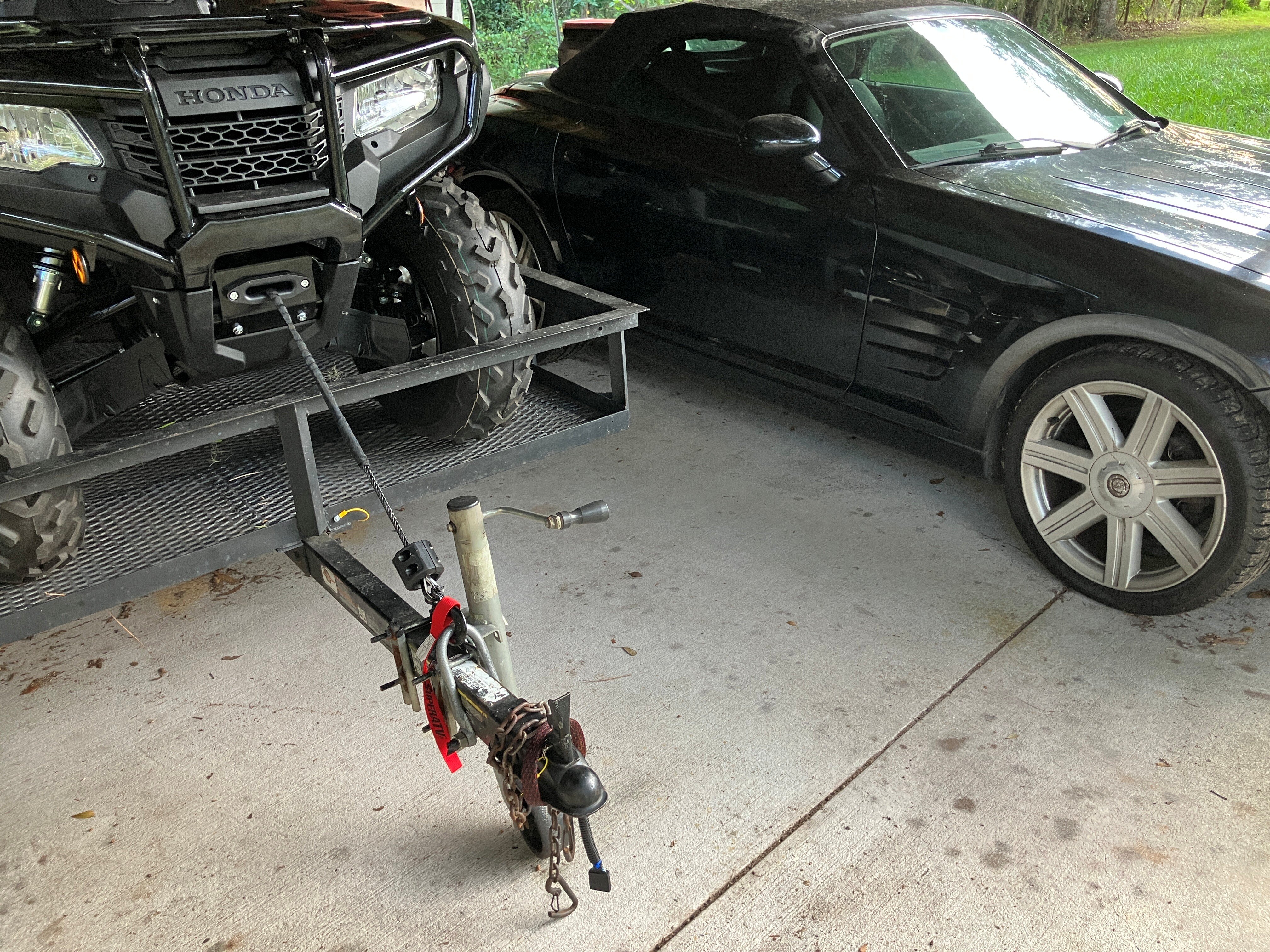

Use winch to anchor front.   No pull down tension so ATV suspension is still functioning as it is on trailer. rear wheels strapped to hold ATV down and forward.   also a rear anchor so atv could not go forward in a hard stop.
Saying goodbye to my little coupe.  don't get to drive him much lately
Good use of winch as front anchor, I do the same with some tension.  Your new Honda is really a robust machine.  I'm very impressed with the reliability of Honda ATV's.

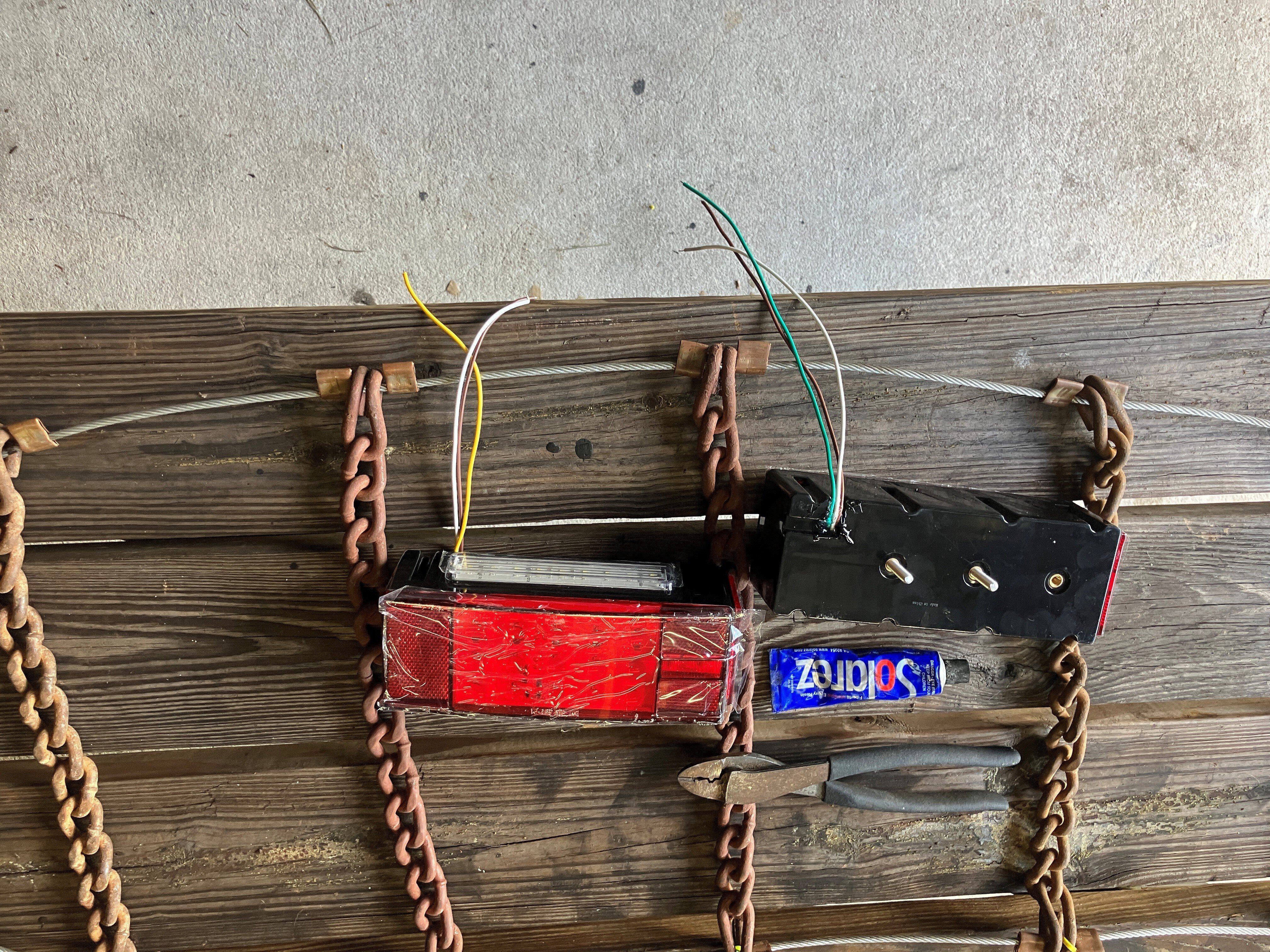

Water proofing replacement trailer lights.  I sealed the wiring hole  in the new lights with "Solarez"  epoxy.  It is a one part epoxy.   It only needs to be exposed to direct sunlight to activate for two (2) minutes to harden.  Also I have had this tube and used it several times over last year or so and is remains good when stored for long time.
New replacement trailer lights came with a Center Brake light.  That's nice  the more who can see my little tail end the better.
However following instructions with kit the center light comes on with Brakes very bright,  lower illumination with running kights. However, the center light comes on also with the RIGHT turn light and does not come on with left turn..

Trailer harness use the 4 pin connector?
You have a short between green and brown wire
The instruction show connecting the "bright" center brke light to the Right "bright " brake light,  S yes it will blink with the Right turn light as wellas when Brakes are applied.
I have electric brakes (7pin connector) so i could wire it to the brake circuit...Duh never thought about that...
