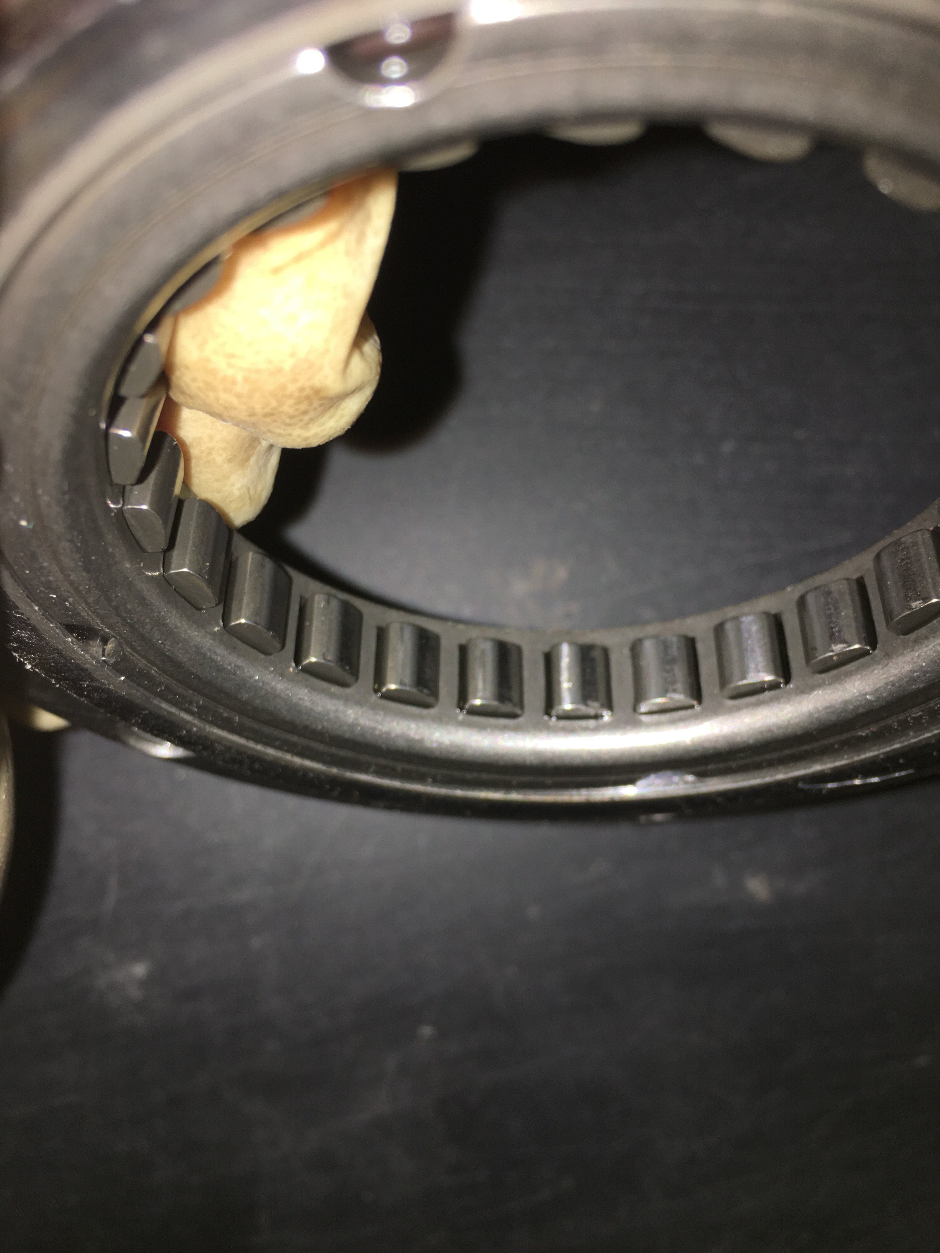

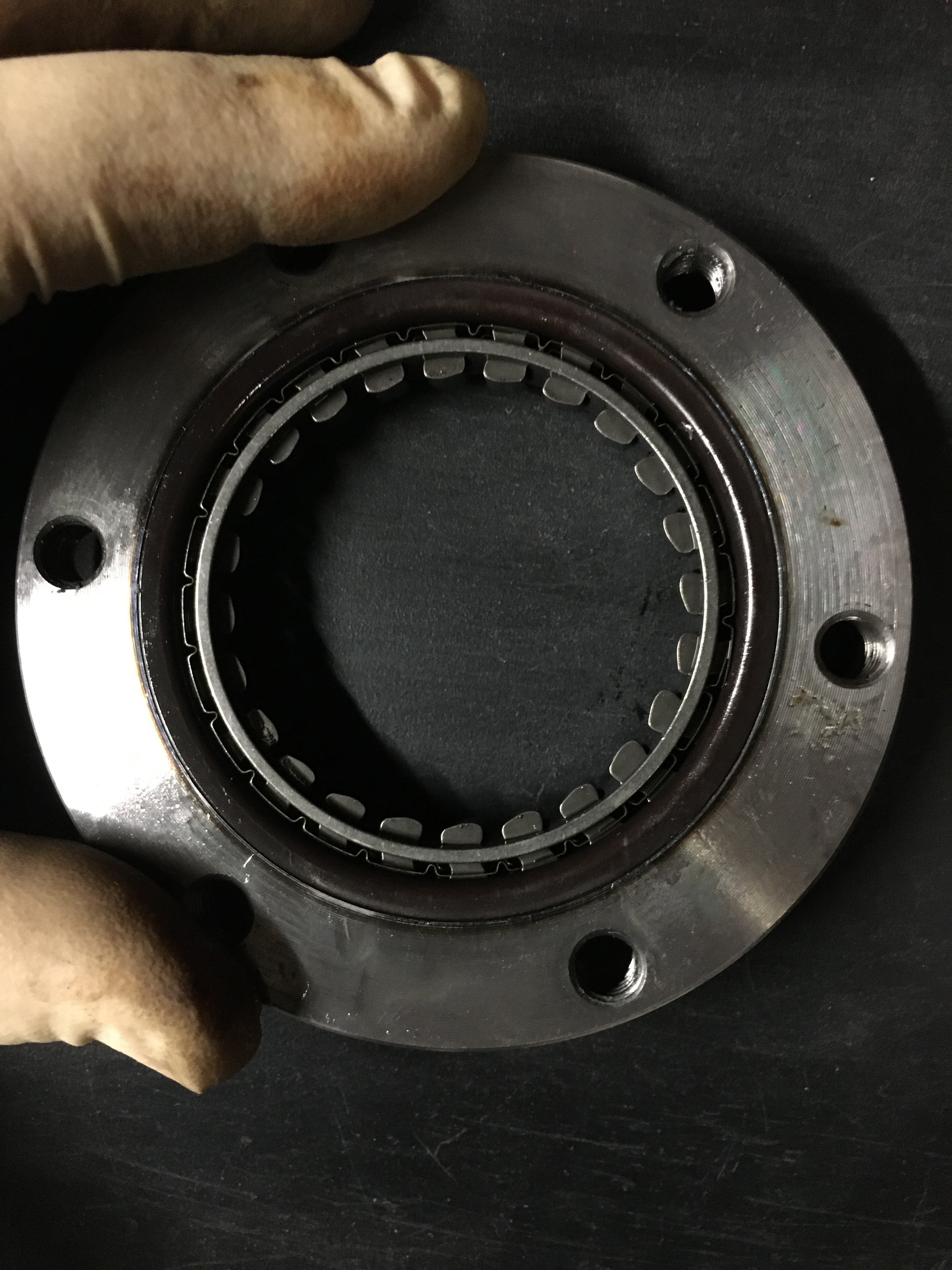

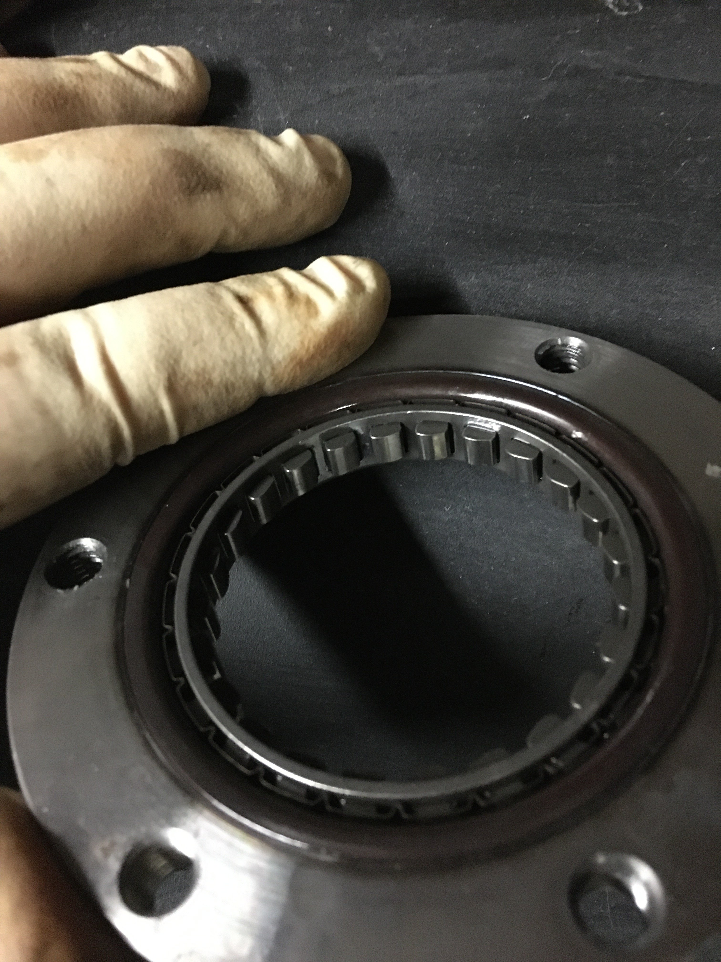

Figured I’d replace the bearing now than in the winter if it goes. Replaced the oil pump chain but the old one and new had same amount of play so probably didn’t need to do that....
Got the flywheel off and couldn’t find my 6mm allen socket to take off the bearing, so ran to Lowes and bought a metric set. Go it off and went to put the new one on and realized it’s wrong! I must have messed up in my searching on eBay and bought the wrong one. Cleaned the old one and reinstalled. Put it back together and fired up after cranking for a bit after messing with the choke, almost like timing off but then started. Still need to put antifreeze in it, no way to do it without disconnecting coolant hoses.
I cleaned the bearing and inspected. We’ll see how long it lasts. At first when it wouldn’t start I thought maybe I messed something up. I’ll get back at it tomorrow hopefully.
So didn't last long at all, started doing the same thing. I've been waiting for part from Rocky Mountain for a week. Have to take it all apart again and replace that starter clutch. I also ordered a new battery from batteryclerk.com. Got it in 2 days.
