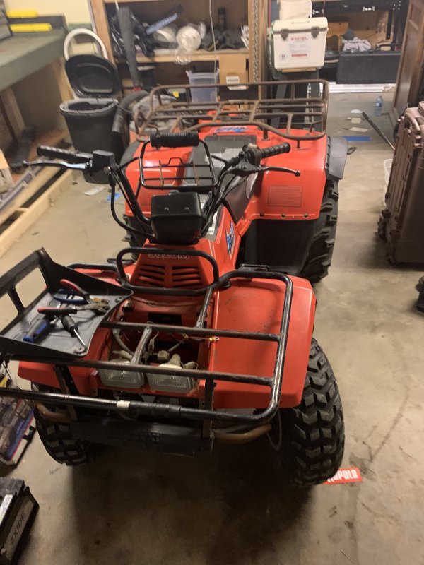

Hey there! New guy here! So I bought an 87 250. I turn the key and it has ignition light. I press run and the engine turns over. Guy I bought it from said the carbs may need cleaning, I worked them good cleaned and blown out. I reinstalled the carb and still doing the same thing. It’s getting fuel, the battery is brand new and charged I’m lost here!( purchased a new carb on its way) anyone have any ideas
After you turn it over a bit, does the plug get wet with fuel?  If there is fuel in the bowl and spark, then the issue could be timing is off (could be sparking at the wrong time), valves could be tight or loose, flywheel keyway could be sheared.
I'd start with checking timing to make sure it's spot on at TDC, then hit it with a touch of ether and see if it'll bust.  If it does, then it's a fuel delivery issue.  Have to go back into the carb and check the jets as there could be an obstruction.  If it doesn't at least try to bust on ether then i'd look at compression.  Could be that it has too little to run due to stuck or worn rings.
That thing is beautiful for an 87, what a find!
