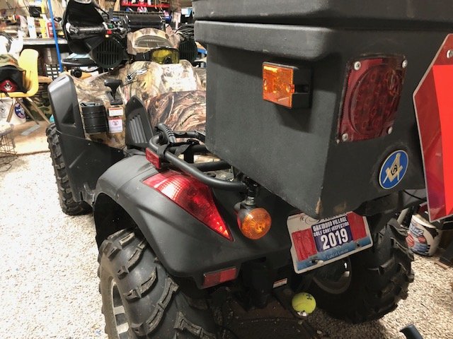

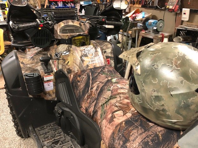

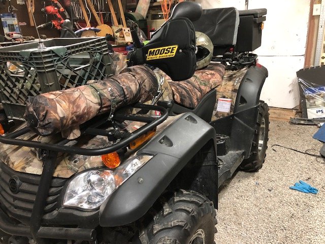

i am sure some one has switched from the dinky battery to a larger car car battery, so any advice? ive got enough bits and bobs on my atv that i feel i need to step up, i keep a float charger on it but i left it unplugged for about a week and it was dead and it a fairly new battery from advance auto, im probably gonna add a cb radio in the future and i think the only thin that has a constant draw is the clock in the dash and the memory for the stereo
2012 cf moto x5 500 lwb

Wife wanted a radio so we got a radio, now she wants a sort of soft top so she wont get sunburned damn redheads, i want electronic toys but running out of room in front trying to keep rain and snow out of it

wife is sorta tired of sitting behind me and her hints lean to a side by side but there is no sxs money here, cheaper to cut up a tracker or a vitara 4dr, already street legal with options just have to waterproof everything and have room for my dog. the cfmoto is on 2nd battery i think from advance, lawn tractor battery is bigger as was car battery so my obvious thought was bigger is better, thought somehow you would do like a car, get a higher output alternator, i see pics of rigs loaded like crazy and wonder how. we mostly run around in town and go north to trail ride

right now about the only thing we will be running is the stereo, my cb, i have a hand held baofeng but will probable be adding a led flood light, oh and my wifes 12 volt electric blanket girl is always cold and i am hot
