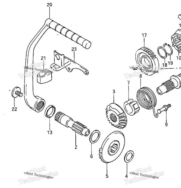

Thanks Mech but the kick start lever on this quad isn't the two piece type you reference above. It's one solid piece and is supposed to be pushed out away from the engine slightly, staying in that position allowing you to put your foot on it and kick which starts the engine. I'm having the exact same problem as Joshua91673 where it won't stay in the outward position. Someone please help. TIA
Oh ok. It's not a model we ever got here..  I had a look at the spares though and it doesn't seem to have anything to hold it out, only in. The big spring returns it after it's been kicked and as far as I can see holds it right in.
That gear #3 and #5 with teeth shown missing, they may not actually have teeth missing because it's quite common to simplify gear diagrams by leaving most of the teeth off like that. If that is how they are though, then there's a chance the missing teeth are to allow the pedal to swing out before engaging, but then it would require something to hold the pedal back into the engine once you had finished with it, and in that case the pedal should hang out by default unless it's been clipped in. I doubt that's the case, and it's more likely that the recoil spring is meant to hold the pedal in when not being used, and for the operator to need to swing it out against the spring pressure.  That's how hondas with that system work.
