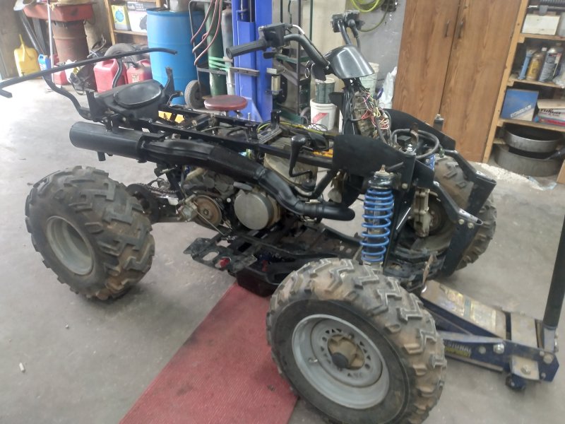

Howdy all, new to the forum, forums in general, and 2 strokes altogether. I have a new to me 97 Polaris Express 300, it has been bored .30 over, running 40.1 premix, oiler lines are blocked off. I admit my ignorance of 2 strokes and I'm Louznmemind with this thing.... I cannot get it to start without holding the throttle wide open and it will not idle on its own no matter what I do. Once I get it started I have to hold the throttle slightly open to keep it running, it will go into gear and SEEMS to run good all through the throttle range, it screams at WOT but when you let off it wants to bog out, it will keep running if you keep bumping the throttle. The carb has been taken apart and cleaned although it looked brand new inside when I took it apart. The main issue it had when I got it was it would pour gas out of the overflow as soon as you turned on the petcock, I replaced the petcock and adjusted the float height, I also replaced the float needle and seat but I'm not sure I have the float height correct. Is there a process to adjusting the float height considering it is made into the float bowl? Could this be my issue or should I also look elsewhere? I have tried adjusting the air screw to no avail, even at 1/8" intervals but the idle never changes at all, what is the default setting for this screw as well as the idle screw? I apologize if this is confusing or if I missed giving any necessary info but I will do my best to clear anything up if someone could please give me some advice.

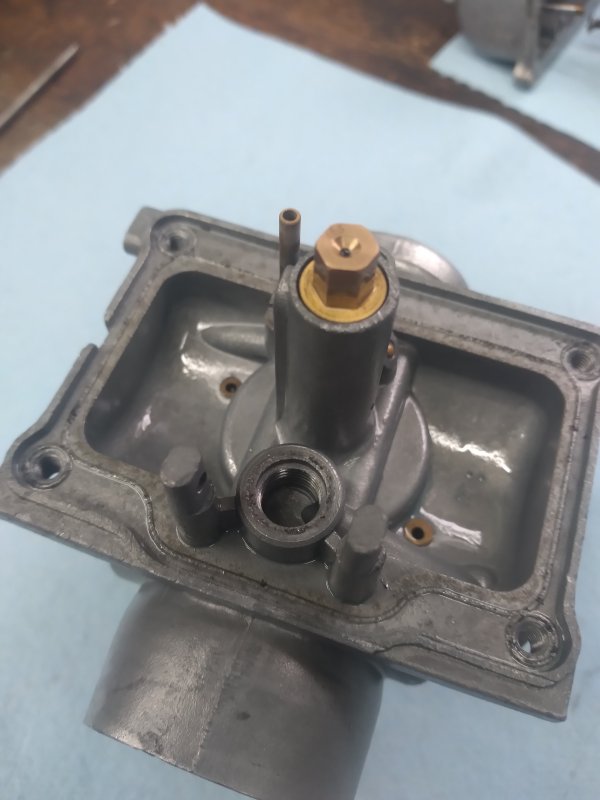

After this info as well as the info in the post Imade above this one, I took the carb back off this morning to compare the "packing" to the washer.
It couldn't be more obvious, the hole that the needle seat screws into has a small groove inside that sits slightly lower than the outer ridge.
The washer sits on the outer ridge where as the packing should sit down inside on the groove. You can see the what I'm referring to in the pic. I'm 95% sure that is my issue. I feel like an idiot for not noticing this sooner.
Now I have to order a few so I have extras and wait 4 or 5 days for it. It seems it's not a typical "o ring" because even the ones that small seem thicker unless someone knows something else I don't..

And good for you for finding it. When you put it together do that tilting test to make sure it's closing properly and sealing right off air-tight.
Thanks Mech, I just went ahead and ordered a few OEM ones for the time being. Once I see exactly what they are maybe I can direct match them if the need ever arises.
I figure since the old one came out in pieces it would be hard to match anyhow. I may as well get what it calls for after all I've put myself through, lol.
I'm not counting my chickens until I get it back together but it makes sense to me now. I will definitely do the tilt test.
