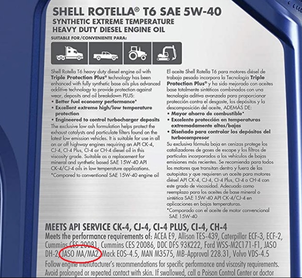

1 hour ago, Mech said:
Valkman... if it runs fine in the wet clutches in your bikes then it will be fine in the wet clutches in your quad...
That is not necessarily true.  The wrong oil can run better in a clutch pack with tighter springs or different fiber composite or different riding style leading to a false sense of security with the choice of oil.
That's like saying if ATF type F runs fine in a ford then it will run fine in a GM or BMW or anything with a wet clutch.
Why do you think there are so many types of ATF?
The standard/certification is just a nice assurance for people that can't read/comprehend or think for themselves.
Without a certification I don't know how anyone is expected to know anything about the oil.  One would have to send it off to be tested.
