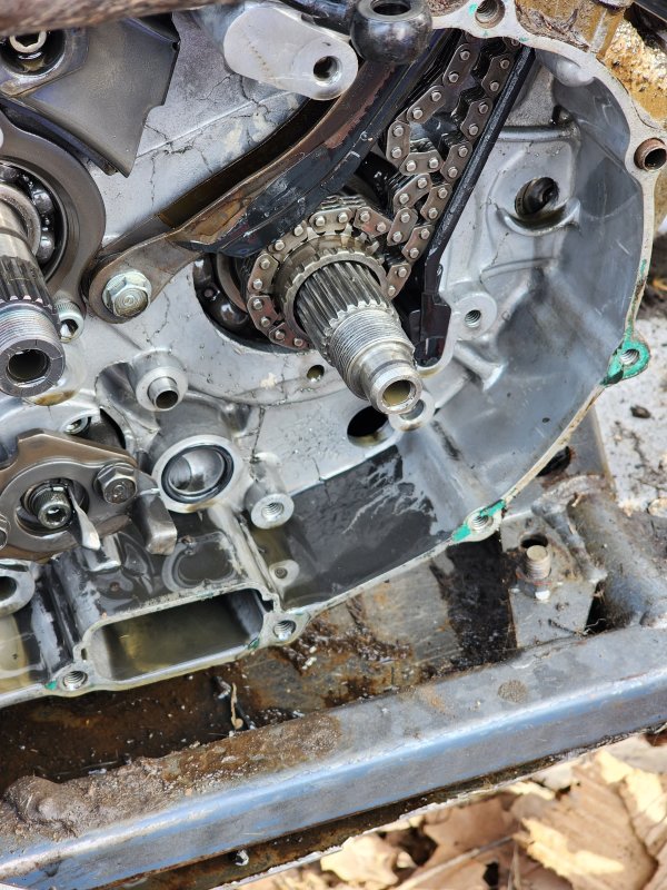

I got it off and, the chain came off on the bottom gear. Is it possible to put the chain back on and maybe, use the adjuster and tighten it? I thought maybe if I lined up the bottom gear to TDC, I could then line up the cam gear marks where they go with the chain still on the bottom gear or, is that possible?

To get the chain on you have to undo and remove the tensioning device on the back of the cylinder, take the cam sprocket off the cam, drop it down a little to slip the chain on, then lift it back up and onto the cam..
Edited by Mech
I thin it's possible to get a new chain on, I've always been able to get them off with the heads on. You let the chain dangle down by the crank, then bend/fold a bit at the bottom forwards, swing that short leg out and around the end of the crank and on over it.
The special tool... I've never used one on anything..  I don't know that I've seen that particular type of tensioner but most can be reset somehow using pliers or screwdriver or a bit of wire..  Have a play with it..  It gets retracted to fit it, then once it's released there should be a spring that pushes the plunger out, and a ratchet to prevent it going back in. Check the ratchet mechanism very carefully for wear. It might have slipped and caused the problem, and the wear might only be in one place, the place it was sitting with the old chain and slippers in there. A new chain might have it sitting in a better place, but you don't want it to slip again later after the chains stretched a little .
