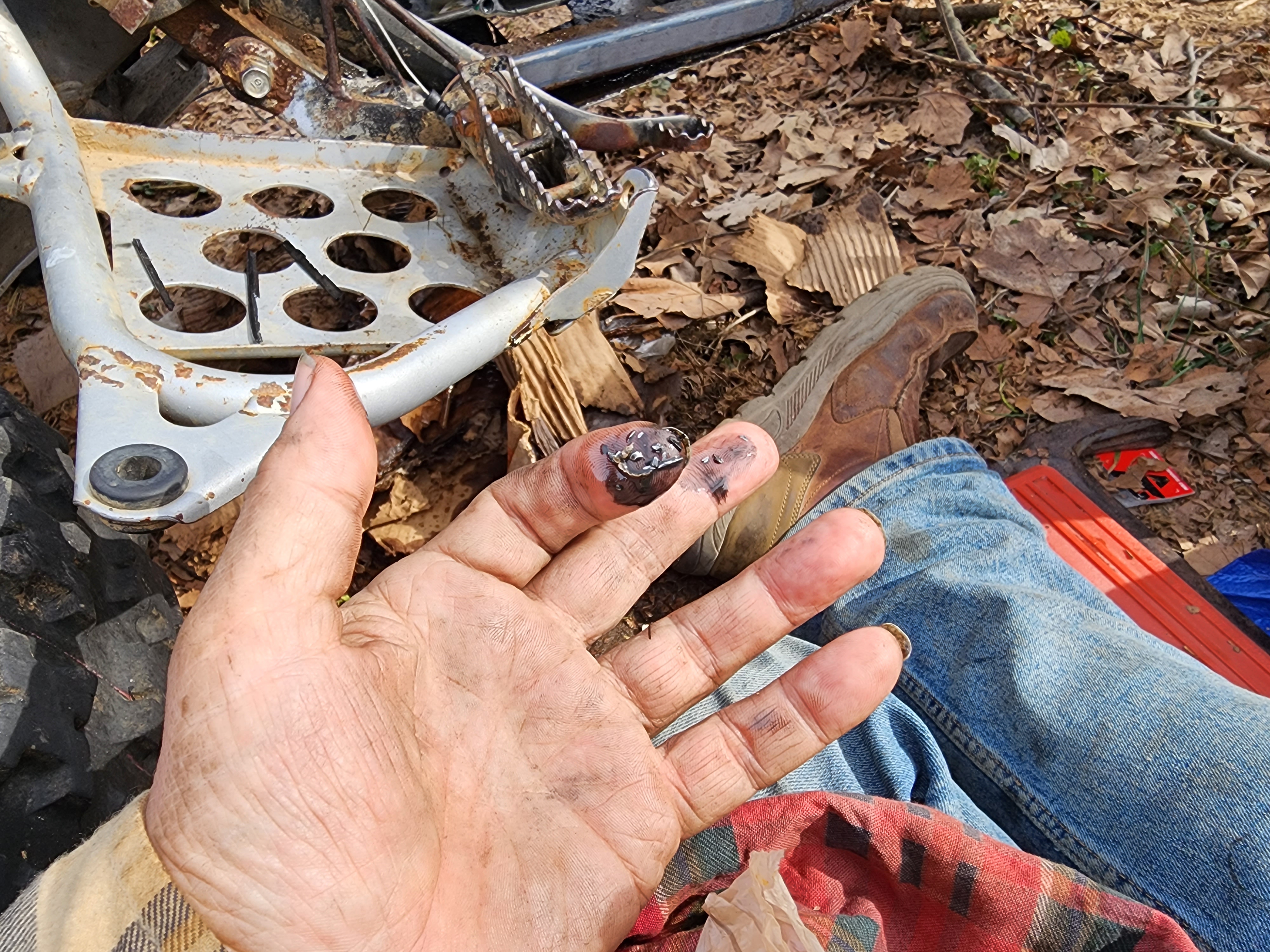

I found these little slivers on metal down at the bottom where the little screen was at. The timing chain to my eyes, looks to have a lot of wear on the inside where it wraps around the sprockets. The chain I ordered is suppose to be here tomorrow and the nut is suppose to be here by the weekend. Thanks a lot for the help folks.
If that's all the metal in there then it's a good one ..  haha.
See in the picture of the slippers on page two it looks like those bits of rubber could have come off the outer edge of the fixed slipper, and it could have happened just as the chain came off.. especially if the bits were laying there under the slipper and hadn't been washed away by the oil..
