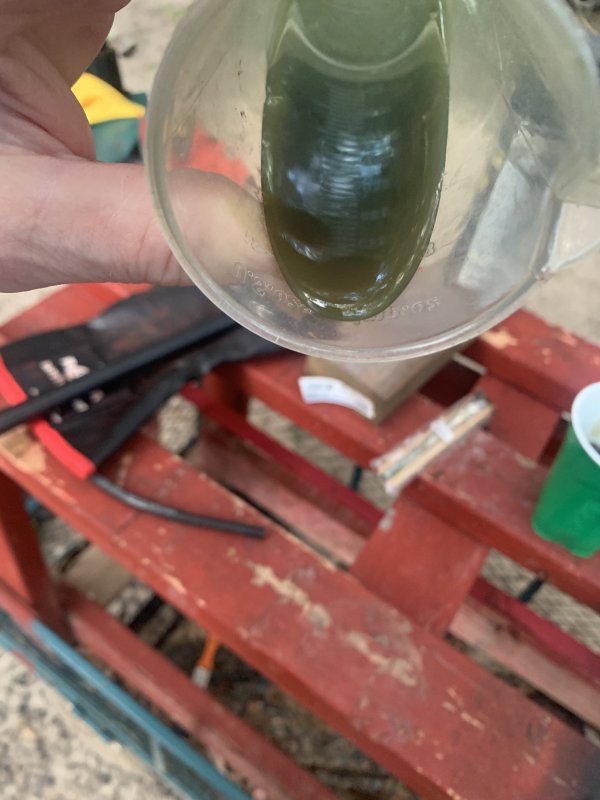

Thanks Mech, the oil did still seem like it had viscosity but not as thick as when I put it in. The noise does go away immediately when I increase throttle just a little bit, no really reving it up just increasing engine speed slightly. I did blow out the oil cooler with an air pump didn't get crazy with it ,so im sure I didnt get all of it out.

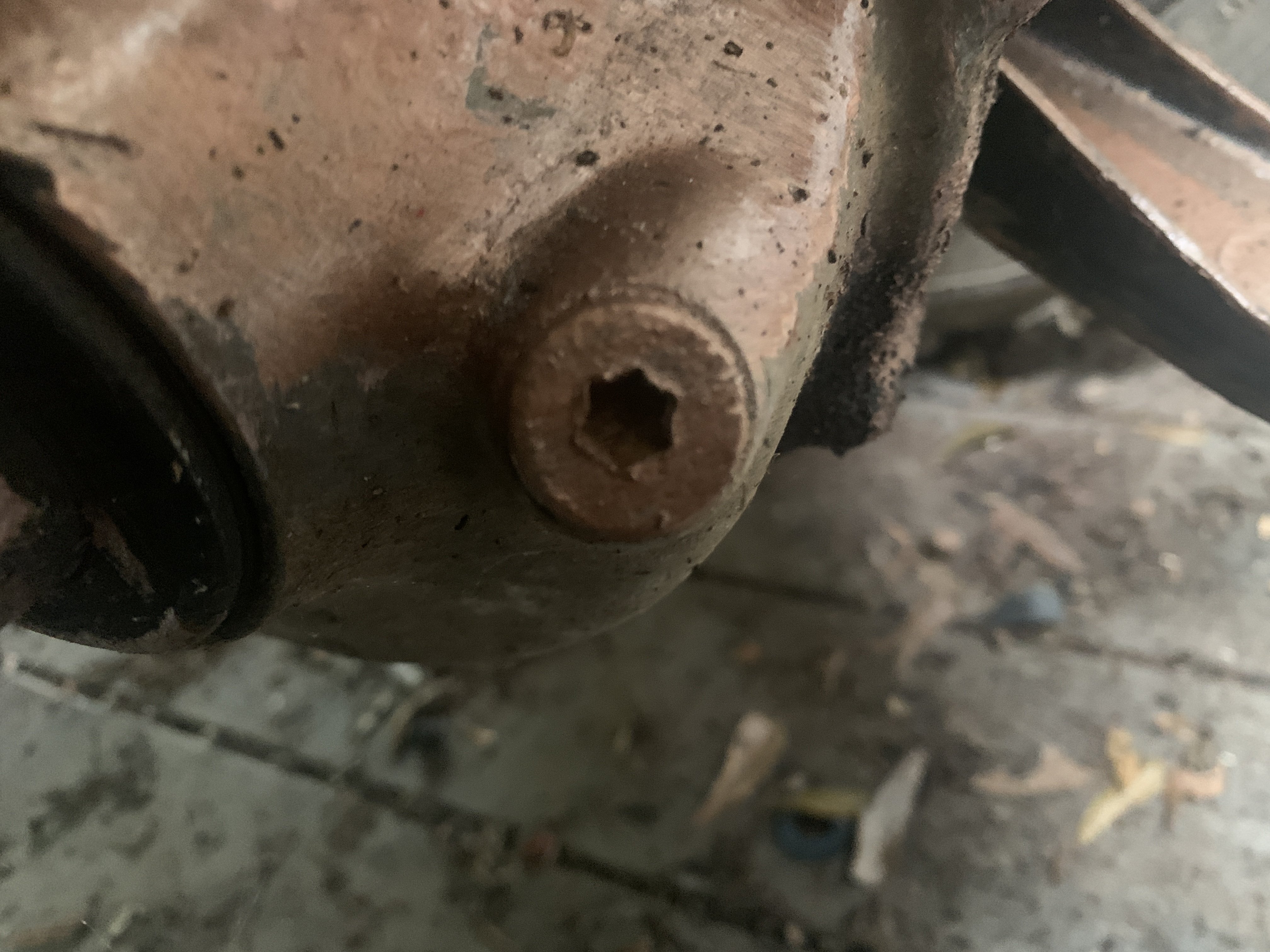

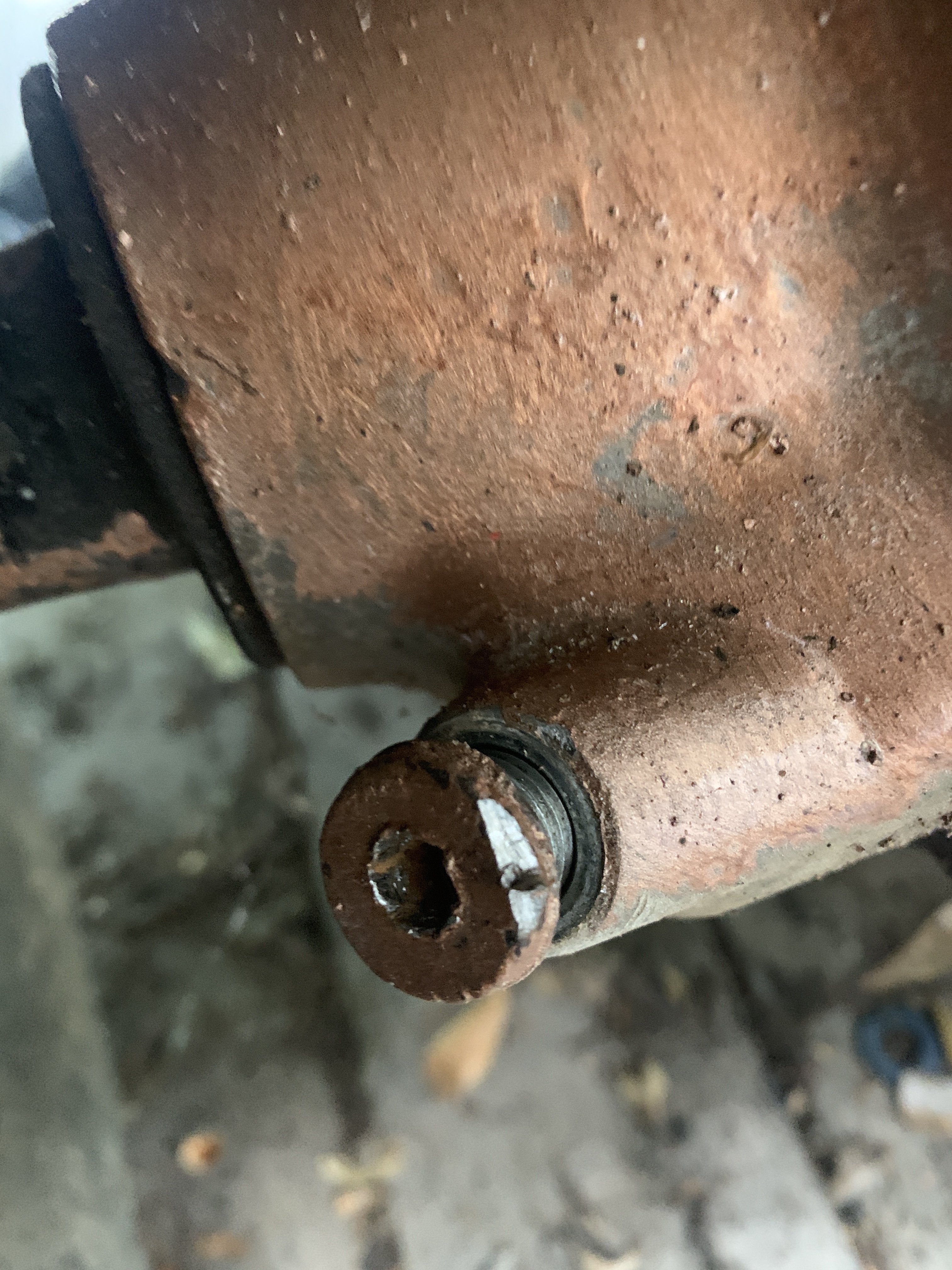

Went out today to check the differential fluid, the front bolt came out, not without  a fight, a normal ratchet wouldn't do it, had to get my 24 inch out, the rear one is an Allen or appears to have started out its life as an Allen, it is stripped, appears it might have been worked on with an SAE too small not metric. Im afraid im going to have to chisel it off. Front was 17mm bolt, this appears to have been a 5mm, I got a 6 in there but it wouldn't get it. Im going to try smoother things tomorrow,
Who.. very cool collection Gw..  The 305s were a classic..  and the rotary. ..  Good work preserving them even if you never do get to restoring them.
That allen key will be 6mm.  4,6,8,10 are what the japs use.  At least it's got the big flange head to tap around huh..
