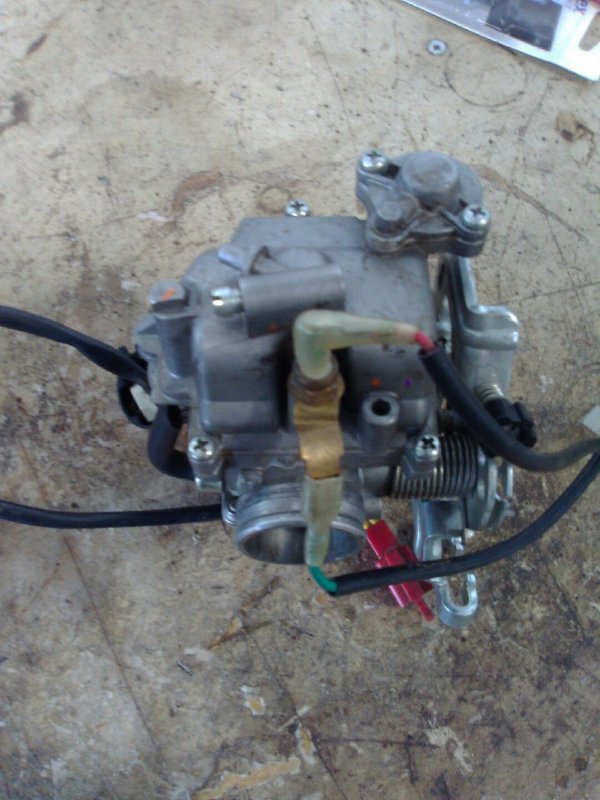

Also can anyone tell me what these wires are for that come off the bottom of the carb (see pic).

I think that's an auto choke. If the idle mixture won't adjust then it must have a dirty jet I think, or blocked drilling..

As far as the wires go it appears to me to be a carb heater, can't really see it good, if it is you might try unplugging it , sometimes they can cause a grounding issue.

I think the extra wires from the carb are what they call a warming resistor and work with the electronic choke.
