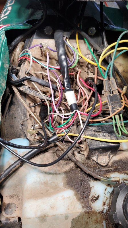

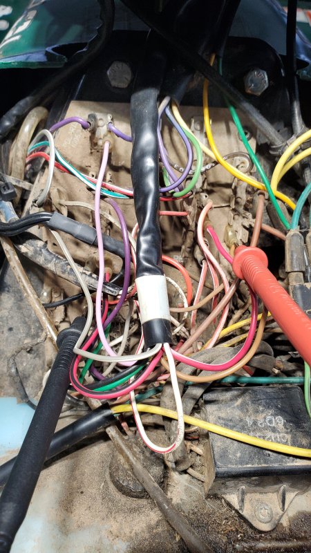

By on the board I meant I clipped a jumper from where brown and black respectively connect.
In the first image the red test prob is where brown connects to the board and the black is where black connects to the board.
The second image shows how I jumped the balck and brown on the board.
Does that help explain?
Nope.. It doesn't.
If that's where the handlebar switch cables connect to the wiring loom then I think you need to check the wiring loom itself is connected to those points.
If you look at that wiring diagram I posted you will see there are two kill wires from the switch to the loom, one black and one brown, and they both splice into the loom.. I don't know where those splices are but you need to find them and check from each splice, to the switch. And check where the wires connect to the terminals on their ends for either broken wire inside the insulation, or dirty crimped connections.
