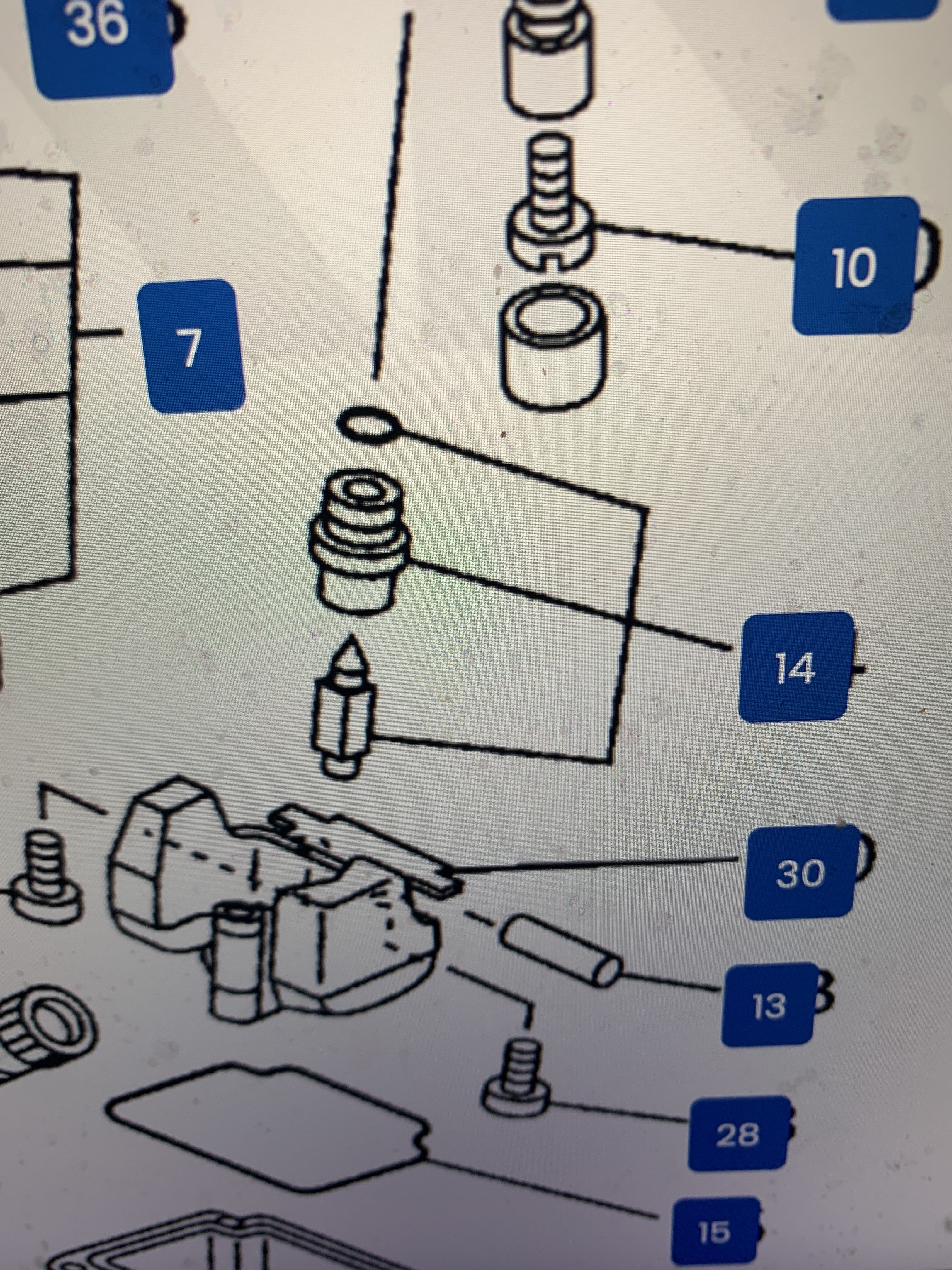

Chinese carb should get you running probably have to do some major cable adjustments, don’t throw your original mikuni away, that part I think you are referring to is the needle seat I’m sure it’s replaceable I just can’t remember if it pulls out or screws out I will take a look I have a similar big bear carb
I'll try that with the other carb. I don't think it's a mikuni tho. So, he got the new carb, put it on yesterday and still having the same issue. It sounds like it's not getting enough gas or too much. Also, when I went thru the carb before installing it, the needle valve doesn't move up and down in the needle seat like it does on other carbs. All the float does is push in on the button on top of the valve. Is this a normal thing or not? I don't know what I'm missing.
If it not an original OEM Mikuni carb i would just put on the new carb you ordered and see how thats works out, it will be fine. Its not normal for the needle to not move with the float there should be a little wire holder to attach it to the float, as the float moves up and down so does the needle. Sometimes inside the seat can get a little sticky and gummy and cause it to get sticky, i put a qtip in my drill with a little tooth paste on it to polish it up a bit and do the same on the needle sides, it slides a little smoother in the seat.
