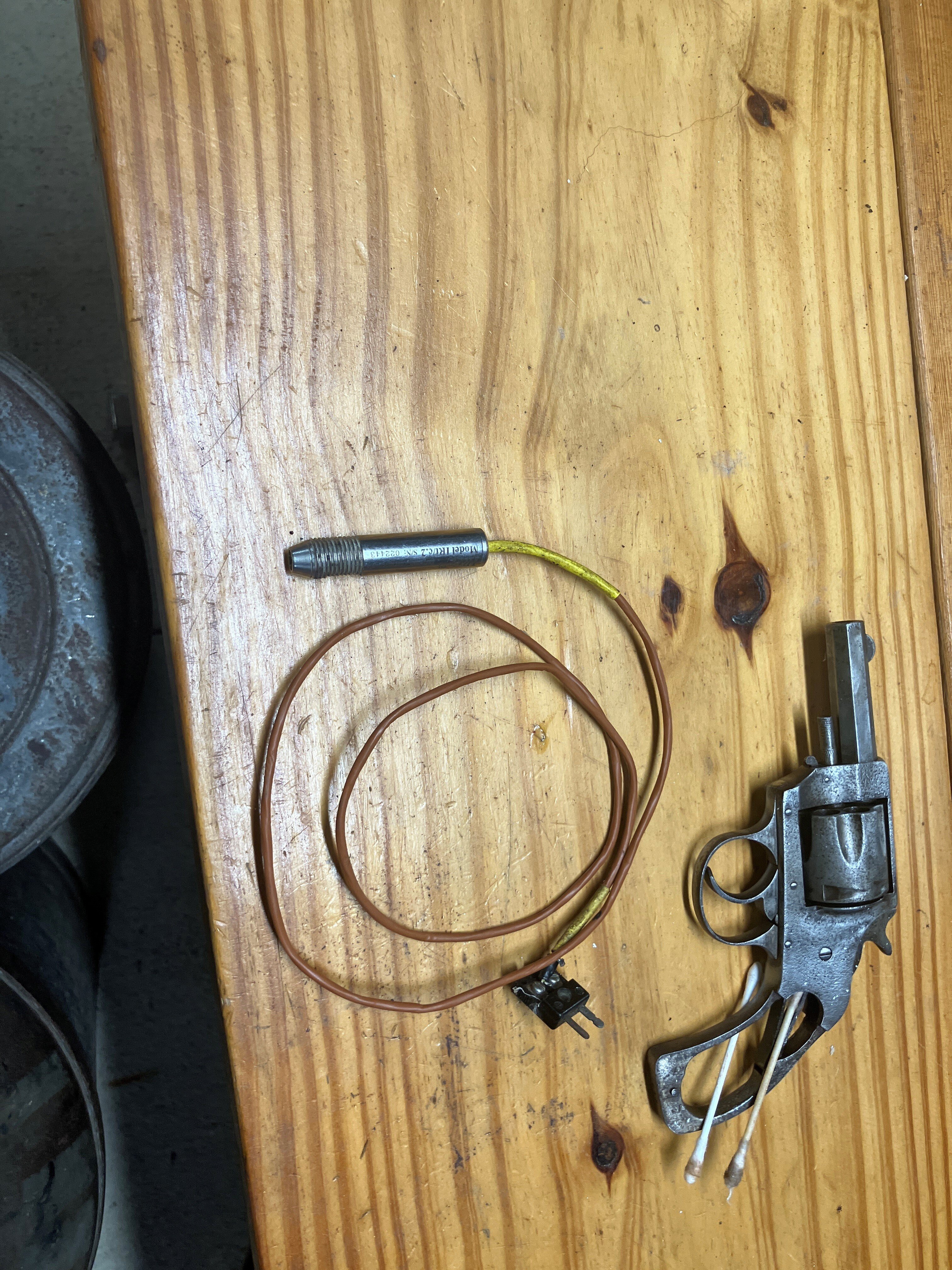

I was curious as to how you measured the temperature.  I check temperatures with an infra red scanner.  It performs like a Type K thermocouple when plugged into a Fluke temperature  device.
Anyways, if you have that OR SIMILAR device checking various points around muffler may indicate areas that are plugged.
I use a simple infrared "gun" to measure the temp, may not be exact but all relative.  The heat issue has been this way for a long time, I'm surprised others with this machine have not been vocal.  Not sure of any "plugging" as performance of the ATV is not impacted and exhaust does not seem restricted.  I do not see any red hot metal as I have seen others report on other forums.
