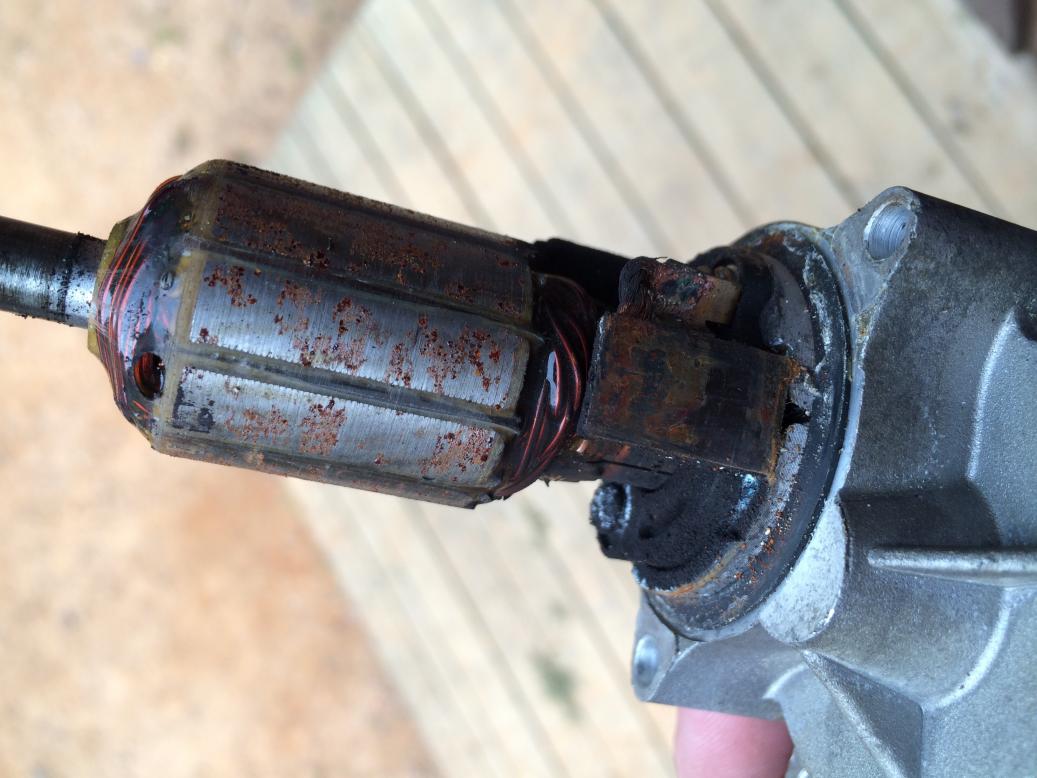

I ended up needing a starter. I got it to run and my son can ride but I have to jump the red wires in the plug where the relay goes to get it to turn over. I even bought a brand new relay...plug it up...hit the start button and nothing! I keeping having to jump the wires to get it to start. It should start with the realy plugged in right? What would cause it to not work...since the relay is BRAND NEW???

"I ended up needing a starter"....... LOL...Ray Charles seen that the old starter was bad. :D :D

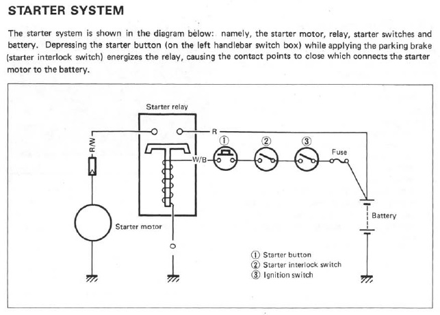

LT80 is right. Something with the start sequence circuitry that powers the relay to close. The one I used to own had a switch on the parking brake. If the brake was off, it broke the circuit to the relay. You have something like that? Do you have a wire diagram for it?
Thanks for the wiring diagram. Yes mine has a handle to be pulled up near the foot brake but that being up didn't make a difference...the start button worked before...now you hit it and nothing...it has to be a wire crossed or something not right because it don't even click or anything...you hit the button and total silence!
Do you get 12 volts going in to the starter button on the white black wire?
If not check power into those switches up stream.
If so, check power out with the start button depressed.
