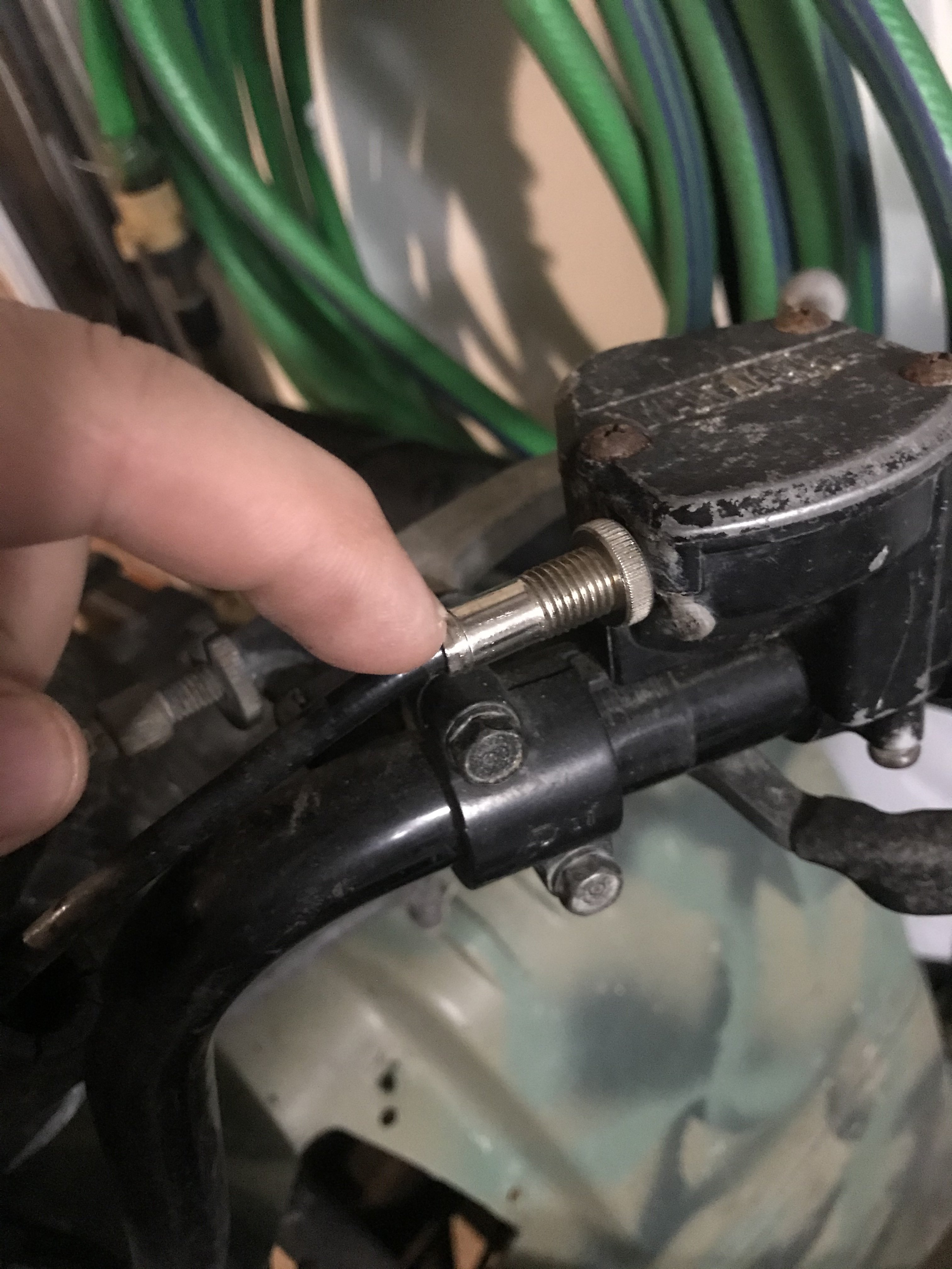

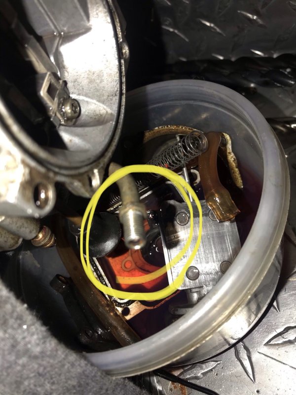

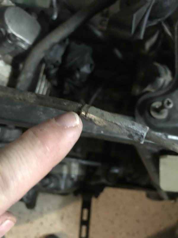

I attached a few pics of where the cable goes into the adjuster just in case your not familiar what what I’m talking about.   The last two pics are the cable end for the carb and the last pic is the carb that the cable screws on to. If that screw part has backed out any the idle will go up so make sure it’s all the way in.
