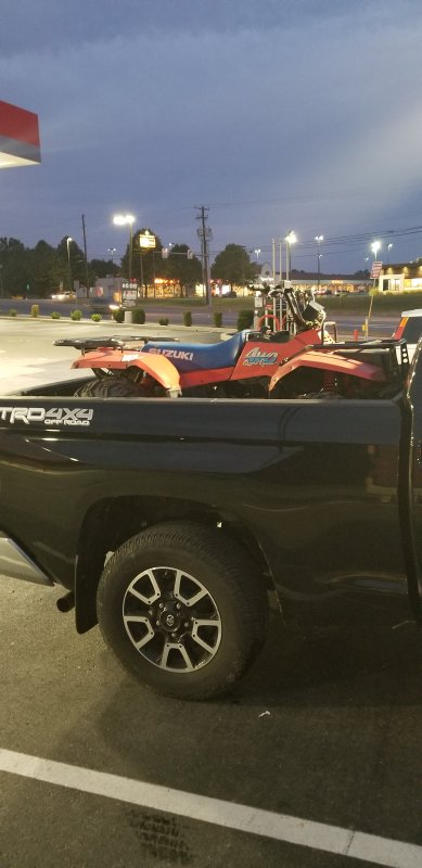

Hey folks, brand newbie here.  I just bought a pair of near identical quads, the difference is that 1 is a 1988 and 1 is a 1989.  The 89 runs and the 88 does not.  Turn the key up 1 click,  no neutral or reverse lights.  2 clicks, still no neutral or reverse lights but the speedometer lights come on.  Switch to run and hit the start button and nothing.  Since I have 2 of the same and 1 runs I'm ok switching out parts.....but where do I start?  Any help is appreciated.  Thanks!
Hey Ajmboy, thanks for the suggestion.  Here is how I got this one started.  Going through the factory Suzuki manual (which I downloaded from Quadcrazy...THANK YOU GUYS!!!) I ran a diagnostic and found out the reverse switch was bad.  I swapped In a reverse switch and got back my neutral and reverse lights.  Plus, I now have ignition.  The neutral and reverse switches are tied in to each other on this bike so if 1 is bad, neither light works.  Both switches need to work to get push button ignition.

Good looking bike!  Good luck.
