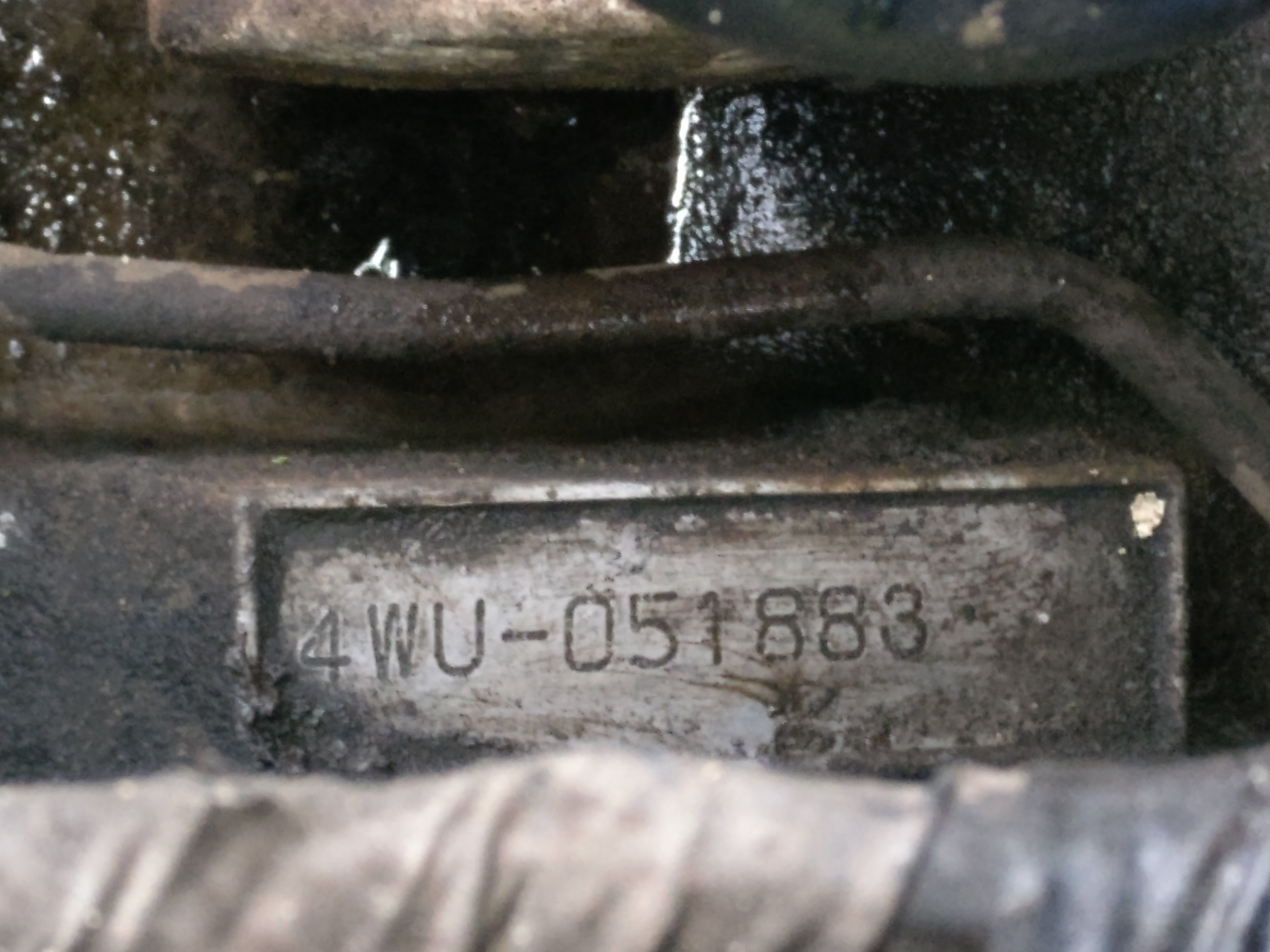

No tags I can find. There is this number which I just found looking at the engine block with a flash light. I might take off all the plastics and look at it better. Perhaps the VIN was stamped somewhere else on the frame too?IMG_20180723_185004.thumb.jpg.a7b95230248b2ad9c44a7eb0e2e8029b.jpg
My best guess is that you have a 2wd 250 bear tracker, if you look at the front fender for a big bear and a bear tracker they are different.  The big bear has 4 vent pockets (2 on each side) right behind the headlights, the bear tracker doesn't have these vents.  I believe that the C at the end of the part number on partszilla is for Canada (Km instead of MPH on the speedometer, but I could be wrong.
