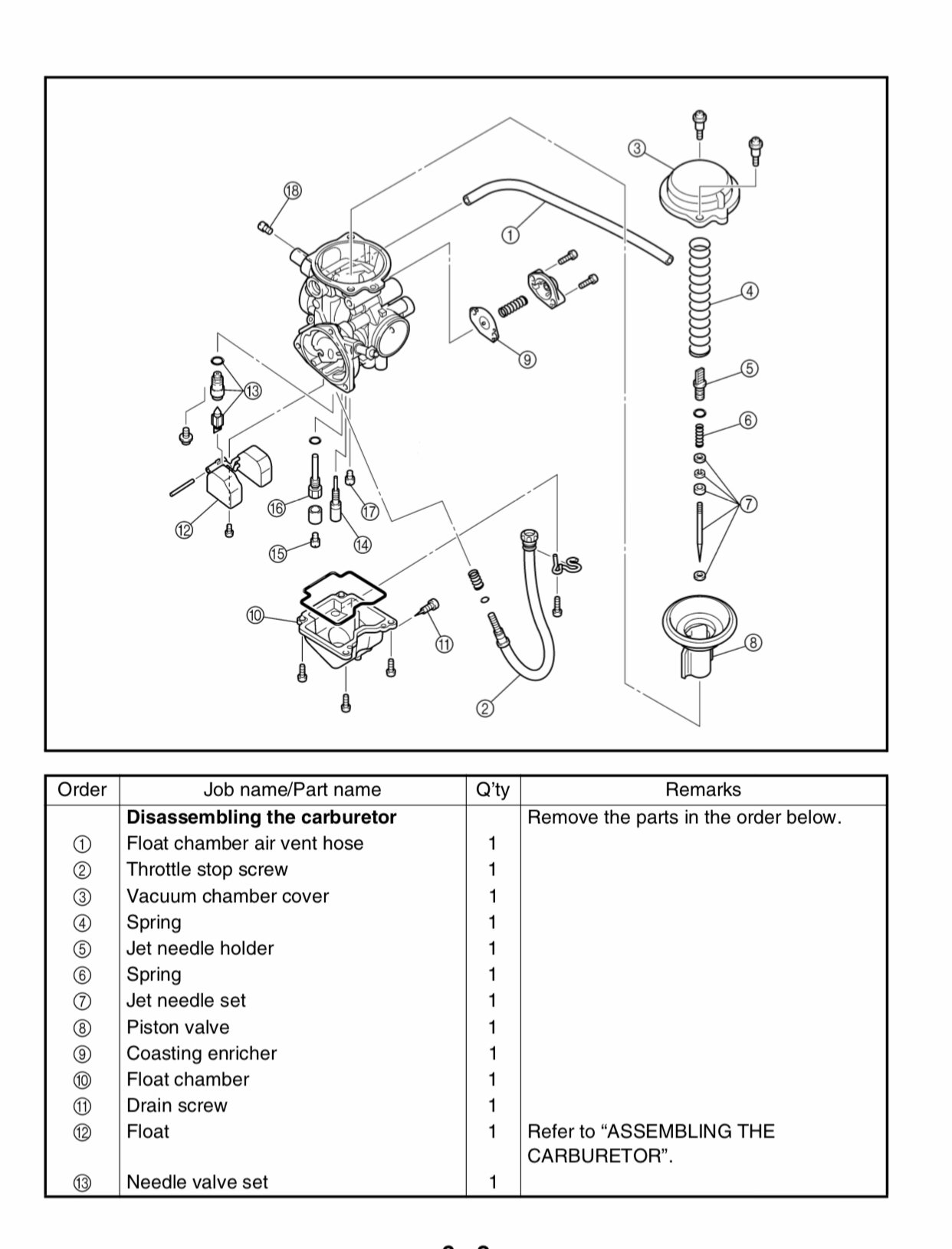

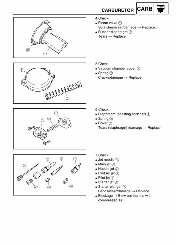

 @tundrawolf CV carburetors are really good carbs.  They are not very difficult to deal with once you understand them.  I would check the main jet which is the part #8 in the diagram I sent you.  That is the rubber diaphram (aka piston slide).  The rubber seal at the top may have a hole in it.  Since that slide is drawn up by vacuum created in the carb/engine so a hole would really cause problems. Just a guess. I also attached a few other diagrams so you have a better understanding of the carb and what to clean.  Good luck.

I checked the diaphragm like you said, it was good. I noticed when I removed the choke piston it was pretty gummed up and corroded, and the spring was insufficient for it to push back in when i released the choke. So I thoroughly lubricated the choke cable and cleaned the piston, and it turns out that this must have been a problem since I got the quad, because it has tons more power, it doesn't ping any more, and it idles fine now. The choke pull broke so the cable is exposed, I need to seal it and maybe use safety wire to pull the cable end to the pull button so it is secured. But the problem was he choke the entire time.
