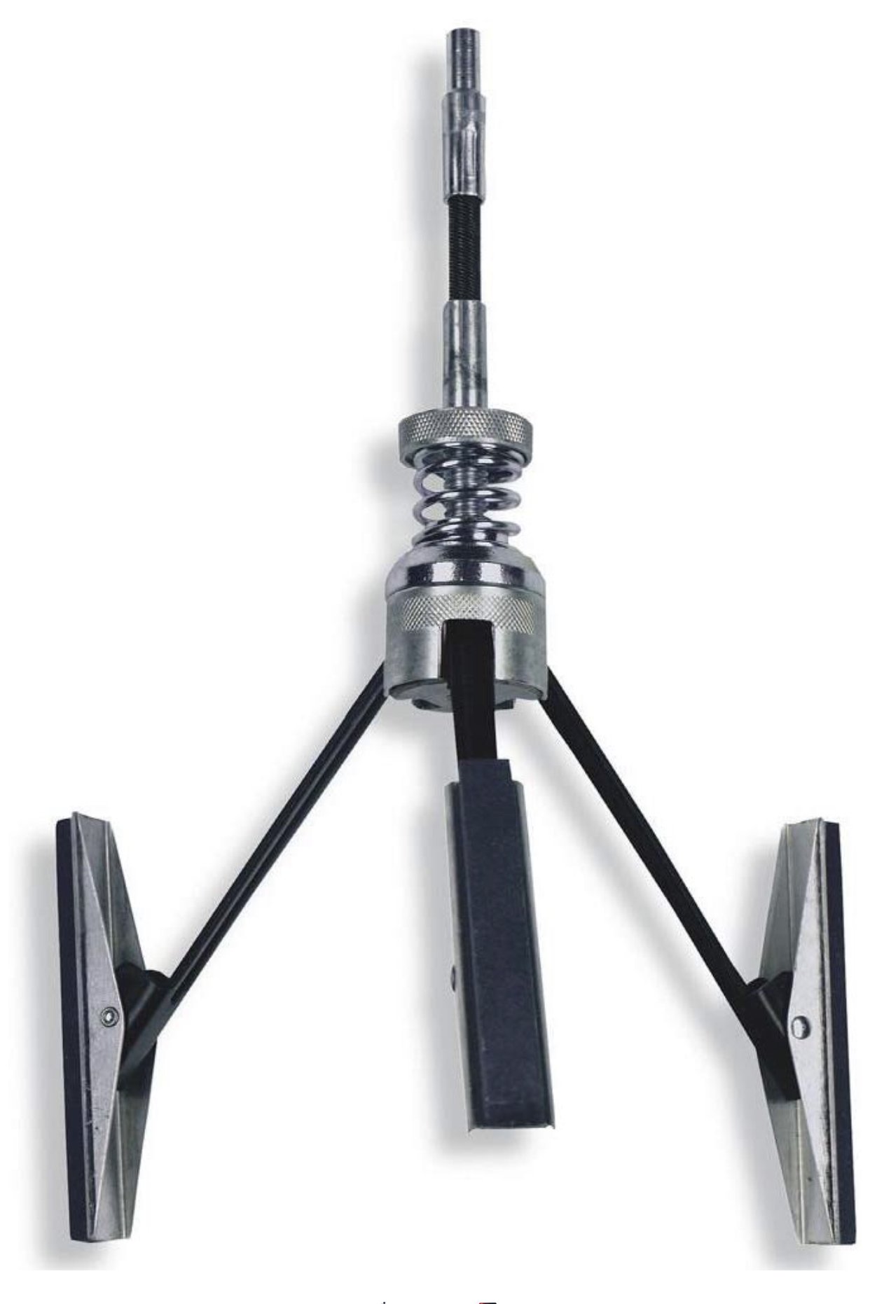

The cylinder should be honed pit with a honing tool. I’ve attached a pic for you.  The pastor can be cleaned with starting fluid.   Def put a new set of rings in as well.
That honer goes into a drill and you go up and down the cylinder nice and easy at a slow speed.

getting parts in- I ordered a valve compressor but it hasnt come in yet...  So I have new valves, a top end seal kit, new rings, piston, and wrist pin.  I have the honer too which I will use on the cylinder (it does have some minor scratching from the rings)
Sounds great just don’t go crazy on the cylinder.   A few passes is all it takes.  On another note the valve springs, when you put the retainer clip in to hold the valve make sure it’s in right.   They fly off and it’s gone!
