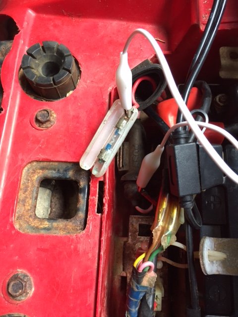

Thanks for the response.  After spending some time studying the wiring diagram, I realized that I had missed one of the first things I should have checked.  The pair of fuses coming of from the battery.  Both fuses were good, but one of the connector wires had broken away from the fuse.  I used a jumper wire from the battery side of the fuse to the broken wire and the neutral light came on and it fired right up.
Now to find the wire to fuse connector to repair the broken one.
Thanks again.
That’s a good find ! Nice work, that’s an old type in line fuse.   I would order the newer style and splice it right in.
I use these and they work great just make sure you put the right size fuse in.  You can see the amperage of the old glass  fuse on the metal part.
Waterproof car fuse holder 5/10/15/20/30A Amp In Line Blade Fuse Holder with 10 pcs fuse https://www.amazon.com/dp/B01DLUQ1BW/ref=cm_sw_r_cp_api_i_9KhhDbSWH2JTZ
