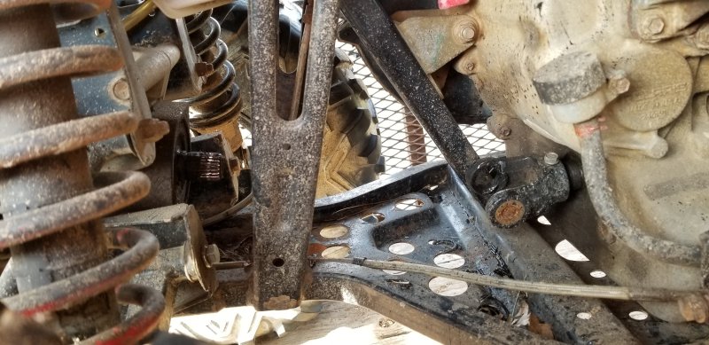

Oh that happened to me on my 800.  I thought I blew a belt, but the rear drive shaft had blown up and dropped out of the atv lol. Heres a pic. Cost 80 for a new shaft works good now.  I had noticed that the old drive shaft appeared to be to short as it only reached half way up the rear splines
