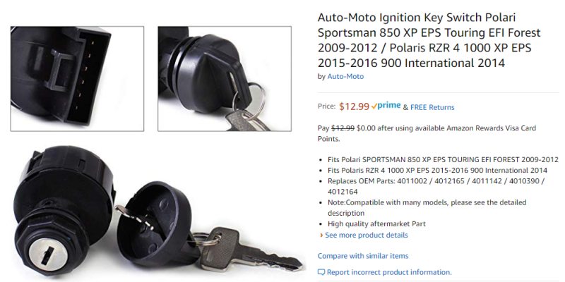

That's interesting because you wouldn't think of a slow crank from an ignition switch, but more of a weak battery. They are pretty cheap on amazon for some of the aftermarket ones. Maybe they cause a slow battery drain after some issue? More than likely something else or an internal short within the ignition switch?
Auto-Moto Ignition Key Switch Polari Sportsman 850 XP EPS Touring EFI Forest 2009-2012 / Polaris RZR 4 1000 XP EPS 2015-2016 900 International 2014
