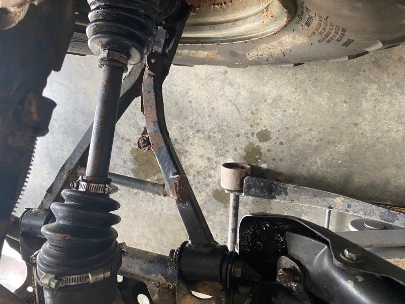

When it rains, it pours....i just noticed today that my lower A arm is BENT!!  ARGH! i was trying to figure ouit why one wheel didn't look like the other when sitting there and i saw why.  Apparently someone drove into a rock or tree and bent the thing. Unfortunately for me, they no longer make this part, (5FU-F357A-00-00) so i looked around ebay and found one for $145 used. I'll check out the pictures and maybe i'll buy it. This thing is nickle and diming me.......

it's bad, cross member has a slight crack in it. I bought the one from ebay so i won't have to mess around. I'm waaiting for new ball joints to arrive, so i'll do everything at once when i get that arm. wife is getting ready to kill me....lol
see picture.....

Ahh its time to get the hammer out.......Save yourself a few bucks.........Well if you got the bike for a good price than it is worth sinking some money into ......Have you seen the prices on these new machines today?........I could have remodeled my house with that kind of money back when I purchased my machine.........It is beyond insane........Why would people go in debt for one of these things today........Well to each their own.........Hey if you got it flaunt it.........If you dont, put it on the credit card......lol
ha...price out a quart of oil...i used to buy a 5 quart jug for the price of one quart today.
i was going to try to bang it out, but like i said before, there;s a crack in the weld of the cross member and i don't have a welder and it's hard to find a good one around here. everyone like to use those damn sticks.
i spent a couple of hours looking for one. "no longer available from the manufaacture", so the only used one was on ebay. he wanted 145, but i got it for 125. free ship. that's going to be my last big investment in this thing. if there's aany thing else that's big bucks i'll sell it and get my money back (hopefully) with all the extra parts i'm buying i'm up to almost 1200 in it.
I don't know whether it applies to yamahas but some makes and models have different suspension arms in different years, some are longer to make the bike wider.  It's something to watch out for if buying second hand parts.
Also Mga, it's always worth looikng up the parts online, then seeing what other models they fit, because often the other model uses a different part number, and sometimes that other part number is available. They change the numbers if it's a superseded part, or got a different colored paint or any number of trivial things..
