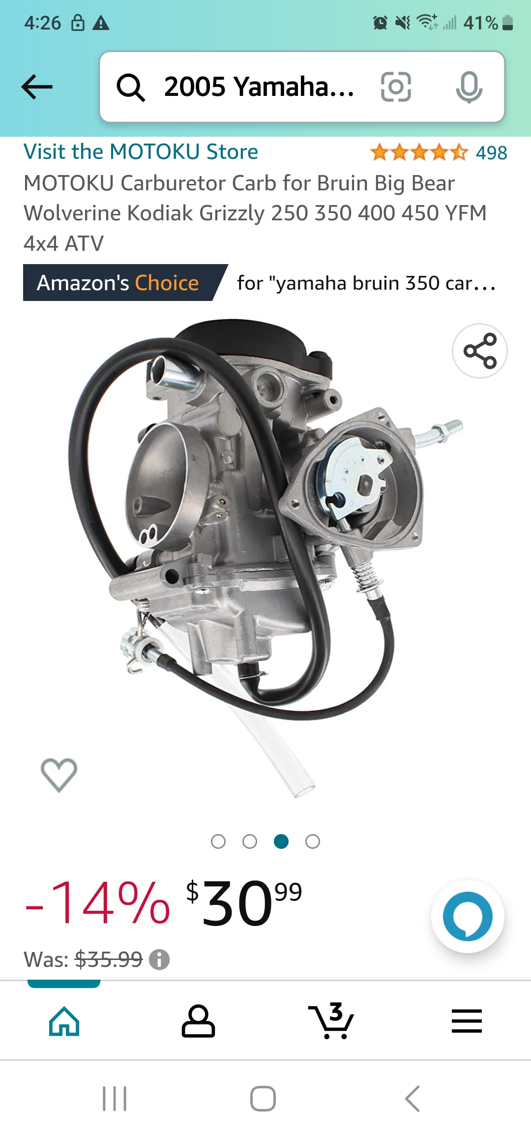

Good bit of work there. At 66 I'm still trying to learn. I may have found your carb.
looks like the one that's on my atv. now i have to wonder how good it is. i can't start the atv because i have it all apart.
I put one on my suzuki when I got it, old one was flooding badly, which was also a generic, the plastic piece that screws into carb for choke cable was stripped out and triangle piece that covers the cables was missing, I ordered a generic that came with these pieces and the whole carb was cheaper than these two pieces OEM. Put it on and it ran perfectly, idle was a little slow so I adjusted it, and have had no problems yet. That was a couple of months ago, we will see how long it lasts.
I've used the chinameese carbs on small engines around the farm here with good results. On the more complex cv carbs seems hit or miss. I hope you're in the hit side of things.I'd personally rather rebuild the oem unit.

wish it came with the OEM carb, unfortunately, it didn't. I have it stripped down (all electrical unplugged) so i could power wash it.  Once i get the fenders painted, i can start putting all that back together and pay attention to the carb. it ran good when i first looked at it, so, i don't see why it won't now. i hope. Just trying to make it look original, or close to it.

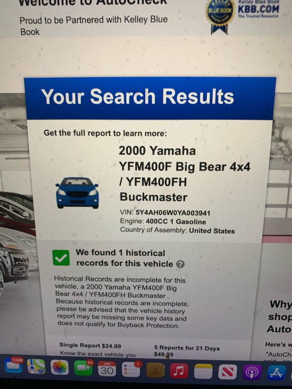

when i bought mine, the guy told me it was a 2005. A few says later, after my original post, i chased the seerial numbers and it's a 2000. So, if i can send you any pics of wiring or something, let me know. When i was looking for parts, none of them looked like what i had on mine, that's when i checked the vin and found out why.
