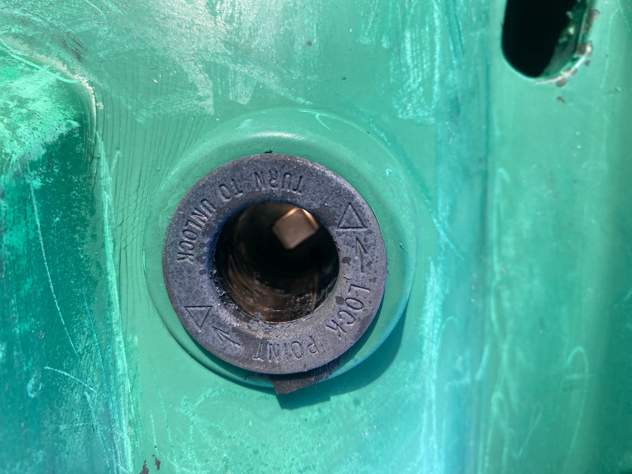

While i'm waiting for all my parts to show up, i have another question...lol....on the front fender, there;s a "LOCK/UNLOCK" hole with no switch. I saw only two disconnected wires under the fender so i'm assuming they would have connected to the terminals on this missing switch. I figured out it's for the differential to lock or unlock it. I've looked on line but every switch i saw was mounted on the handle bars. I haven't found anything that looked like it would fit.
Being that there's only two wires to this, why can't i just wire a simple "push on/pull off" switch?

I have a 2000 the only hole I have on my fender is for an accessory power outlet my differential engage is on the handlebars but it doesn't look factory
ok, this is what i'm looking at. don't mind the paint, i'm in the process of painting the fenders. Maybe i'm wrong about what it is, but when i turn on the power, the wires are live with 12 volts.
1 hour ago, Jas said:
That’s an accessory power outlet. I fitted the same one to the tray of my ute. You can run a spotlight or other 12v things from it.
OMG....that makes perfect sense!!!  stupid me, the "lock/unlock" threw me off.. thanks for the clarification,

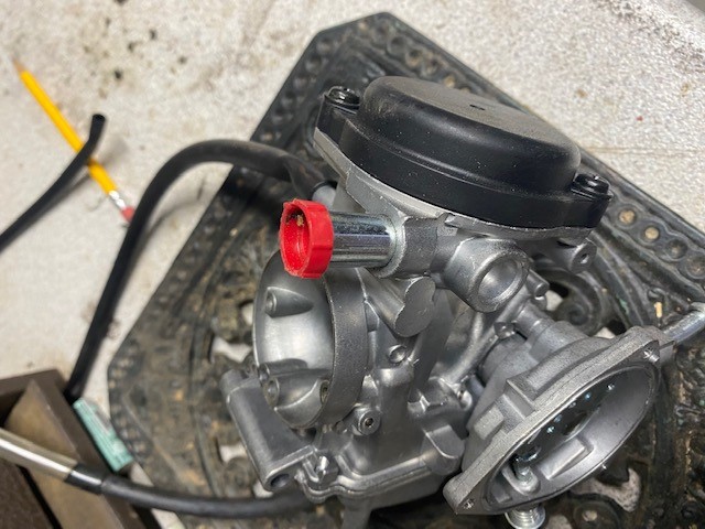

Next question....there's an opening on the carb at the top. (I placed a RED cap in it) Is there a hose that connects there? I've searched for hose diagrams , but can't find anything that plugs in there. I thought maybe it's for the crankcase vent?
I'd try blowing down it and see where it goes. It might be blocked off.
On a Suzuki there is normally a float chamber vent just around the corner from there on a flat you can see shaped like a figure eight. The vent is drilled into the top of that figure eight.. If there's no other vent then that's probably what it's for.  Blowing will tell you..

it's definately an after market carb. While looking at some, i noticed they have that same "tube" protruding out. the only tube i see on the engine was a cut one. I was guessing it went there. I saw one diagram that showed the engine's PVC tube attached there

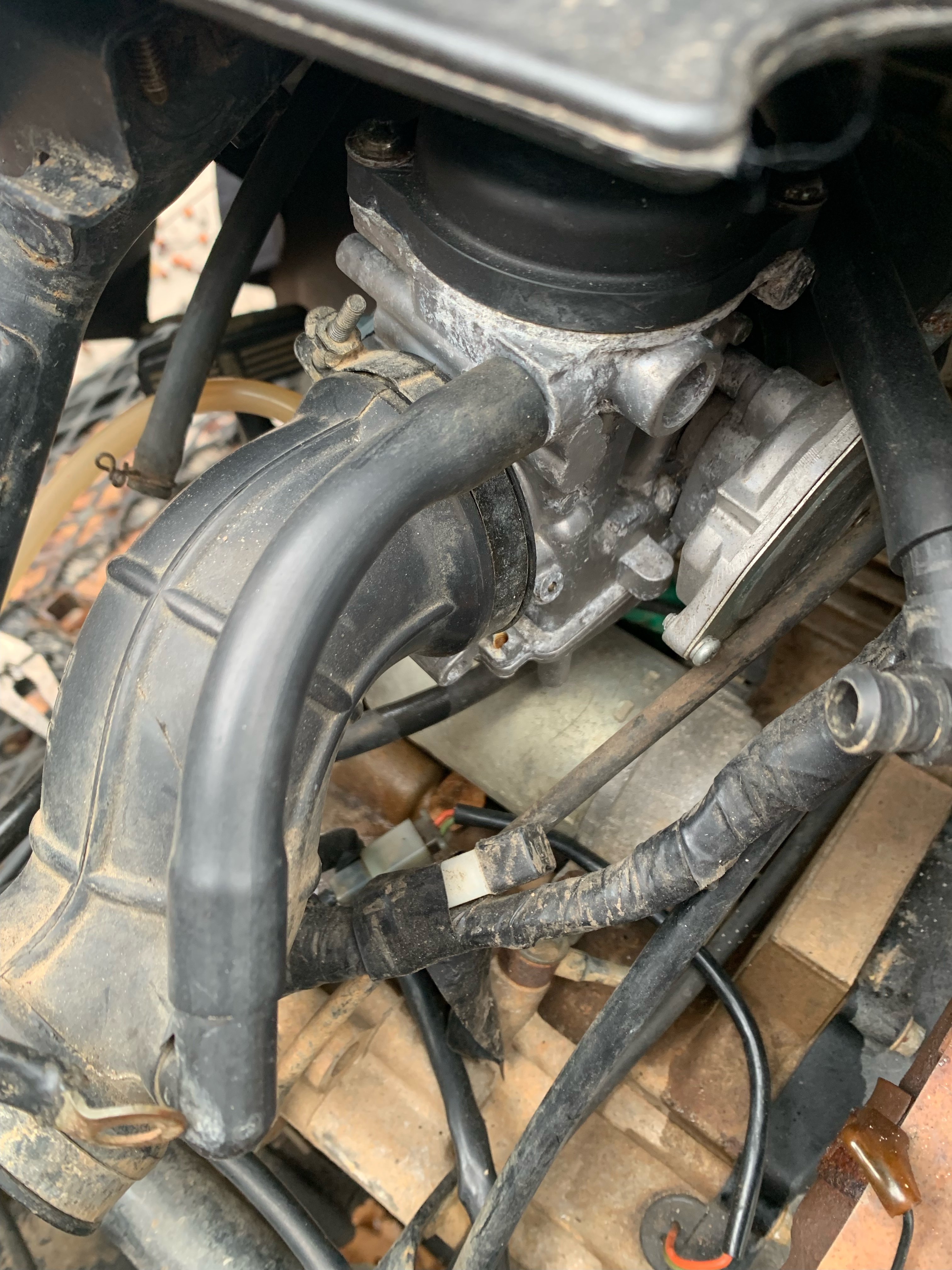

Sorry, I was wrong, thinking of a different bike, the Hose you were asking about goes from carb to larger hose

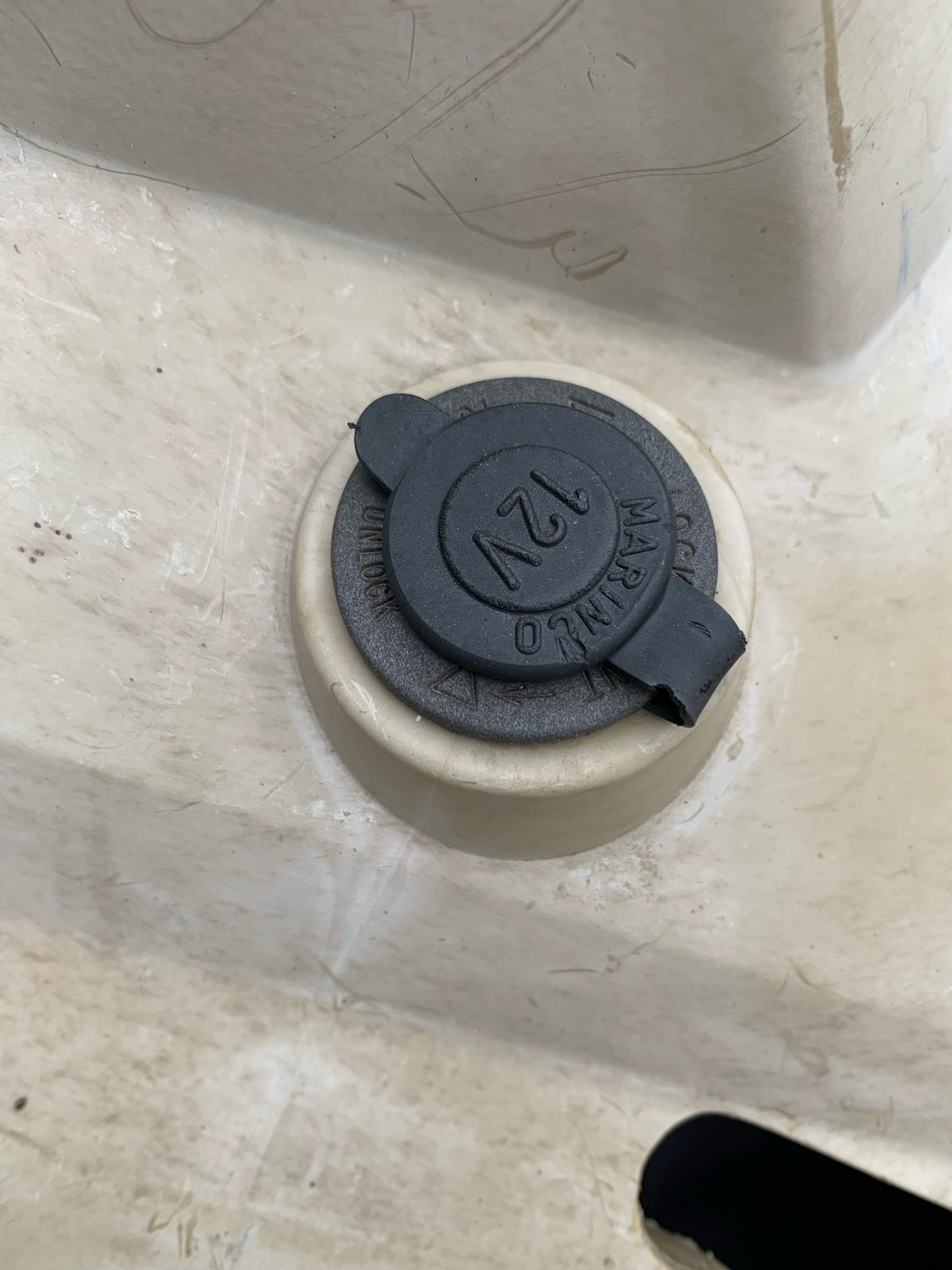

The power outlet on my BB
perfect pictures!!  thanks!  I knew a hose had to fit on that carb. I'll check the manual or parts look-ups to see if i can ID it for a part number.
so, i looked around and saw this picture of a carb with hoses. I'll just get a single hose that hass a large enough opening to fit over that "port" on the carb
