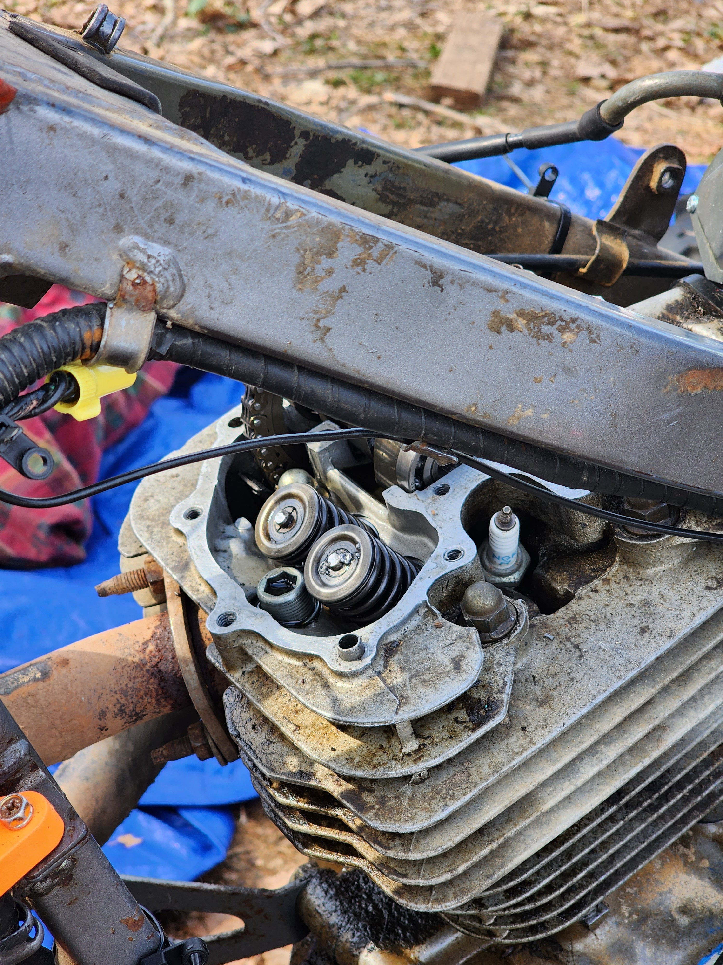

Yeah that's what I was thinking..  A weld..

20 minutes ago, Gwbarm said:
Never seen a valve tack welded to a keeper, I do some, non text book repairs, but that's got me beat.
Bought a Kodiak a few years ago that had the rocker tip tacked bc the nut was missing but tacking a valve is a new level of haggardety.
Yeah, I got screwed when I bought this piece of sh**, $1000.00 down the drain. All I wanted one for was to go through the woods by the house to hunt and fish.  I figured surely it should be good enough for that. But so far it's proved me wrong. That fat bastard I bought it from should be glad there's laws!
When I got it barely ran the guy said it probably had some junk in the carb. I figured I could clean that out and it would be fine. But, I think it was having trouble starting and staying because It was probably about ready for the chain to jump off then. I've got maybe 2 minutes of actual riding time on it.
The chains have to be really really worn before they jump off..  If they backfire though, or kick back as they are stopping, and the tensioner isn't good.. then they jump.
Is the old chain really really worn ?

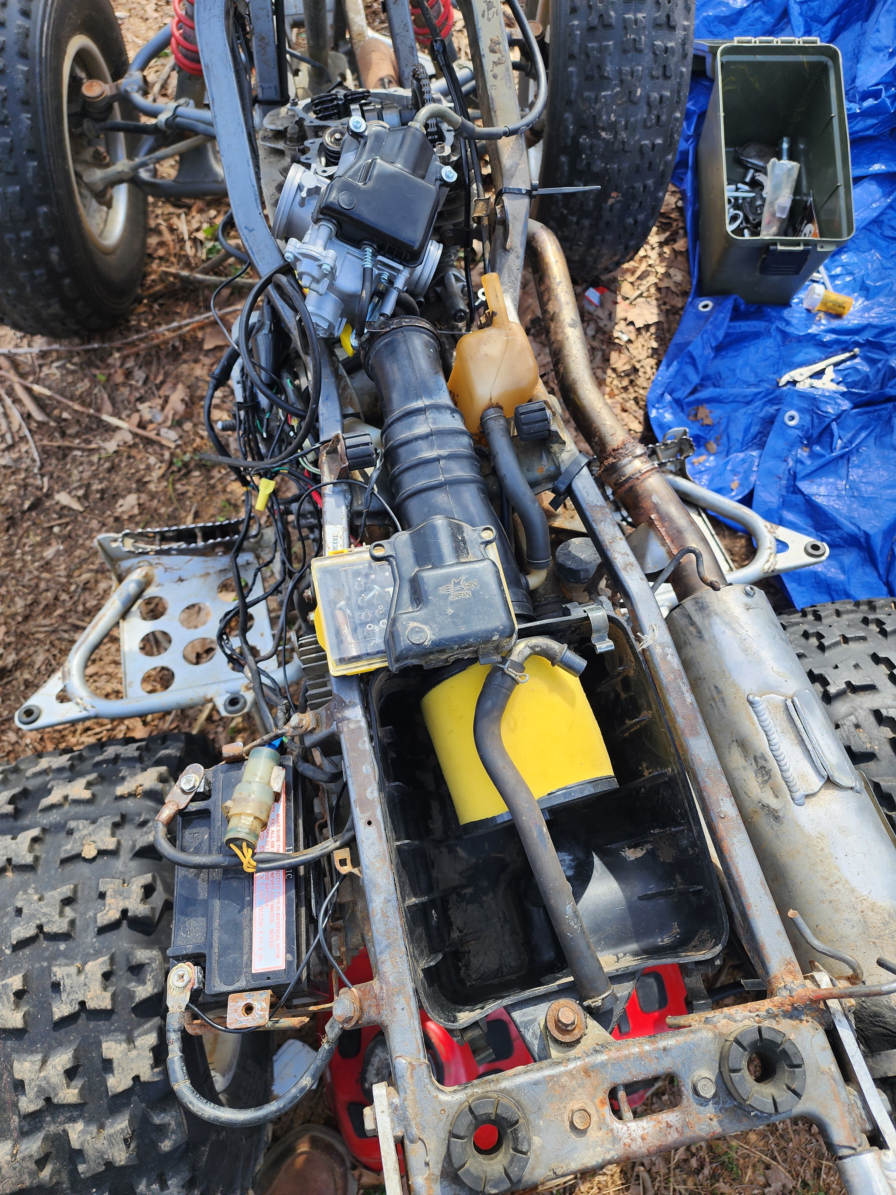

      I'm currently working on an 04 Suzuki Eiger 400 and ran into some issues. Main issue being it's really hard to start. Once I get it started, it runs bad. Sounds like it's missing, which I'm pretty sure is an idle issue. It's not my 4 wheeler. I'm working on it for a buddy. Someone started working on the original carb and 2 jets were missing when I got it to work on.
      So, I ordered a new carb. To get it to run, I had to adjust the throttle screw on the handle bar almost all of the way out. Even doing that, it still sounds like it's bogging down and missing.
      I did put a gas filter on it, which I'm questioning whether or not that's the issue and it's not getting enough gas like it should. The petcock only has an On, Reserve, and Prime option. It also has 2 ports. I guess I have the hoses hooked up right. There's no way to shut the gas off completely, and also it looks like there's no gas getting thru unless I run it on Prime. Reserve drips gas. I'm going to take it apart today and clean it. I'm also going to take the jets I need out of the new carb and put in the old one.
      I don't know what all this person did you the 4 wheeler before I got it. There's odds and ends missing that I've noticed so far. What else can I try or look for? What could be the gas issue with the carb and petcock? The carb was completely off the bike except hanging onto the throttle cable. The diagram I found for the carb doesn't help me with hose placements. Any help, or questions would be appreciated. I can attach photos if it would be of help.
