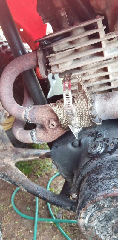

A little leak up at the head to exhaust pipe join, or anywhere in the first few inches of pipe, will make them backfire.
Tried these guys.. They have always been good exhausts at a fair price.
https://www.musketmufflers.com/
I ended up welding a bombardier 400exhahst  onto it ... And then it still backfired , I discovered more holes up near the head, I'm going to use some high heat jb  weld to patch them
I havent had a lot of success with JB weld on exhaust , doesnt like the high heat, but it will hold for a while, if still having problems they make putty for exhaust, also doent hold up well, the constant jaring of the machine loosens it and it falls out. Not much help, but that is my expierience.

And now that small hole in my exhaust blew apart into a huge 2inch hole right where the 2pipes join into one !!! So loud and backfires like crazy again . I hate riding it now because of the attention it draws...
But anyways, my current parts bike, has good pipes up to and past the join , I want to take it off and weld it on to replace the damaged portion..
But get this ! I tried to take the pipe off my good bike to replace it with the parts bike pipe, but The darn nuts on the header bolts are seized on there and basically morphed into the bolt. I already snapped one off trying to get it out ! I didn't want to proceed beyond that. Do you think I'm better off just cutting out a portion and welding it in 2 places instead of trying to replace the whole front part of the pipe ? Another thing I just thought of , was to weld a new bolt onto the old one , but it's a tight spot and I might not be able to actually do it (haven't really evaluated it yet )
Those bolts are sometimes hard to get off without breaking, i usually heat them cherry red and then srray with the water hose to cool them quickly and then douse with PB Blaster, it works most of the time.
If you can split the nut it will come loose. There are tools called nut splitters. You'd have to get one that could fit onto that nut if the space is a bit confined.
Nut splitter is a good idea i have one and never think to try it, generally we dont think to try these things until we have already broken the nut off, but as a rule i always try something on muffler bolts that have never been removed 99 percent of the time they break.
And has it fixed the back-firing ?
Those nuts at the head join, some owners manuals say that as a matter of routine maintenance they should be loosened and re-tightened. It's only about once a year they say to do it.  It's probably in recognition of the fact those nuts seize.
That would be good to do that every so often, i have been putting ani seize on everything including those bolts, dont know if it actually works because of the heat but couldnt hurt.
Anti seize should work at temp. Graphite powder mixed with oil, or black grease, or copper based anti-seize are all pretty anti-seize and heat resistant.

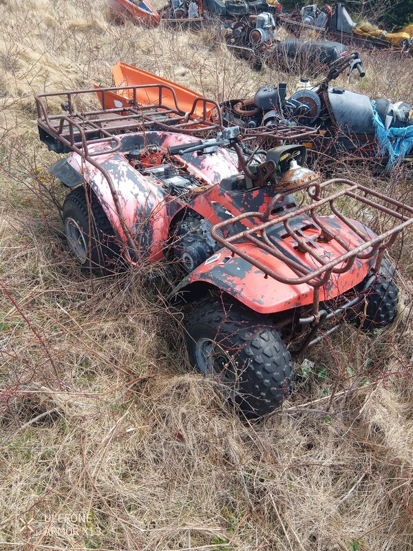

Next time I'll know what to do . Check out the parts bike I scored today !
It looks fairly complete, whenever i get a parts bike i look it over and say this is not bad and end up fixing it and turning it into a runner also, but thats what i like to do take junk and make it good again, i think its the challenge, not necessarily that i need another runner.
