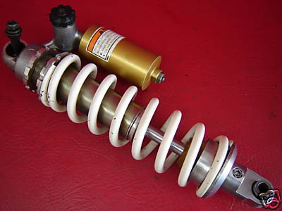

i jus traded for a 2005 raptor 350, and the back shock is very bouncy i guess u could say
but im like 165 and i sit and it flexes down very far, and i caught like a foot of air and it bottoms out
can neone help me with this??
alright man, your quad SHOULD have a black knob that is right above the resovoir. turn it. if it doesnt have the black knob then you have to take the shock off ur quad and take some vice grips and tighten it up.
here is a pic of one
can you see the sliver rings on ur shock? adjust the bottom one with a vicegrip. if u cant get to it then you'll have to take the shock off.
sorry for all the misconceptions, yamaha changed alot with the rappys supension bewteen 04 and 06.
there on the top, but im sure i can go pik up a spanner wrench 2morrow
could the shock jus b worn out? b cuz the guy b 4 me wuz 265 lbs, so if shocks get worn out that may b y
If the Shock was Adjusted right for a 265 LB rider and your Half of that you should feel like you are riding a Park Bench....You could have a Blown Shock on your Hands and just be riding on the Spring....That would be my Guess......However,,,,You can try to Tighten the Preload by Compressing the Springs with the Two Nuts on top of the shock....If that doesnt work....Take the Shock off.....Take it to your nearest Dealer....See if they cant rebuild it for ya.....Should be Cheap...
Let us know what came of it....:wink:
yeah there are 2 nuts at the top of the shock ul hav to take the shock off and use a big set of vise grips or something to tighten it. (i use a plumers wrench) this will compress the spring making it stiffer. good luck!:yes:
if the shock is blown this would explain the bounciness.(by the way shock rebuilds:yes: r way better then stock!)
