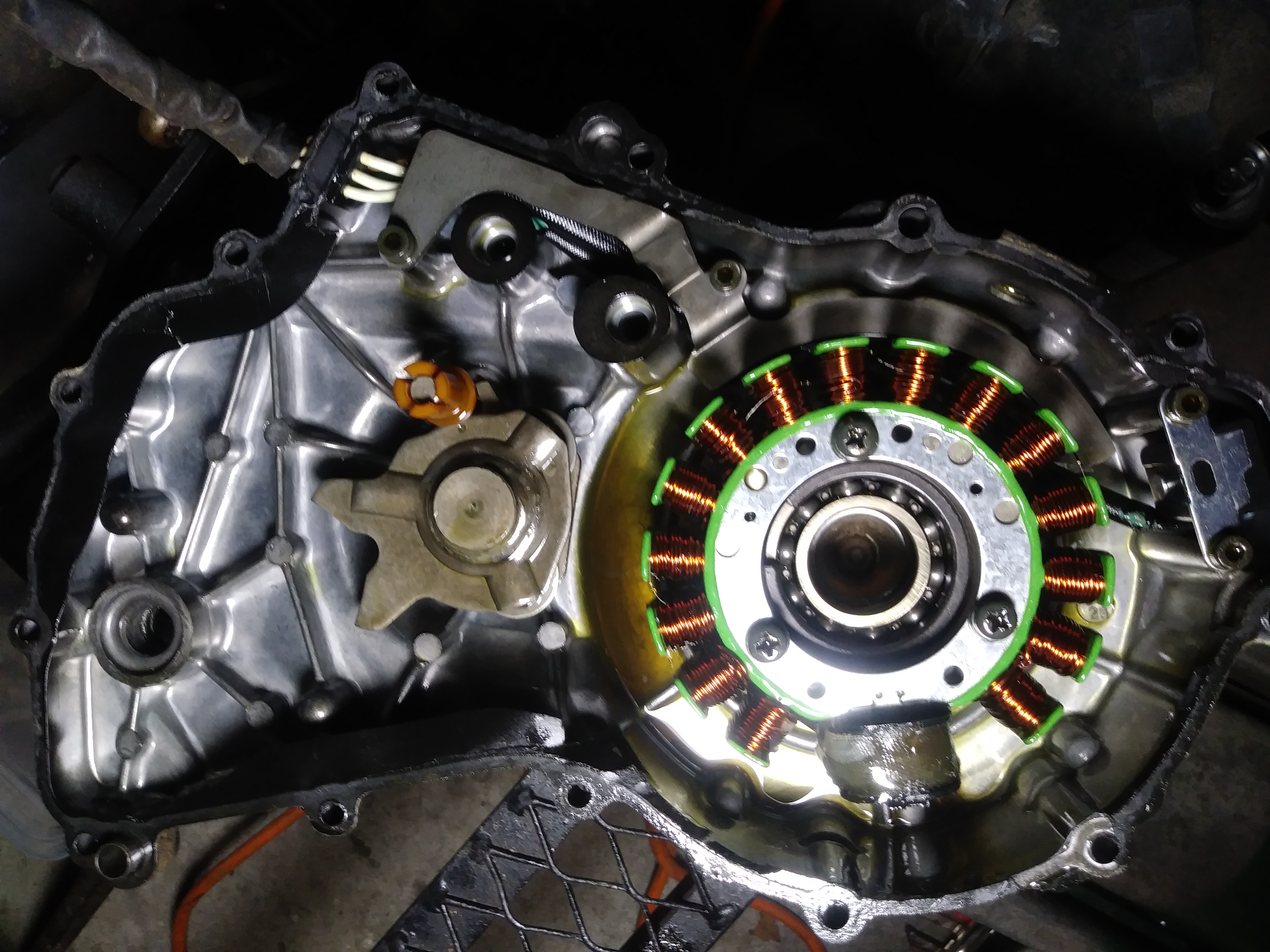

@DirtDemon I am having a similar issue with my 99 Big Bear 350 2wd my stator has three bolts on the inside of the case Phillips head three screws on the outside star bit also has the bearing on the inside of the cover in the middle of the stator I just need to be able to remove the stator so I can replace the source coil still waiting on my service manual to show up  I have attached a picture of my stator
The three screws (Phillips) are the ones holding that coil in place. Nothing else.  You may need an impact driver to listen them up or good size long screw driver that fits them screw heads perfectly. That should’ve been the only times holding that coil in place.
