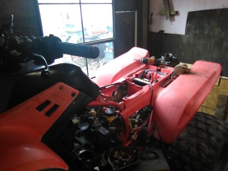

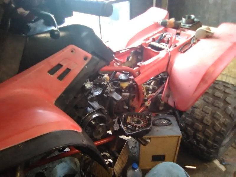

Yes brand new switch un hooked it to see if I got spark and nothing if it's in the on position won't get fire if I shut it off and pull start it fires up but stutters I'm at a loss
Edited by Warrior 350
It sounds like something is back feeding power into the ignition circuit somehow. Maybe an accessory? Plow lights of some sort ? I would get a tester and see what wire gets power at the ignition plug when you turn  the ignition off and trace that back.  Also check the entire harness for damage. Wires get hit all the time or areas where the harness is rubbing against the frame of the bike wear away the tape and insulation. After that i would start checking the stator coil, regulator, and secondary coil with a tester for proper ohms that’s shown in the repair manual. If you are not sure how do do that we can kinda walk you through it or check on YouTube as well it’s very helpful
The new ignition switch is wrong switch. This just happened to me. I bought the cheap $10 one on ebay or amazon. The correct switch should be normally open on both circuits where as the cheap new one I bought is normally open on one circuit and normally closed on the other (which is the way many other atv ignition switches work). One circuit is to turn positive battery power on and off, the other circuit is a ground wire for the CDI. I corrected the issue by connecting the two wires for the CDI circuit. The ignition switch is now only used to turn on and off battery power, it does not kill the engine. The only way to kill the engine now is to use the kill switch.
The only part you need is a OEM ignition switch.
On mine, all I did was hack into the wiring thats part of the faulty ignition switch, I did not hack into the atv wiring harness
If you are really good with switches, you can try to disassemble and clean the switch, usually its just the contacts that get corroded or dirty. My switch showed 150 ohms of resistance on the cdi side when it should be under 1 ohm
Or if you want to be getto, you could use two seperate switches. Use the old switch if it still has a one good circuit and the new switch for the other circuit
Ya I had my buddy test everything else on it and put the cdi on his and his didn't have any spark either so figured it was shot his works and I get spark but he rides his often so can't take his lol
Do you have a multimeter? measure resistance on main switch, black to black/red, and red to brown. Both should have continuity when switch is on and no continuity when switch is off
Ok got it running but issue is the reverse and neutral light are on at the same time and when I try to put it in reverse it dies and no reverse at all on it got a spare motor I was going to swap but wanted some input first
My guess is there is a problem  between the reverse switch that  turns on your reverse  light  and the  neutral  safety switch. I think you might find that  light grounding through the  neutral  safety  switch  and  killing the  engine. I would  look for  the  wires  shorted  or possibly  misconnected.
